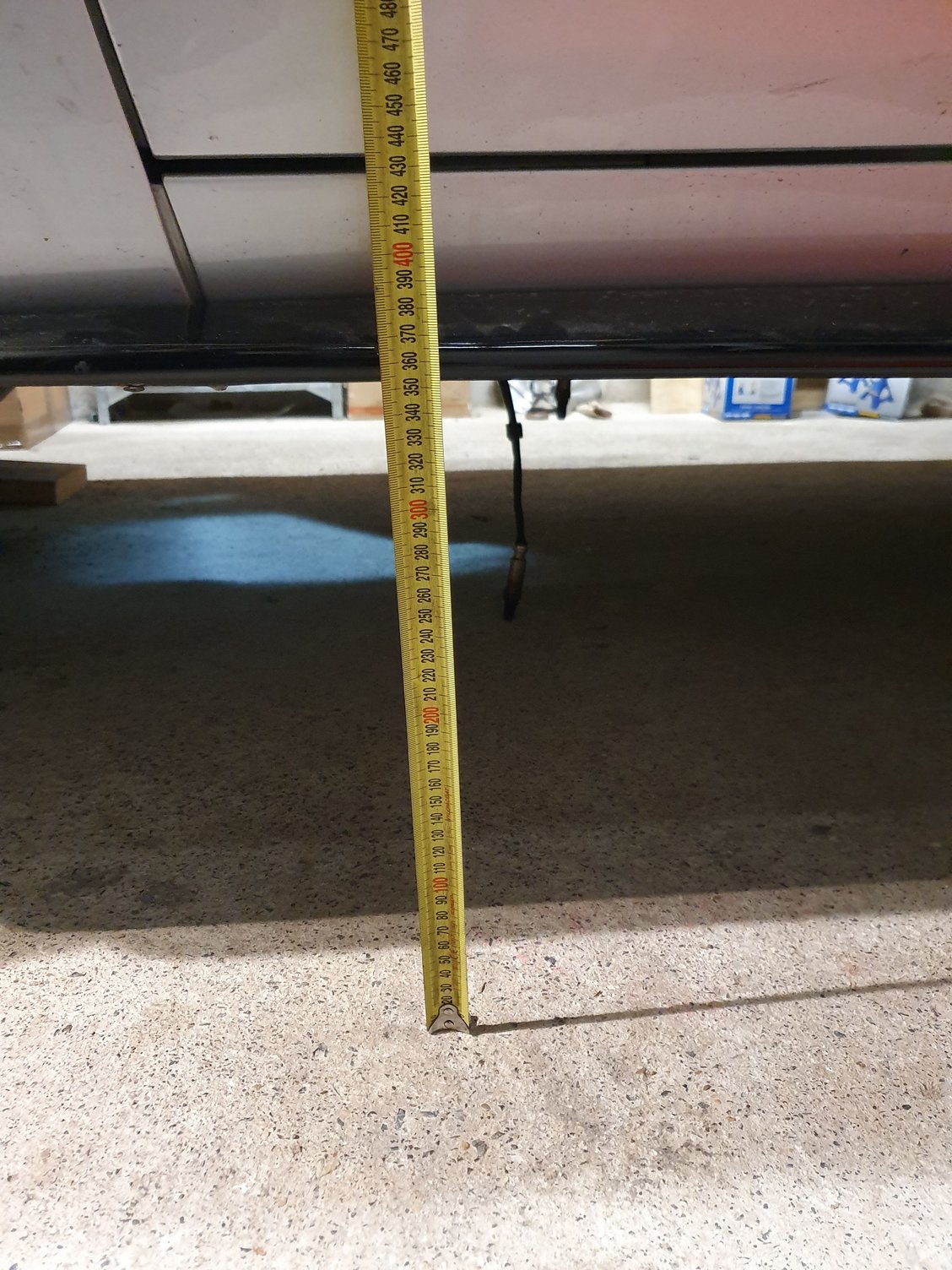

height as per attached photo, so more than 10 inches off the ground. I havent tried the passenger side again yet (its currently after 10pm and Im about a bottle and a half of wine down so not ideal to go tinkering on the car again till morning)
So looks like high enough.
drivers side, she aint going in.
it either contacts badly around the oil filter, or gets caught up on the upper alternator mount (alternator also removed - I forgot to mention that I think)

Interesting, it sounds like you’ve got everything in order to get them installed then (besides removing spark plugs). My recommendation is try again from underneath. It’s all about finding that magic angle/position to get them to slide in. Trust me, they’ll go in! Don’t be afraid to be a little rough, you’re not gonna hurt the headers.
Definitely sober up before tackling the job. You’ve gotta be in one piece to take the your little girl for a spin! Best of luck with the install, you’ll figure it out

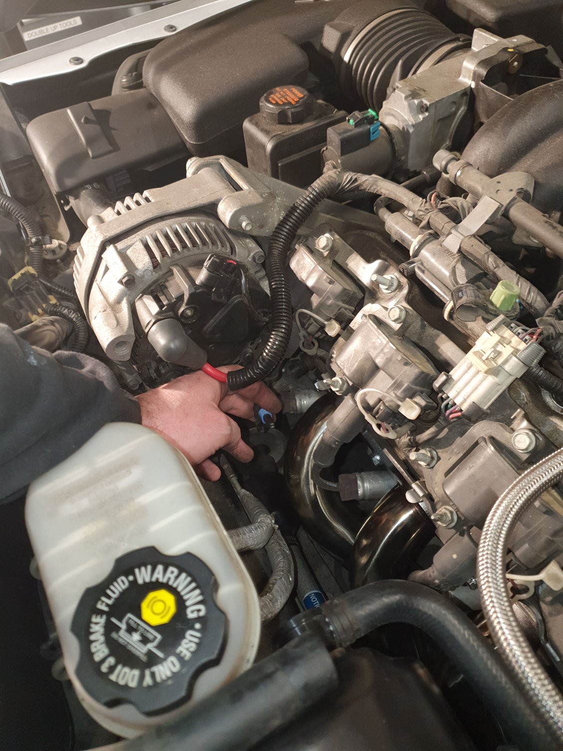

There is one plug sort of just below the alternator that doesnt seem to go anywhere. I dont remember undoing it though, so Im not sure if that matters for something?

forgot a picture of the plug I was referring to

I figured out where that wee plug goes, the other half to it is kinda damaged which is why I missed it, so it also doesnt 'click' into place, so Ill figure out some kinda zip tie method to hold it in place.
It did not solve the problem though.
on a hunch I checked the fuses, and found a 20a fuse had blown. replaced that and all was back to normal!

Nice! The little sensor on the front of the head behind the alternator you’re referring to is the engine coolant temp sensor. I replaced mine while I had everything apart, but it’s not necessary. Sounds like you accidentally hit it with the header when you were trying to get it installed.
