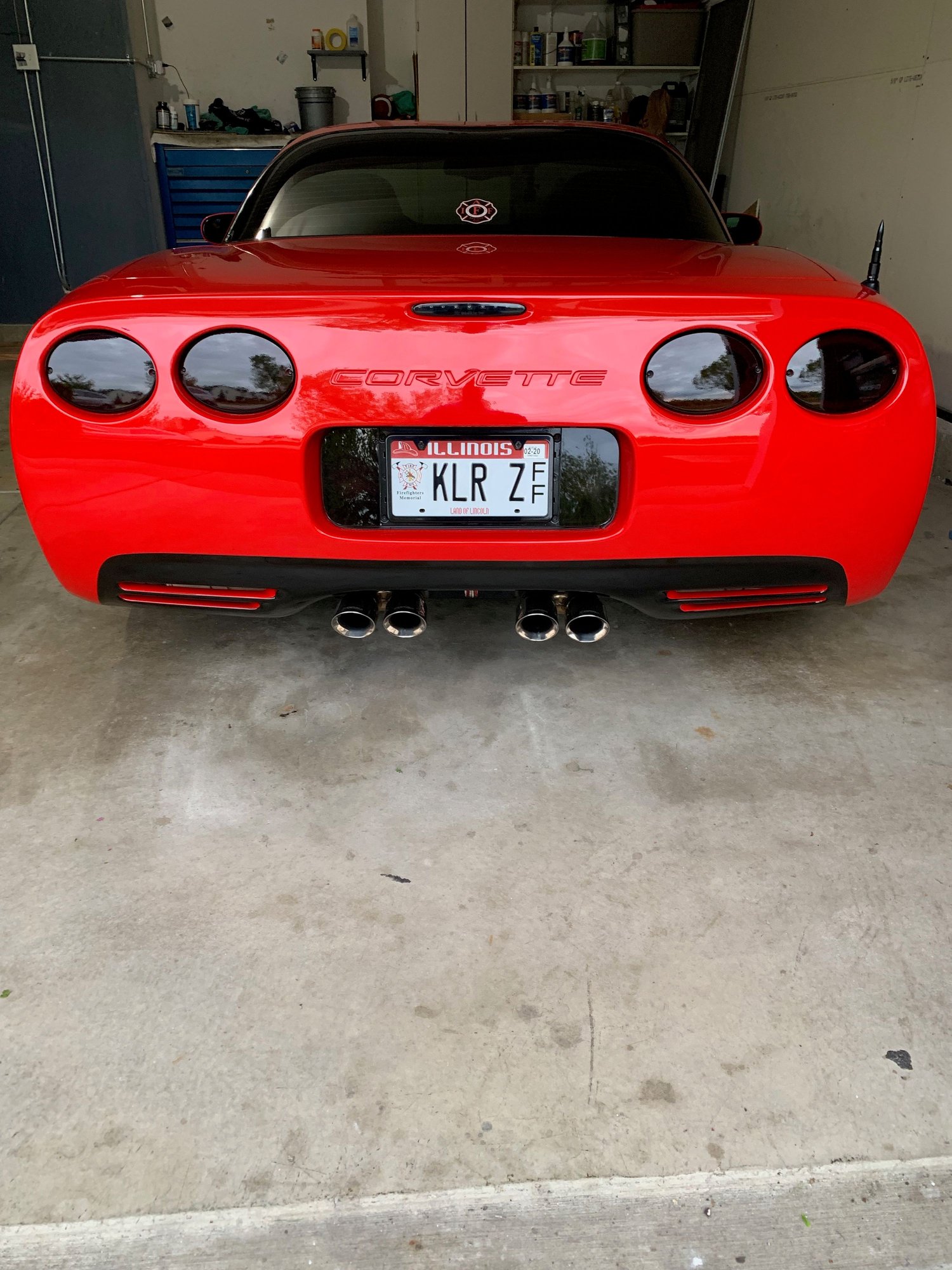

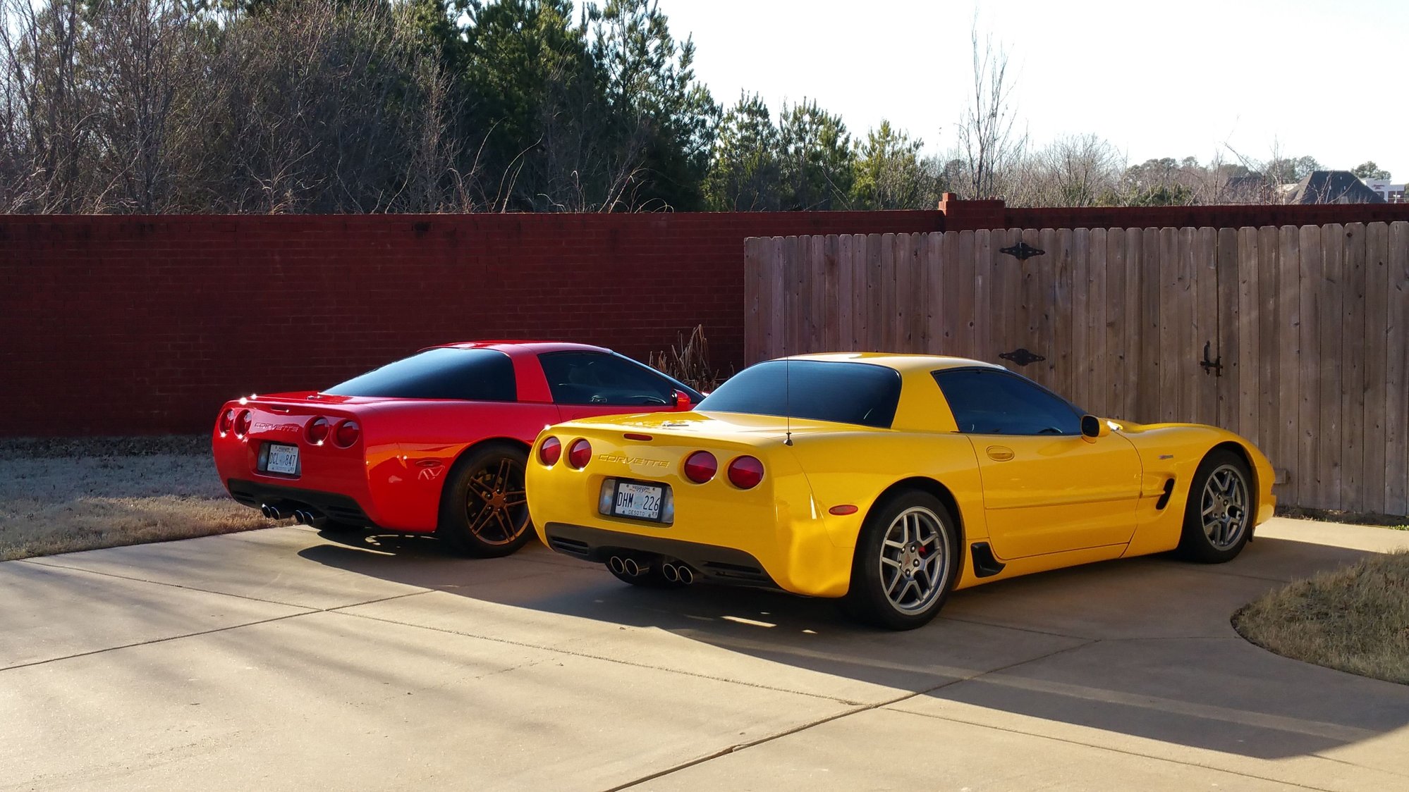

I did both of mine, the yellow one flat and the red one gloss. I think I like the flat better.

I did mine flat and I loved it. Very subtle but greatly improved the appearance.

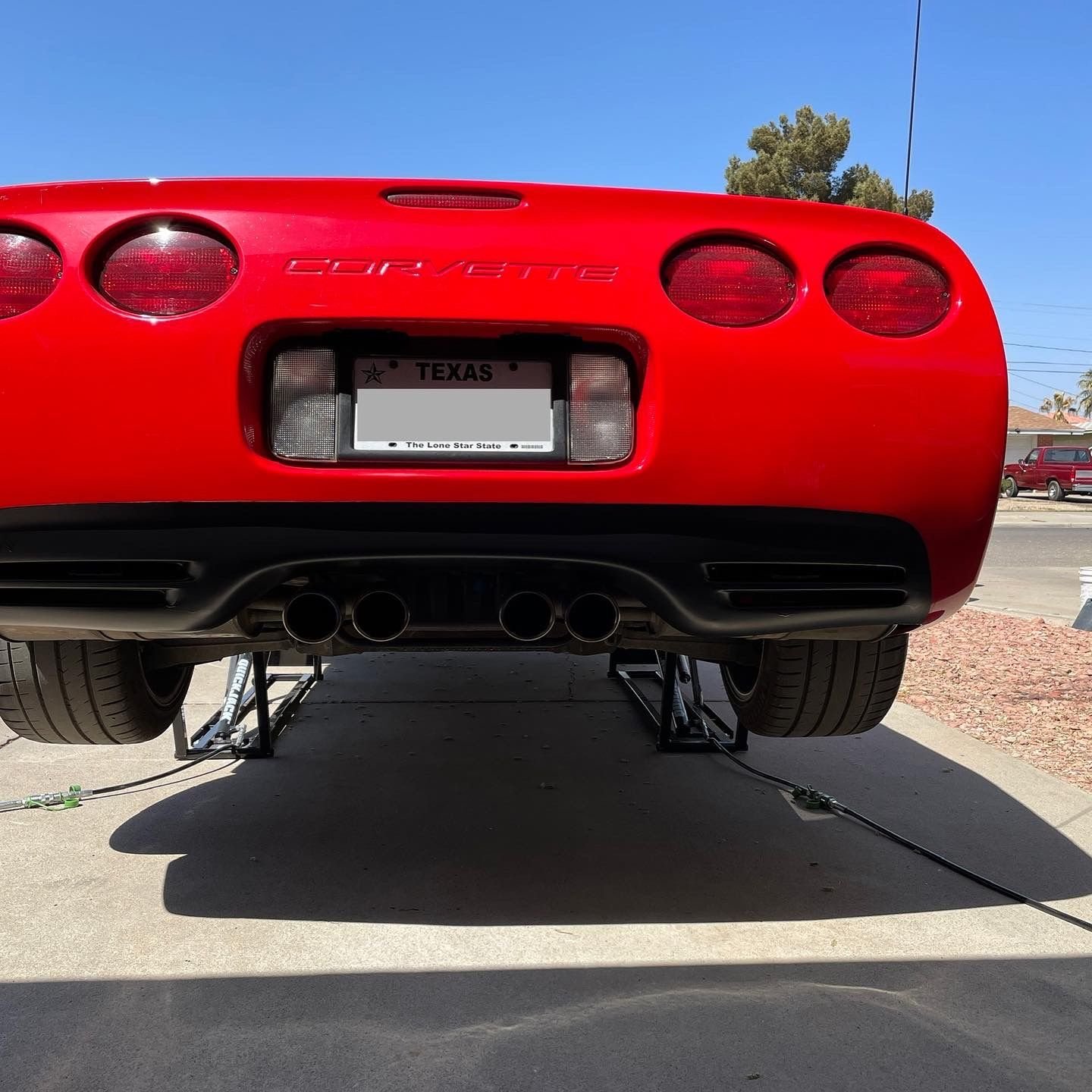

I just did this a couple of months ago and used about half a can. Did three coats of matte black Plasti-dip.

Yeah, tip: Plastidip works best in LAYERS. Three coats isn't going to cut it. Use the entire can. That will make it significantly easier to remove later, should you want to.
Also, knifeless tape would give you better, cleaner lines. I dipped my wheels and used one whole can per wheel and half a can of glossifier on top of the base. When I removed it last week, it peeled off in one giant sheet with no drama. It was on the car for 6 months in the Florida sun.

Surface prep is pretty simple, wash and wipe down with alcohol. I used 1/4” precision masking tape and followed the curve carefully, then used painters tape to attach plastic sheets to my car. The 1/4” tape peeled off nice and clean.
You can’t go wrong with using a whole can, so let ‘er rip.
