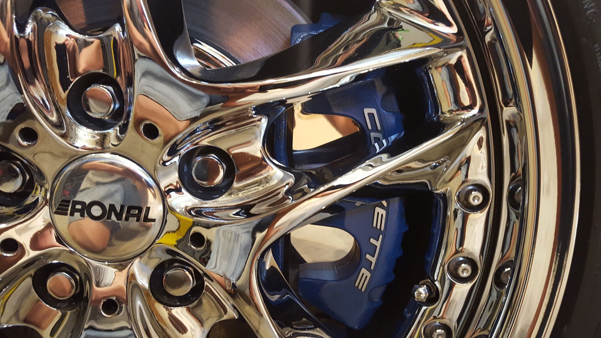

Do it yourself. 10 bucks. Buy the color of caliper paint you want at O'Reillys or Auto Zone.
Leave the calipers on.
Put the car on jack stands, take off the wheels, clean the calipers with hot water and Dawn and let them dry. Cover the rotors and fenders so over spray won't get where you don't want it and spray the calipers once and let them dry. Then give them a second coat.
I did mine about a year and a half ago and they still look great!
It took a day and a half for to do it all. Most of that was taping the rotors and fenders and drying time.
I painted over the Corvette logo and simply put some sandpaper on a wood block and sanded it and the logo stands out real good.
$10 bucks for Caliper paint! I still have a half can left!
Sure makes a difference in looks!
