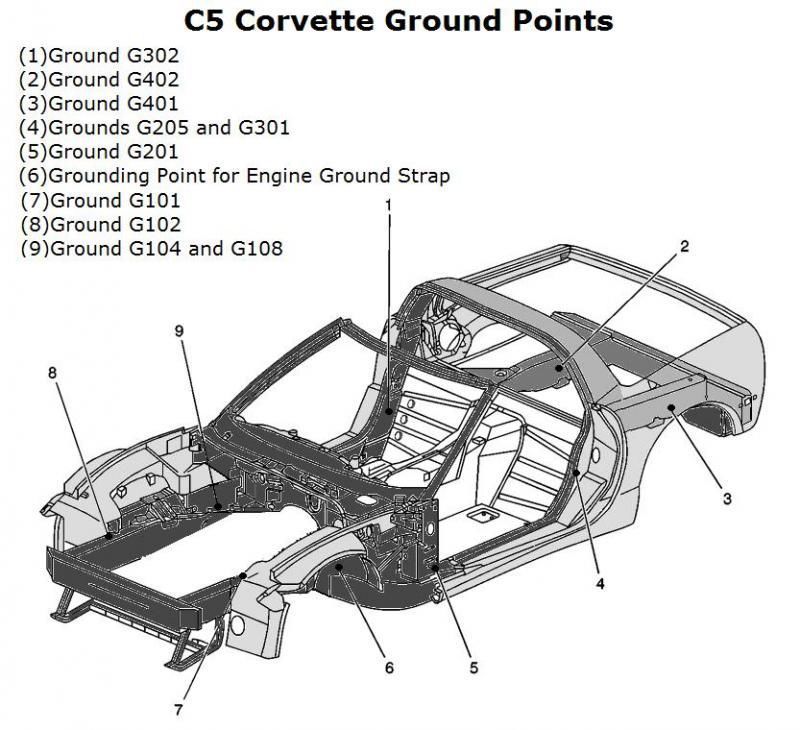

Must be a coincidence that its happened right after working on it? I figure it can only be either a bad earth, or something in the battery itself has a loose connection. ANyone else encountered this? where do I look for the earth connections to check they arent corroded or degraded in some way?

I thought Id read elsewhere that the C5 had a tendency to have bad earth connections, so if anyone knows where the main earth connections are, I will have a look at those too

Originally Posted by tigertim20
thanks for the idea, Ill do that!
File Type: pdf
File Type: pdf
