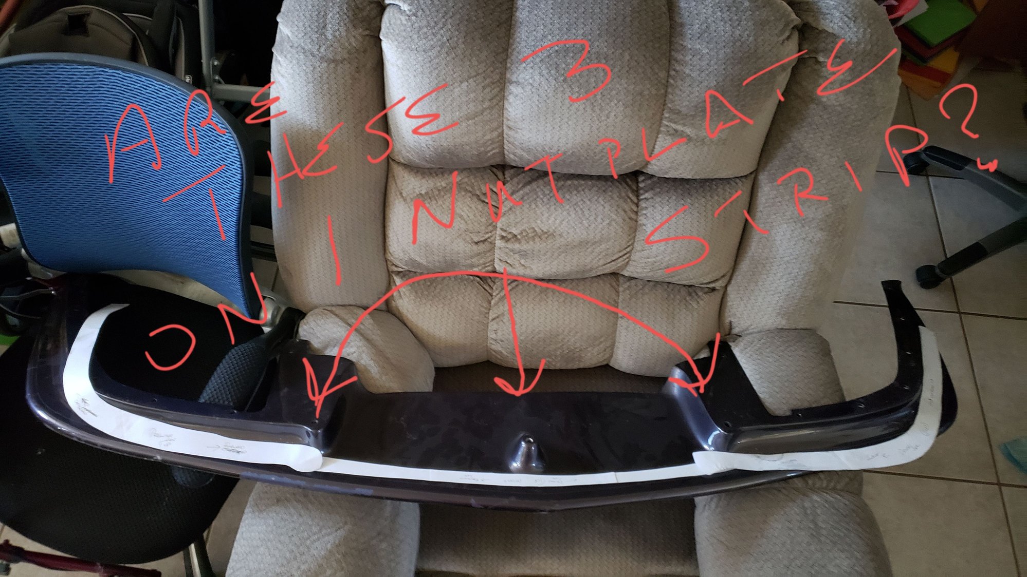

I have an ACI front splitter on my car and I was wondering how the nutplate strips look? I made a few templates to make my own but need to know if the middle mount bolt is tied in with the 2 mount bolts on either side of that bolt. When I bought this splitter it didn't come with the nut plate strips that need to go on the inside of the front bumper cover so I used wide fender washers and nuts. I took mine off yesterday to get it repainted so I thought it would be a good time to make them so it will be easier to take off next time if/when it needs it again.
Also, if anyone has a part number for the right ones I'd love to see how much they are. If they are available and reasonably priced I may just buy them instead.

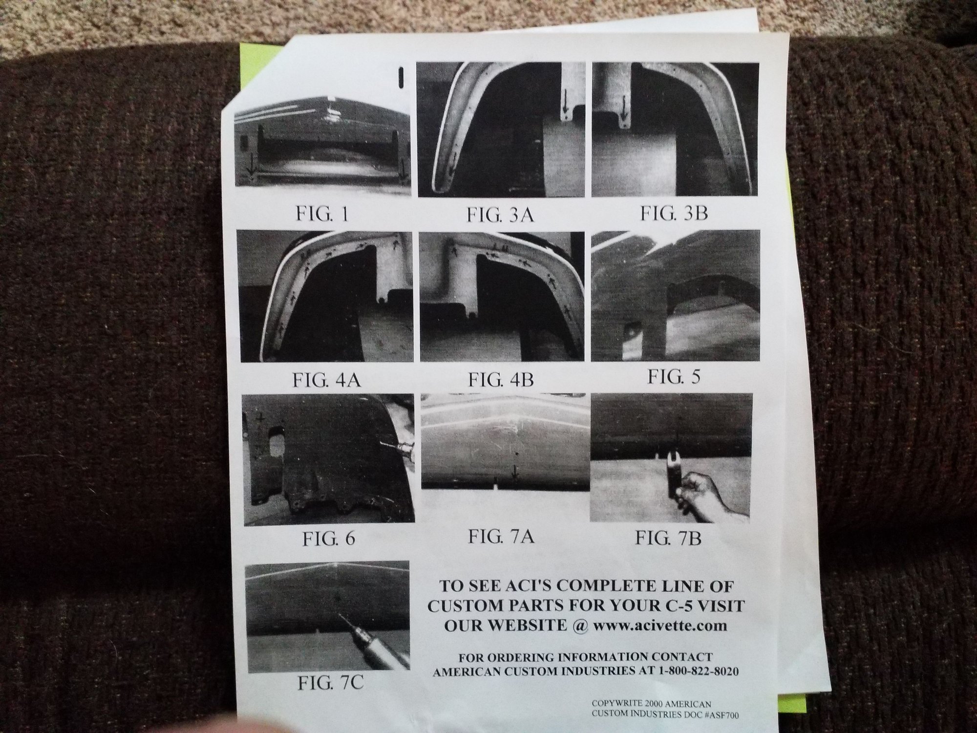

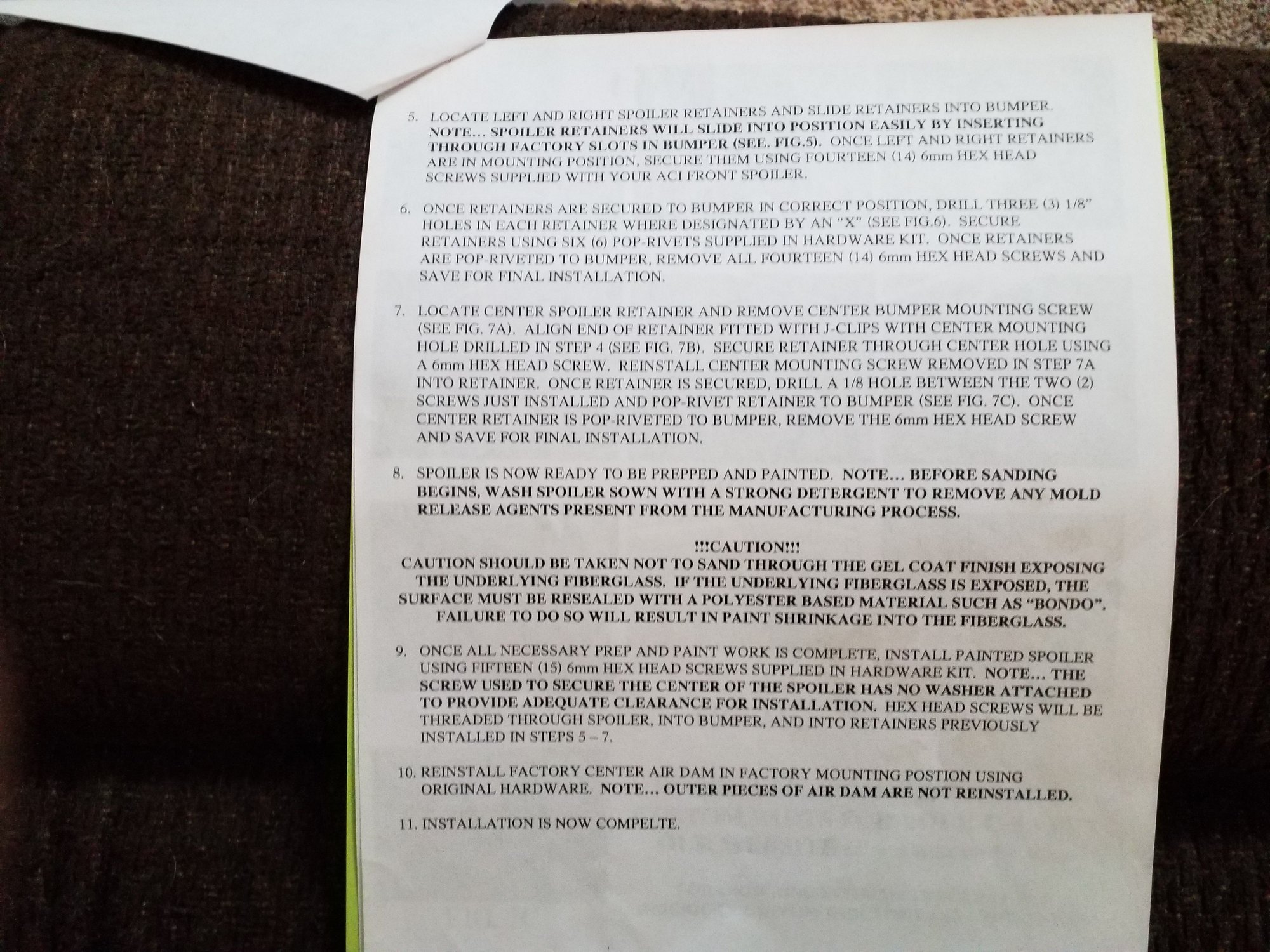

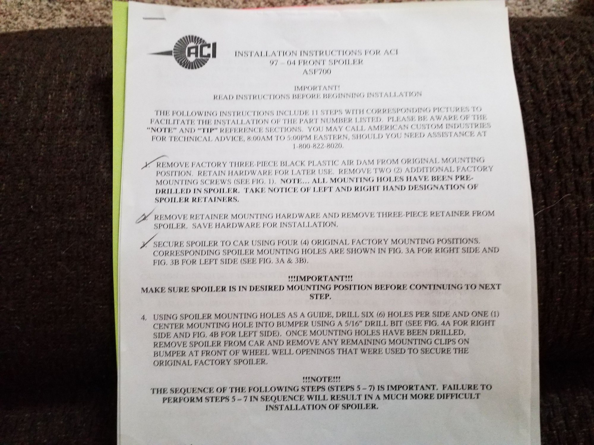

Maybe these will help.
Cheers, Matt

Thanks, that helps a great deal and it looks like the center bolt is on a nut plate by itself. By chance does that paperwork have a part number list for the original parts needed to install it in case someone would need them?

Originally Posted by mstromquist
Thanks, that helps a great deal and it looks like the center bolt is on a nut plate by itself. By chance does that paperwork have any part numbers for the original parts needed to install it in case someone would need them?
Unfortunately, it does not. The folks at ACI were very helpful for me. I would call them directly. The plates come with speed nuts and bolts and are included with the spoiler.

I’ve had the spoiler installed for quite a few years now but have never had the mounting hardware. I had it installed with nuts and wide area washers. Just wanted the removal/installation to be easier next time so I don’t have to stick my arm into the bumper cover anymore.
