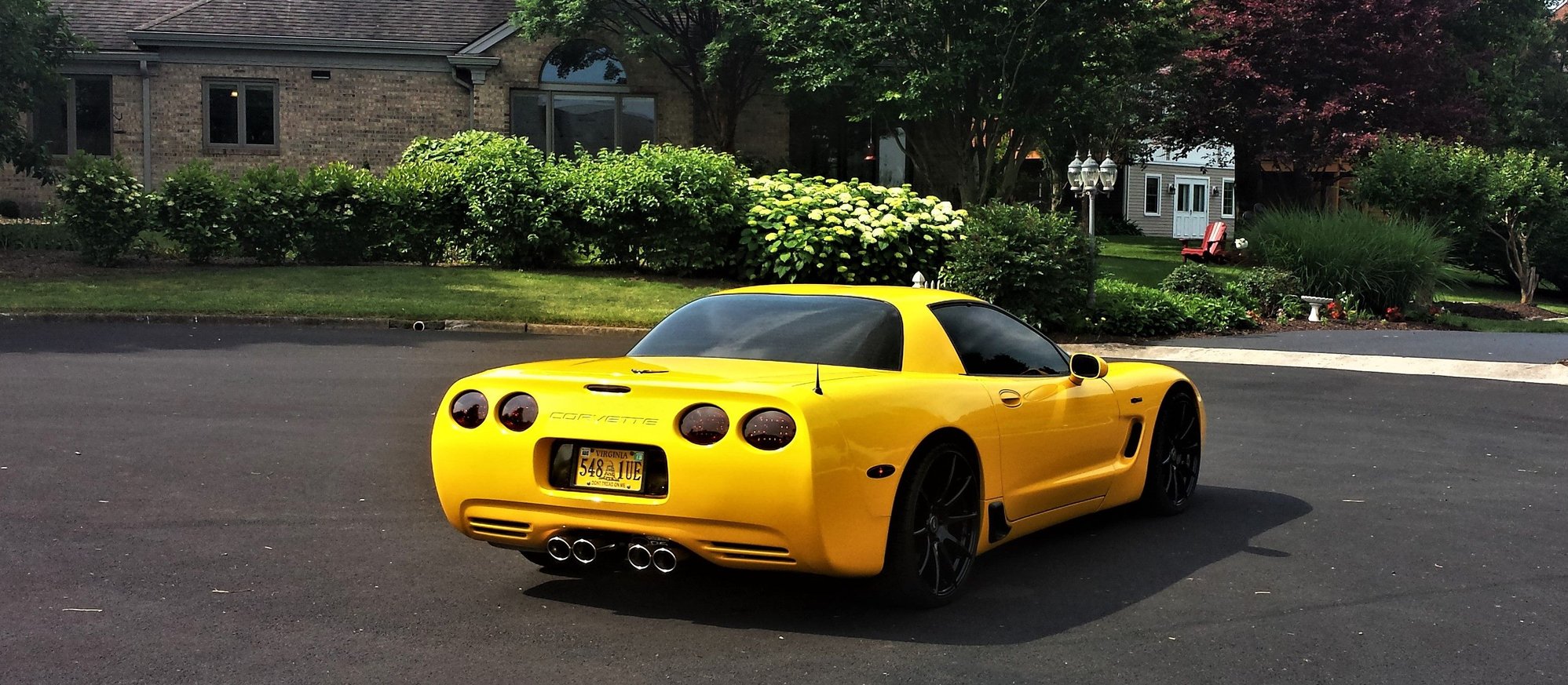

Mine are 19" front 275/30/19 and 20" rear with 305/25/20 tires. I would probably go with 19s at all 4 corners if doing again. Here are some pics:

Thank you for the pictures. Your car looks awesome. Love the look of the rims. What offset did you go with? Any issues with rubbing or full wheel turn?

Thanks, much appreciated. No issues with rubbing or fitment. The fronts are 19X9 and the rears are 20X11. The off-set is not marked on the wheels, they were just marketed with "C5 Flush fit". Yes, the front
is semi and deep for the back. I don't notice the difference visually though.
