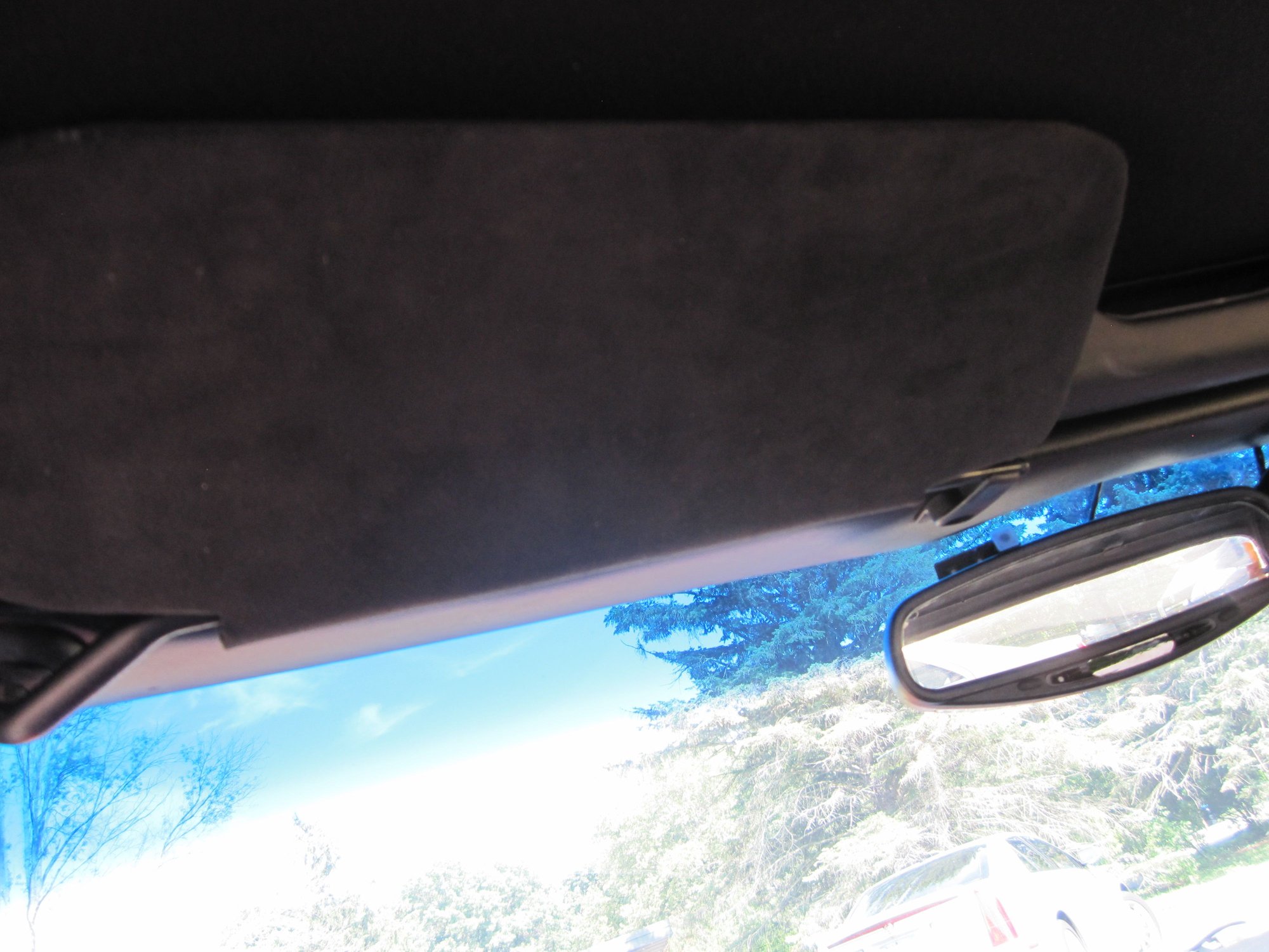

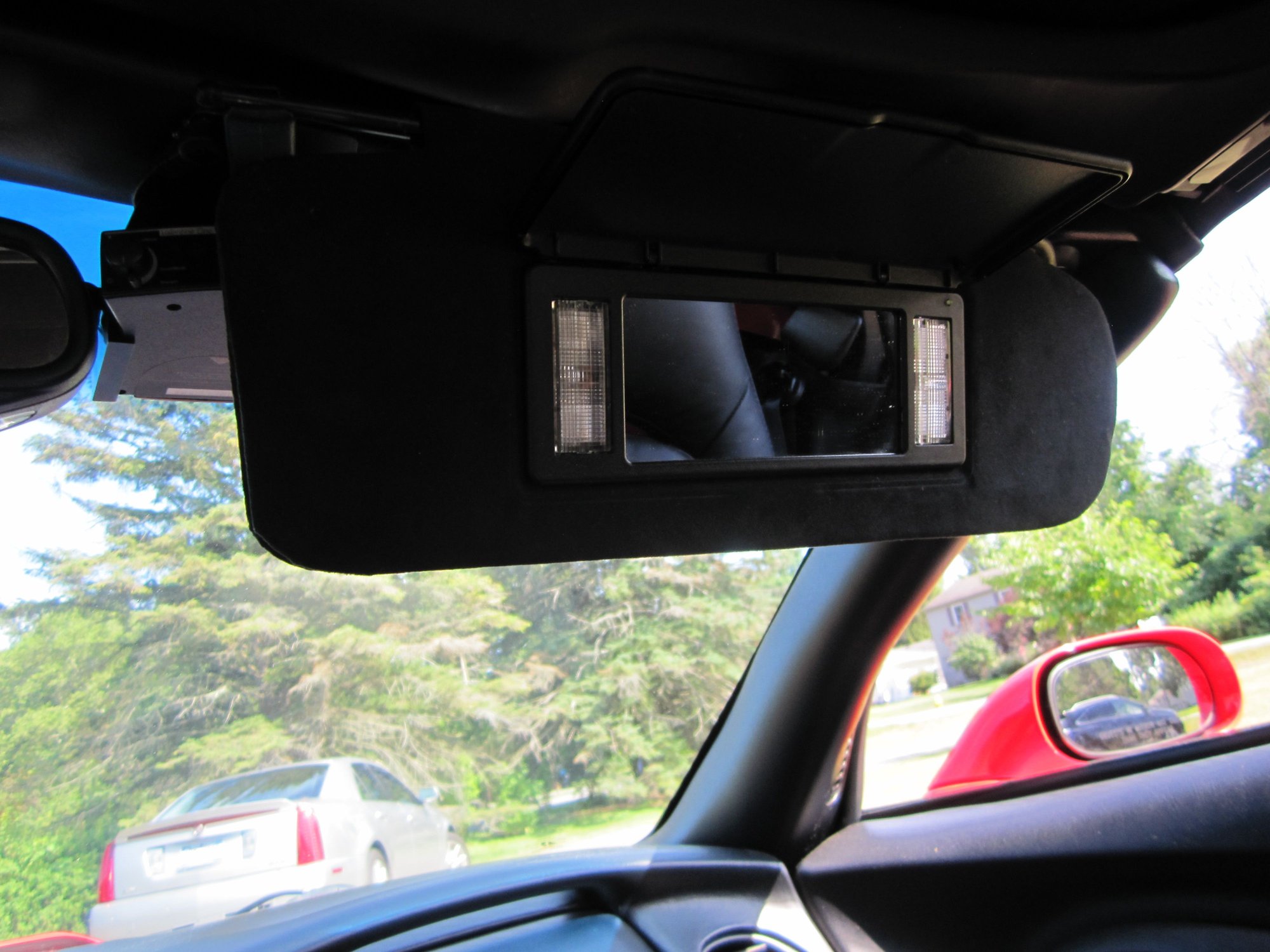

Both sunvisors had lost their shape, needed new covering and the drivers side needed a new masonite core; a new core was made using the old one as a template. The cores are now sealed against humidity unlike the originals and the new one is strenghtened with glass cloth/resin on both sides. Instead of thick paper and thin covering material, thin lexan was substituted for the paper on both sides with 1/8" thick foam added over that. Black Alcantera was used as the outside covering over the foam for a total thickness of about 1/2". The old bulb sockets were replaced with leds.
Passenger side down.
Drivers side up
