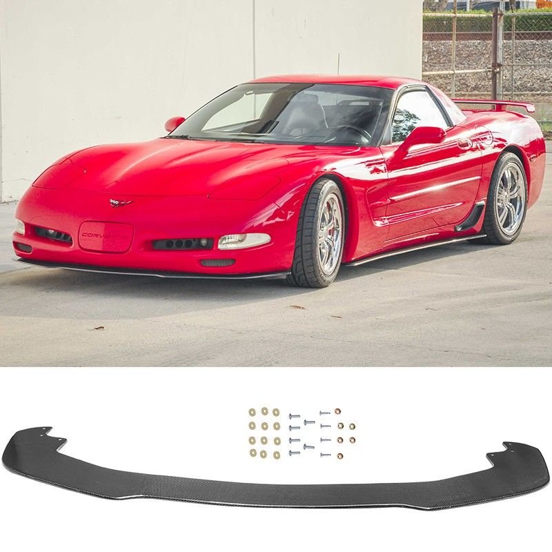

I'm working on a custom made one myself - its a pass through design by being a flat 1/4" that is gaped about 1"+ down from the front bumper nose tip. Using some 3" long bolts to make it adjustable. Its not as effective at generating down force however since it is a pass through style, its more like a wing than a splitter in function.
It is based on this one by Ikon (it is discontinued)
