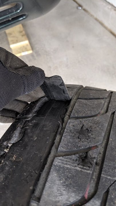

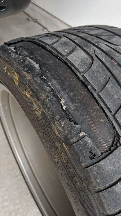

Tire date codes exist for a reason:
This happened at 80 mph on I-40 in the middle of nowhere 120 miles from home. I bought my '00 in April of 2018 at 46k miles. Had these Firestones on it that were at least 75%. Date codes said 36th week of 2007. Since then, I have driven it across the country 4 times and done a dozen laps on my local track. Have put 18k miles on it. Thought they would be fine. Looked perfect, no cracking, no leaks, good grip. Didn't matter - old tires are old tires. They should be replaced. Fortunately, the inner structure of the tire held together and no damage was done other than the disappointment of my wife while we waited 2 hrs on the side of the interstate. The wallet damage consisted of a $500 tow bill and four new Conti DWS.
Moral: Garage queen C5s are great performance bargains, but old tires are a gamble. Just replace them.

A couple more shots of the aftermath to drive the point home:

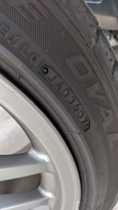

Date code. Just in case someone is wondering what to look for. First two numbers are week, second two are year.

Generally, the tire manufactures provide a recommendation. Usually it is around 6 years from date of manufacture.
