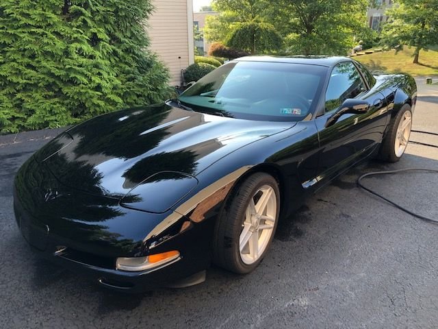

I finally completed the purchase of a 2000 FRC, Black on Black today. The sale had been in the works for a few weeks as my schedule would not allow me to go get the car until this weekend. I flew into Pittsburgh this morning and the owner (a forum member) picked me up at the airport. The car is everything I thought it would be. After a couple hours of running around getting titles notarized and all that, I jumped in the car and drove it home to KY. 6 hours later she is all washed up and put away in the garage.
I noticed a few things on the drive home that I'd like a little feedback on. I know many of you will tell me to do a search. I've been up since 4 AM and the searches won't happen tonight! If you want to give me the info, that'd be great, if not I'll search it another day. So here's what I noticed:
BTW: The car is extremely clean and well cared for, 31,800 miles, Corsa cat back exhaust, Widebody fenders on the rear, and 2008 Z06 wheels. Thats about it for mods. The stock wheels and fenders came with the deal.
1. A/C comes on, blows cold, all fan speeds work. The switch to select where the air comes out does not work. I know the temp controls in these cars are a common issue. Are they still available? Can you use one of the 02-up versions with dual controls? I've seen a 2000 with those controls and didn't know if it was an option then?
2. The cigarette lighter does not appear to have power, tried to charge my phone and it did not show that it was charging. The power outlet in the center console does not appear to work either. I tried with and without the car running. I thought I saw some threads on this being a common issue. I assume it's repairable?
3. I noticed after I had gotten off the Interstate that when I'm at a light I can really feel the engine vibration through the tunnel and in the bottom of the drivers seat, is this normal for these cars or is that an indication of a worn or loose mount somewhere?
For the record, I'm real happy with the car and the price I got it for. It's a 20 year old car, I didn't expect it to be new but I would like to get these little things corrected.
And last but not least, PICTURES!
