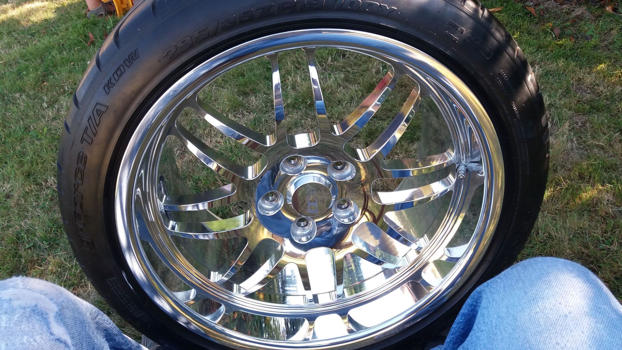

Timely info for me, just polished my CCW wheels and wouldn't you know it.... one of the sensors died.
Those look HOT! PM how you got them to look like chrome
