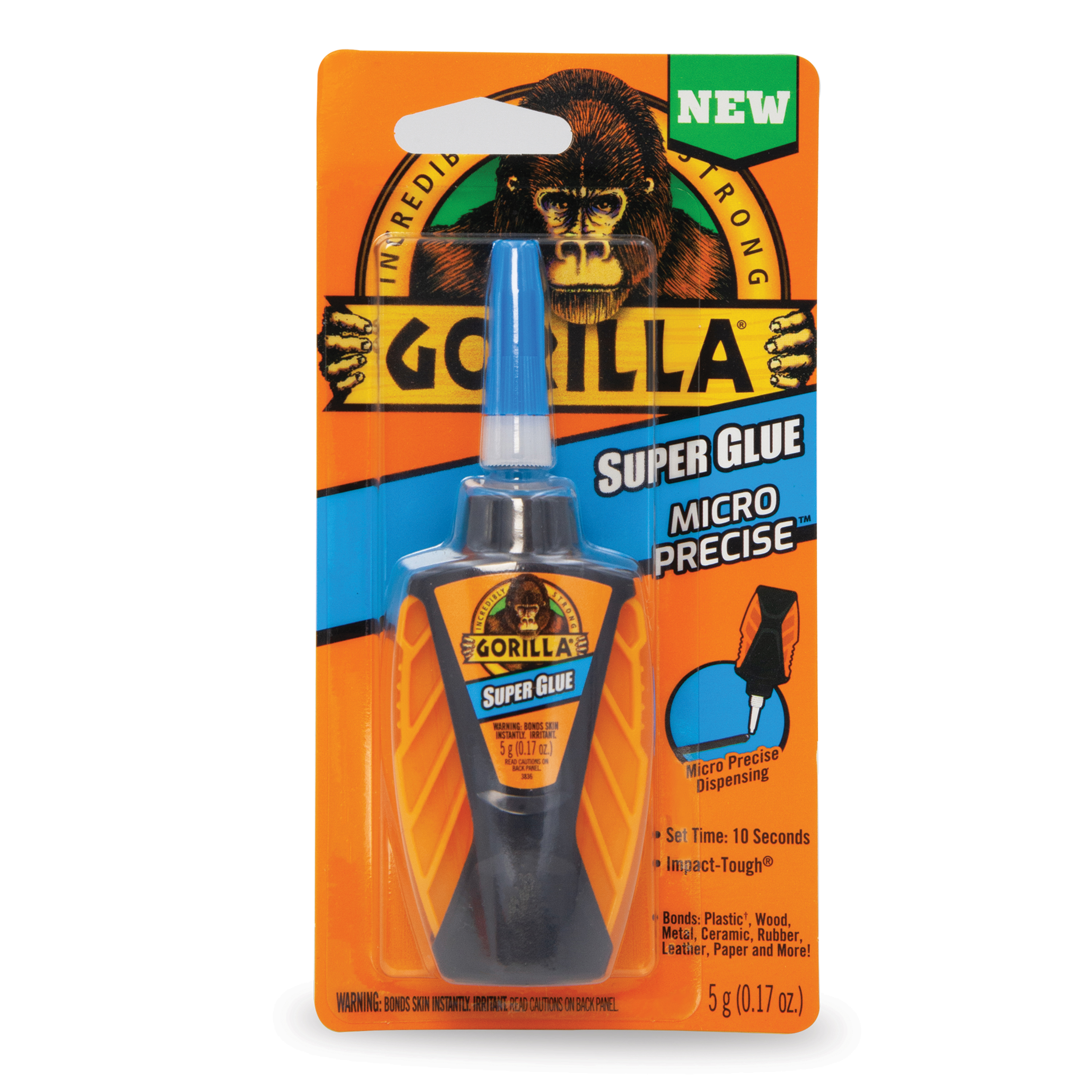

Old Aug 22, 2019 | 03:46 PM

Thank you for the tip on the gorilla super glue. Doing more research and have seen a couple of past OP's where liquid super glue dripped on the face of the gauge while trying to put the bezel in place. Looks like gel glue is the way to go. I'll be extra cautious to avoid drips from happening and turning one PIA project into a bigger project.
