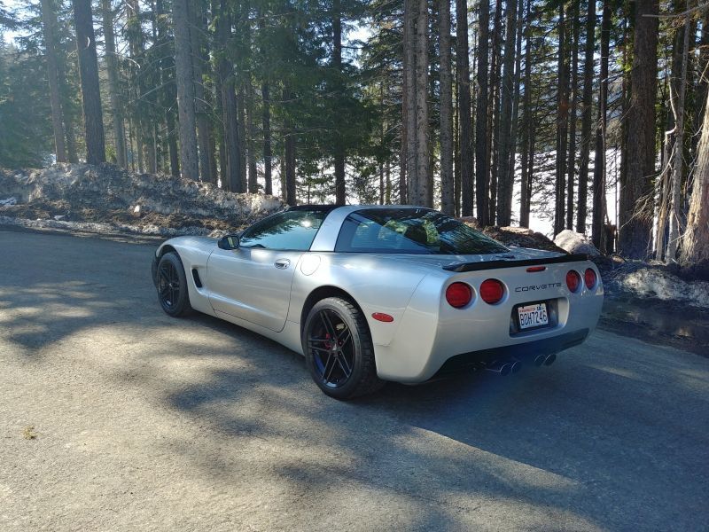

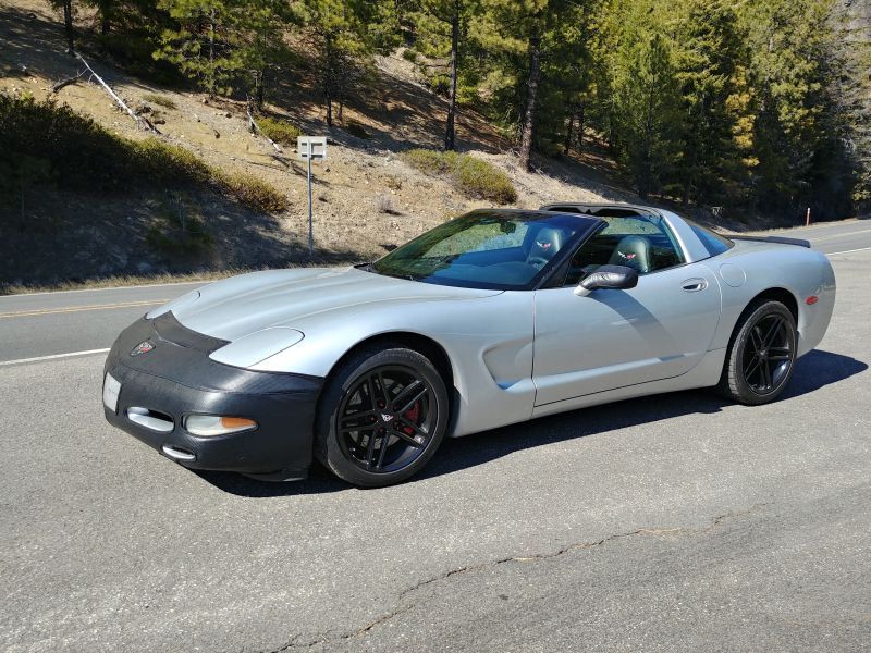

I figured I would start a build thread to get input and advice as much as anything while having it all in one location, if this should have been in the tech section please relocate. I am calling this car 'Mayhem', I call my 944 Turbo 'Crisis' and my 1947 Chevy Fleetmaster was known as 'Whiplash' in my hometown, it was my first car and I still have it, but it needs some TLC and is on the agenda for next summer. It is all in fun and I don't take any of it serious, no matter what you do there is always someone meaner or faster. We have a 9.2 second 1/4 mile Nissan GTR here in town that might be the top of the food chain in street legal daily drives, no illusions of taking that on.
Here is where I am at with my 1997 Sebring Silver Base Coupe:

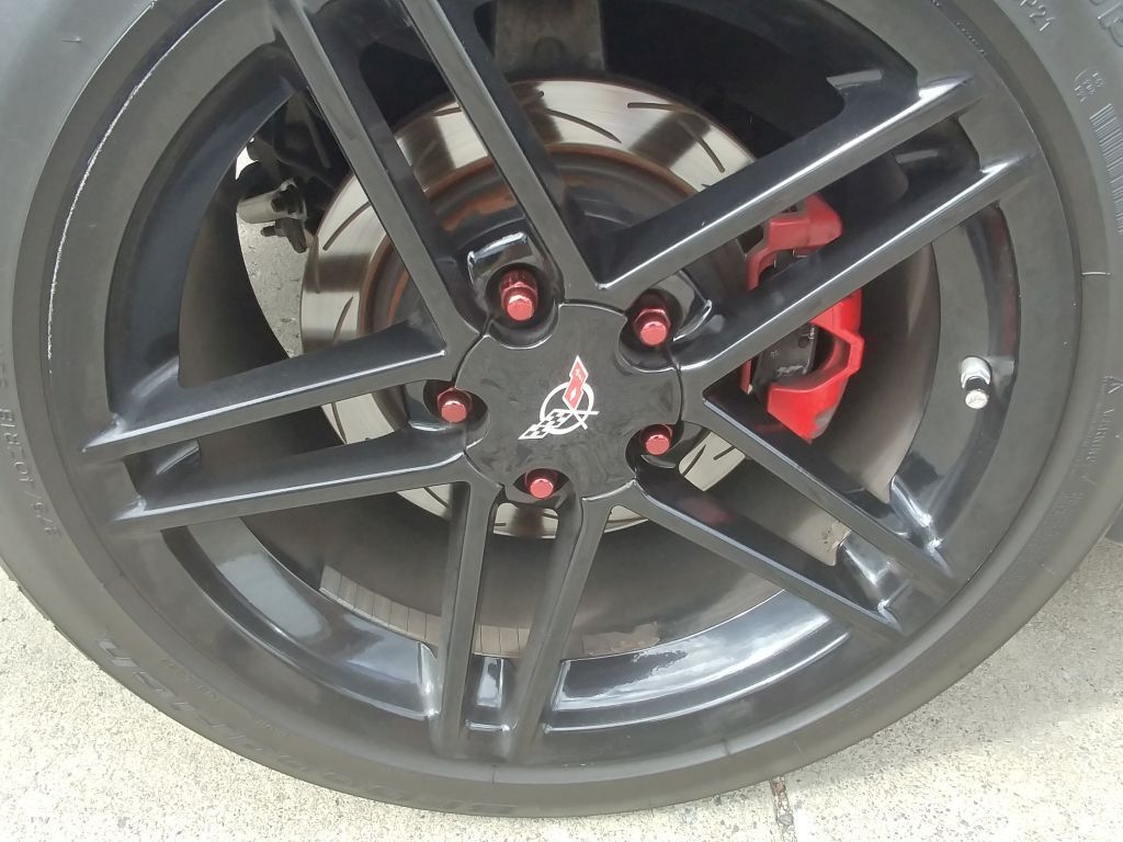

StopTech DBA T3 4000 series slotted rotors and pads
C5 Z06 Brake Calipers

Z06 wheels

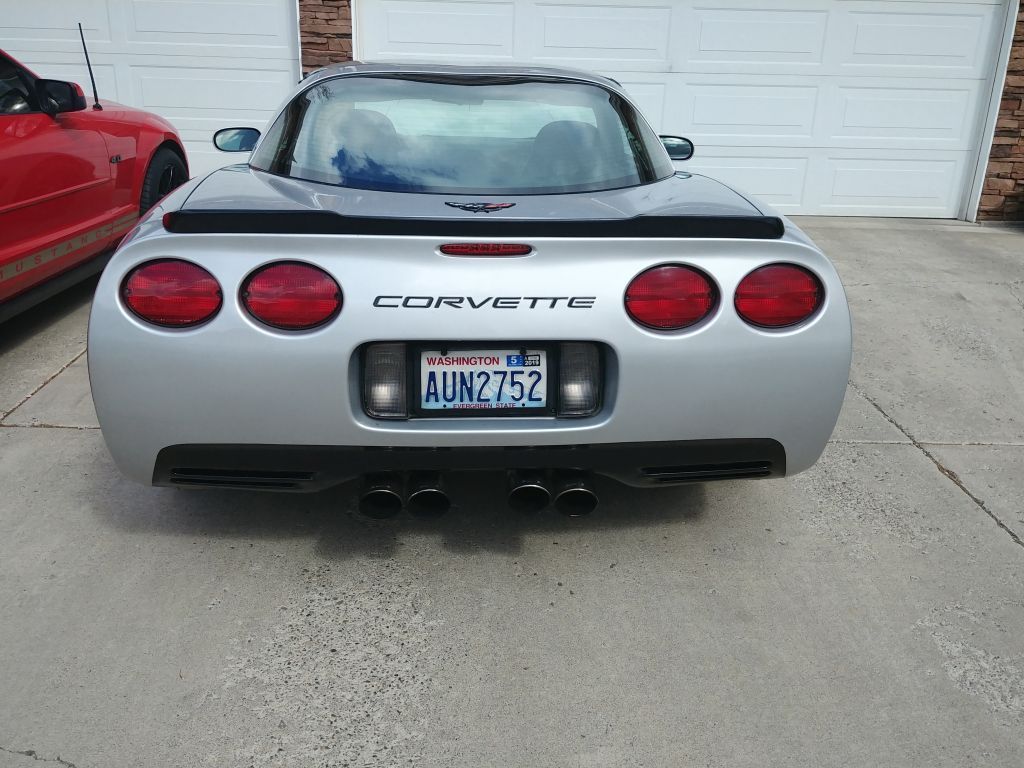

Aesthetically it is a valid opinion and I will dwell on it. However, it is level and already hits curbs, sidewalks and steep driveways so there are valid arguments against.

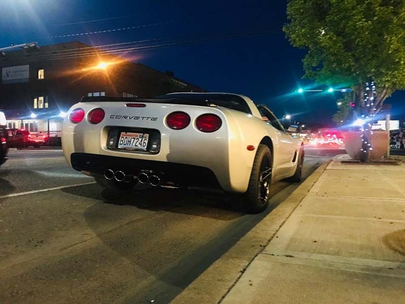

Played hooky with my wife one day and drove up from Yakima to Chinook Pass and then down and back up to White Pass, beatiful drive. Yakima, WA has allowed dragging the Yakima Ave second and third Saturday May thru September and last weekend was the frist one and it was a blast, lots of nice cars, trucks and motorcycles.

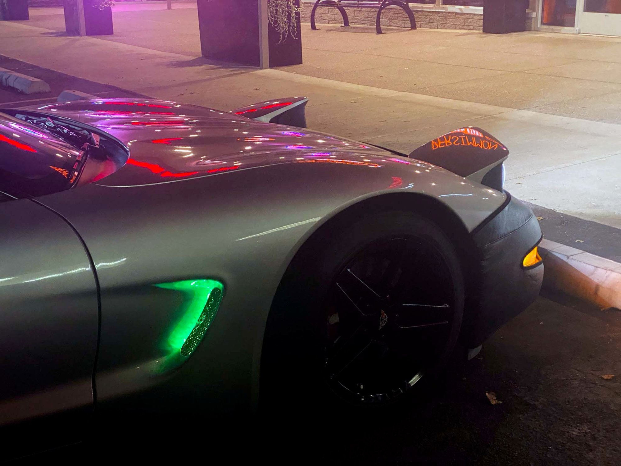

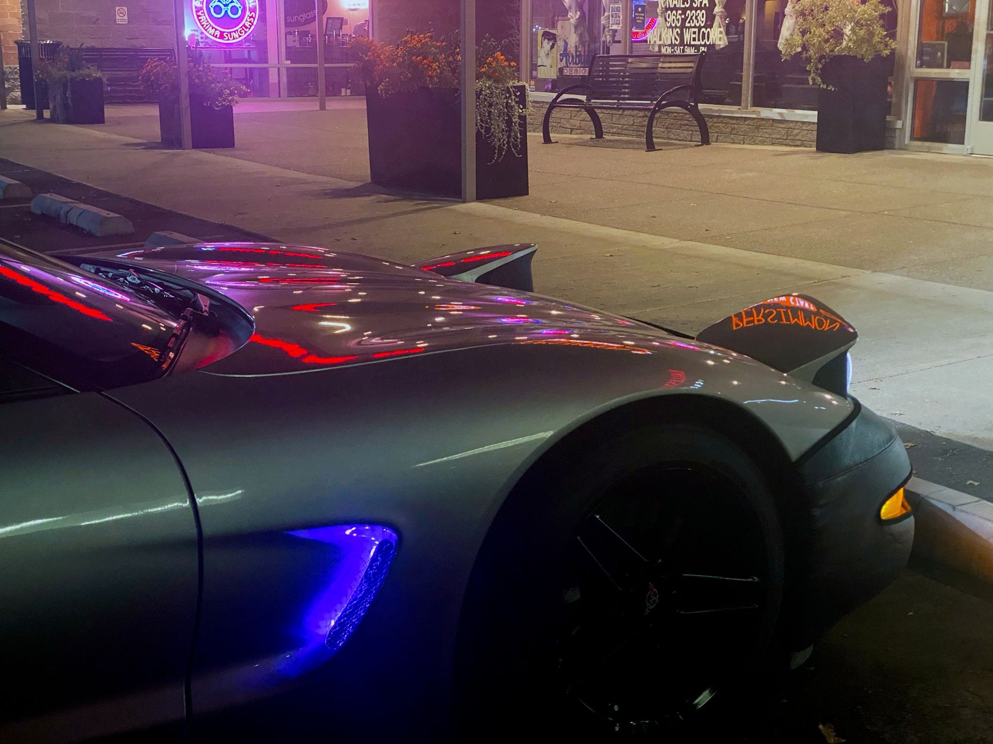

Not really an update to the build, but thought the images my step son took of the cove lighting I added to the doors looked cool. This engine build has to wait until the Porsche is done and life has just been too busy hoping to be able to jump on that soon now that we are done with stepdaughters wedding, etc.. But always something like grandkids Gridkids and Soccer on weekends.......
