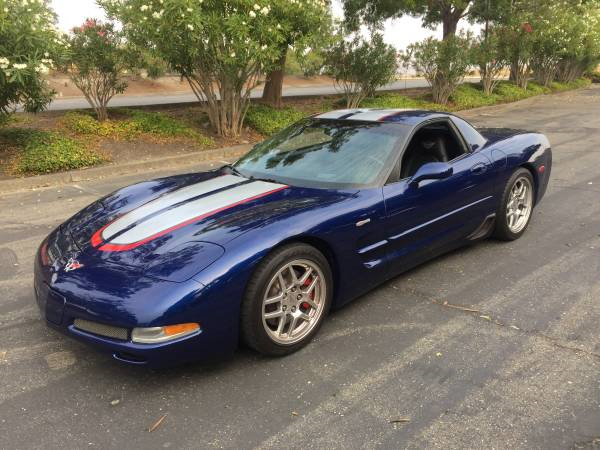

So I have an 04 Z06 with 11K on it. Great car. But, previous owner put on Poly Urethane Bushings. Car creaks like crazy. Sounds like its a 100000 miles old. Brought it to dealer and said, how do we get rid of the creak? He said, put stock rubber bushings back on it. I said, will it handle as well as it does now. He said (direct quote here) "**** no".
So, to all you experts out there, help. What if anything can I do to keep the handling and lose the creak. He tried to lube them but that didn't really work. Any help really appreciated. Thanks all,
