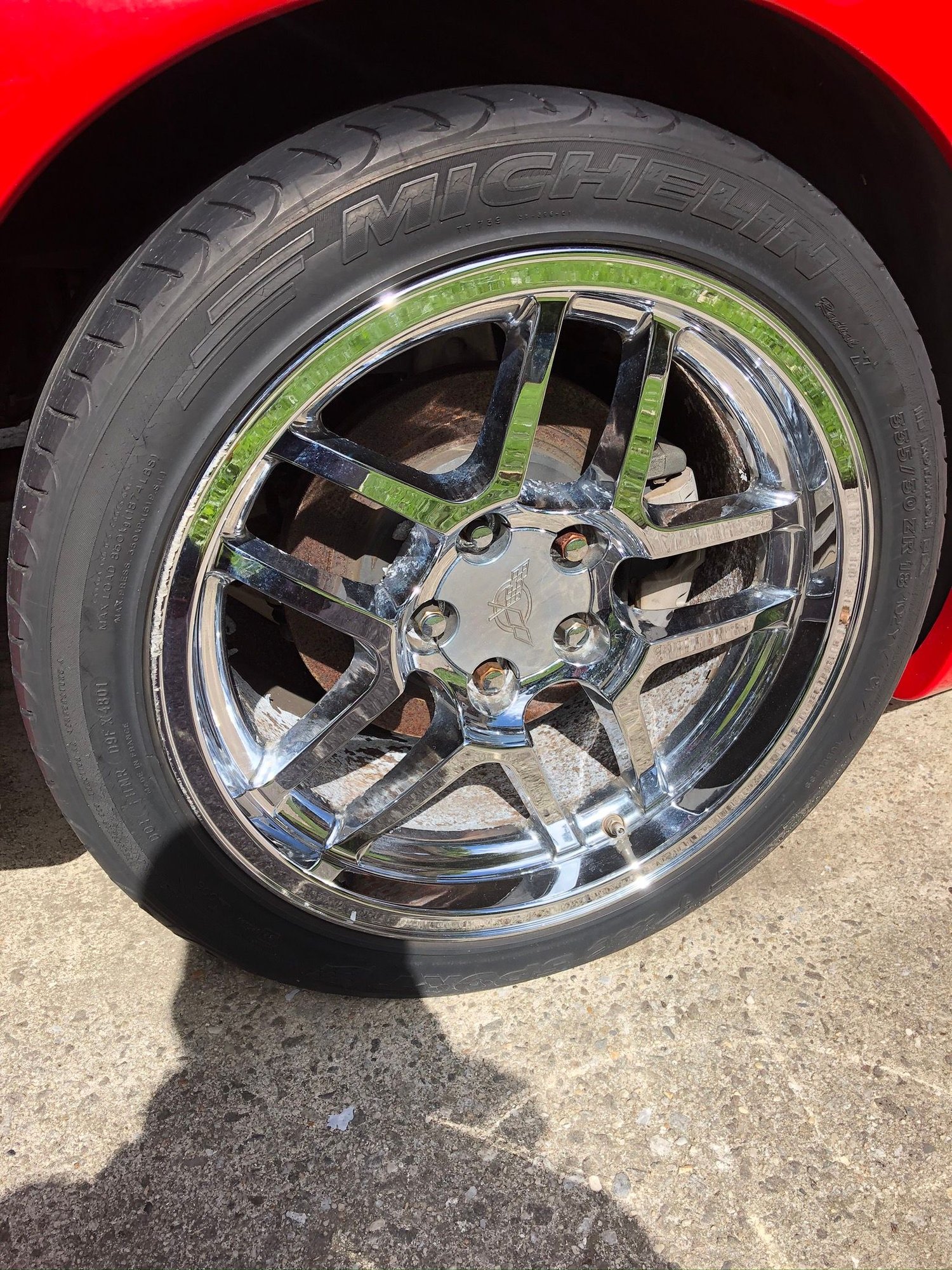

Hey Everyone,
Happy to have found this forum and a proud new owner of a beautiful C5. I recently purchased a 2000 C5 from a family member who has not driven it over the past 2-3 years (They were sick). I am in the process of getting the car inspected and need to have all of my tires replaced. Here is where my issue begins. The car has the C5 Z06 wheels. However, the back tires are 335/30/18. The fronts are 275's. The shop that inspected my car suggested I just purchase four (4) new tires/rims as they cannot purchase 335s and do not want to install, mount, or balance them. I have attached pictures and wanted to get everyone's thoughts.

A 335 is way too big for a 10.5" width wheel. Oem C5Z rear is a 295/35/18. Nothing wrong with a 275/40/17 on the front.

No, a 12" wheel would have poke. Those might not even be OEM Z06 wheels. Take one off and look for SPEEDLINE in one of the spokes to be sure. If yes, OEM. If not (more likely) - chrome replicas.
Chrome Z06 wheels are uncommon. Only available on the commemorative edition cars, if I remember right.

i used to have those 335 michelins back in the day which were on an 18x11 wheel.
your rear tires don't appear to be bulging all that much; maybe your wheels are wider than 10.5 because they're obviously not factory.
