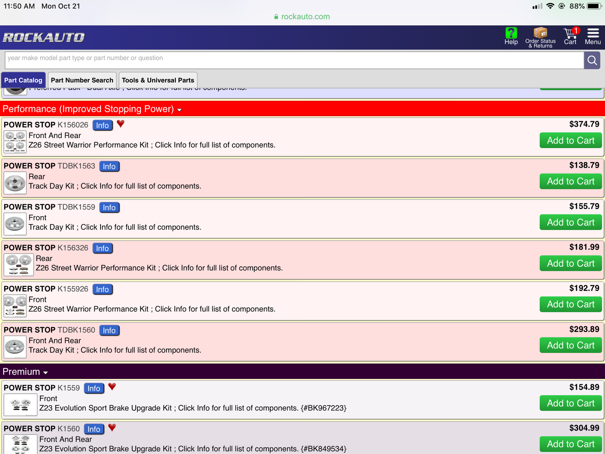

Faster5's Avatar
Faster5
Joined: Oct 2018
Posts: 458
Likes: 29
From: Bellingham, wa.
I went rockauto and have been very happy. They offer three levels of quality.
