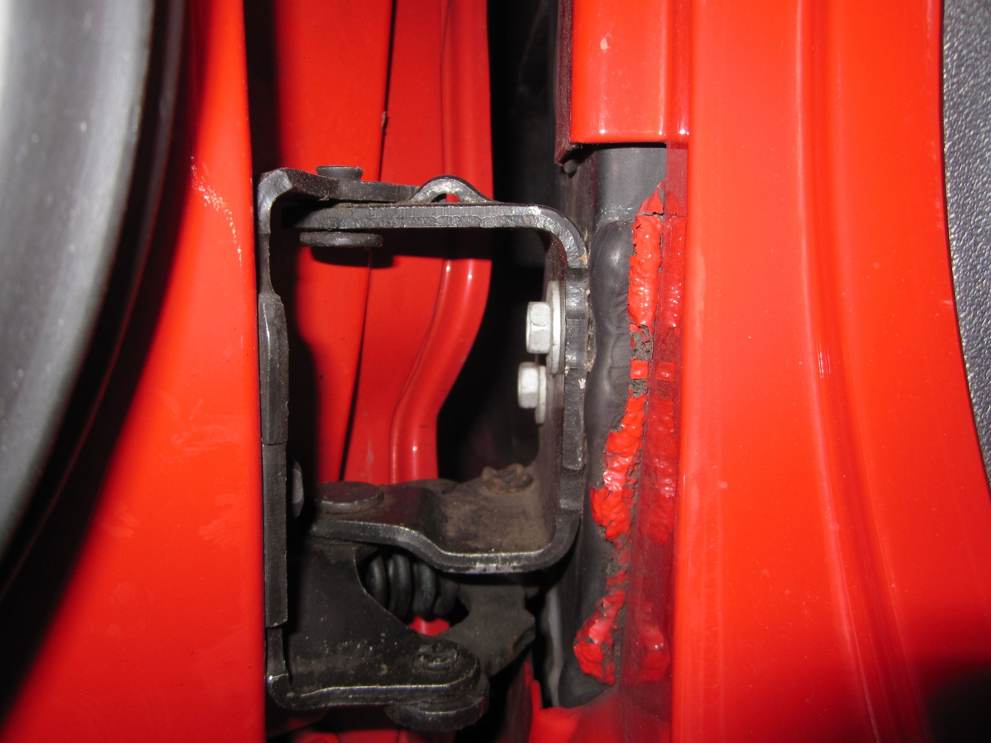

The lower door hinge includes a spring and cam, the indents in the cam determine where the door stops. The lower hinge can be removed, the spring removed and the cam modified by welding in the stop indents and ginding in new ones where you want. Here's a picture of the spring and cam on the lower drivers door with the first cam detent in view.
That plan sounds extravagant
......and in order for it to work right and not bind it has to be engineered and machined correctly.
