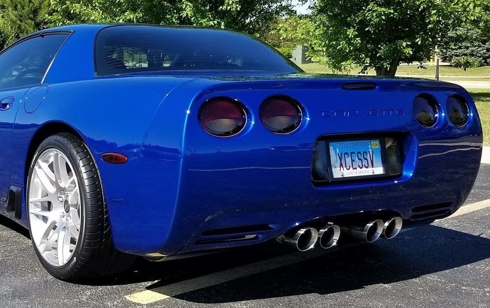

I just turned 50 two weeks ago. Mid-life "poseur" or not, I like my exhaust notes to be deep and full of bass notes. Like big-block Chevelles with Flowmasters deep. I always loved that sound. My car was equipped with 1 3/4" ARH headers, catless x-pipe, and Corsa Xtremes when I bought it. I didn't like the cackly-raspy exhaust note. To me, at idle, it sounded like the mufflers had holes punched in them. Kind of "fluttery". It was definitely wicked loud at full-throttle. While there was no drone while cruising. I just hated the sounds it made.
I ended up selling everything and starting from scratch. Kooks 1 7/8" headers and 3" catless x-pipe. LG Motorsports "Big 3" axle-back. To cut back on drone and to reduce the amount of cackling and popping under deceleration, a pair of 3" resonators were added to the x-pipe. For me, the sound is pretty much perfect now. My previous '03Z wore Borla Stingers, and I was hoping to duplicate that sound in a 3" system. Well, I got close. Deep bass at idle, and sounds like "thump-thump-thump-thump" instead of "brap-brap-brap-brap". Hope that makes sense. LOL
There is still a little drone at certain points in the RPM band. Pretty much only when the engine is lugged at around 1500rpm or so. Not too bad, really. The combination of the exhaust resonators and the cabin divider really helped a ton.

Fyrarms - do you have any videos to offer? I am curious about your setup.
