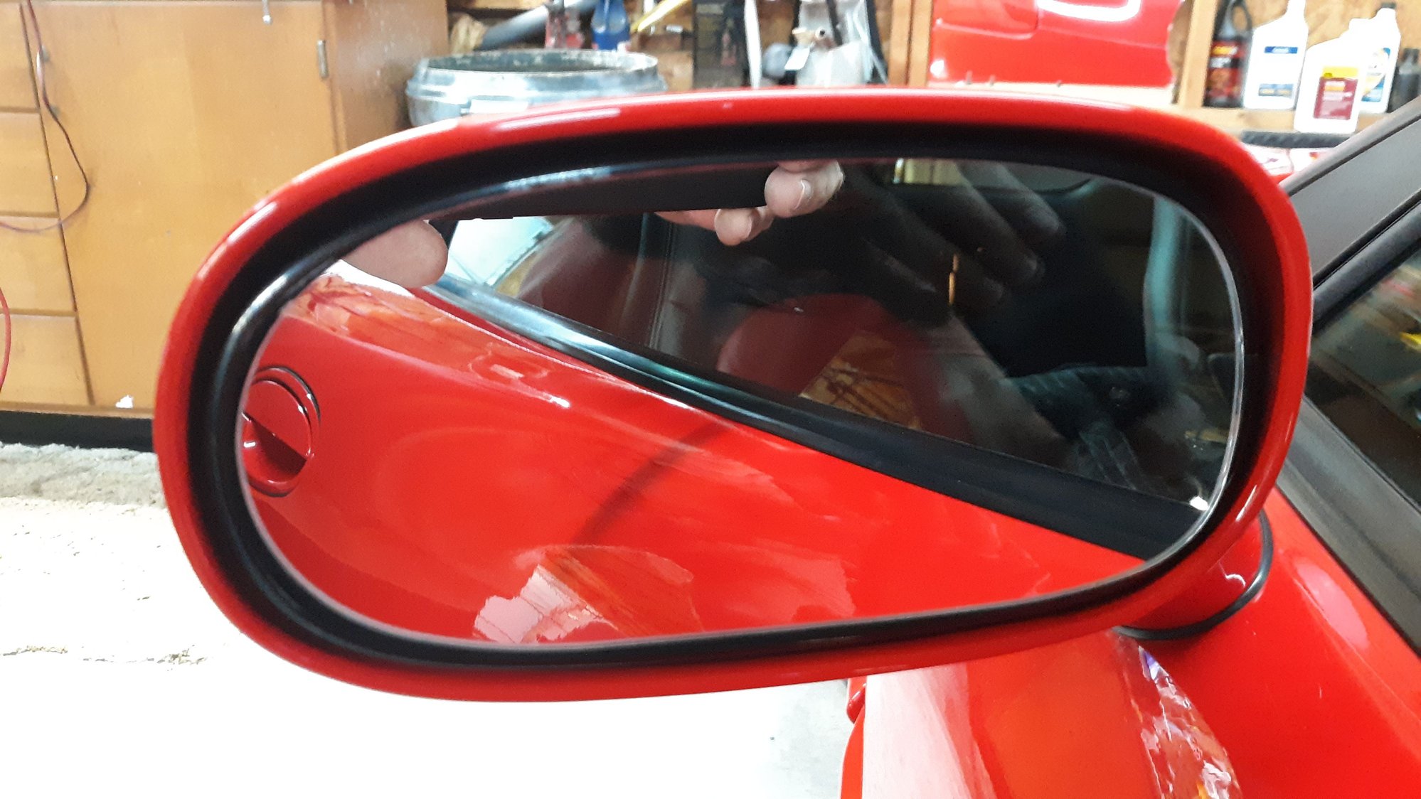

The original mirror, I took out and attempted to deal with the leaky auto dimming fluid and glued it all back together. It looks only OK - there's a sort of a burn mark (I posted in another thread somewhere) - the fluid was hiding some scratches and stuff on the metal layer which were not visible but are now that the clear glass piece is on top without the fluid in between. It was decent enough but the black plastic frame broke. I decided to replace it but to go with the 12530715 part, which is the one with heat but no auto dimming. I can't for the life of me snap it in correctly so that the motors adjust it. It just flops around. It's a bit worse that the original because there are no metal arms on this new one. It's not making good contact with the motor controls. I thought I snapped it in there pretty good. I'm hoping I didn't waste my money. I need to hit Youtube or something. I'm obviously not doing the reinstall correctly since this happens with both the original and this new one.
Old Aug 14, 2020 | 01:45 PM
Autoeng's Avatar
Autoeng
Joined: Mar 2020
Posts: 776
Likes: 246
From: KY
The ball joint arms inside the mirror can unseat when you remove the mirror. You need to make sure that they are snapped into the mirror movement mirror fully.
Old Aug 14, 2020 | 01:58 PM
shredhead1080's Avatar
shredhead1080
Joined: Jun 2014
Posts: 82
Likes: 6
Yes, that's exactly what it was. Those arms are the pieces that stick up and have little springs on the end. I had them still on the motor and they were shoved all the way in. They need to be on the mirror. I used some lube to be able to snap them in. It's hard to do on a brand new mirror. I used a clamp and had bubble wrap on the glass. The snap sound it made was scary. I thought I broke the glass. Now I just have to get some Windex and I'm all set.
