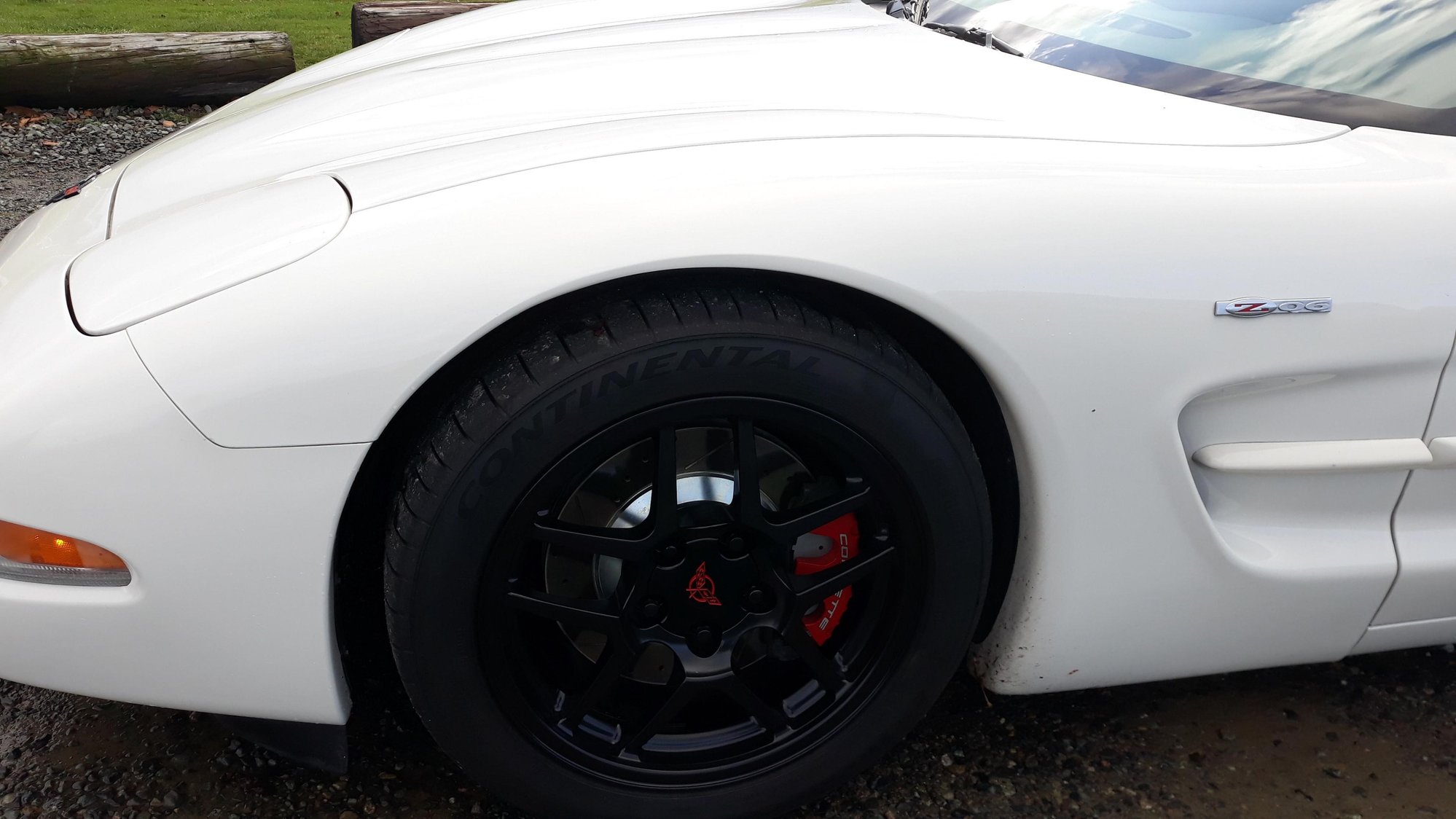

275/40-17 and 295/35-18 combo has a decent selection and the 275 fills the wheelwell better if it is lowered a bit.
275/40-17 Conti
