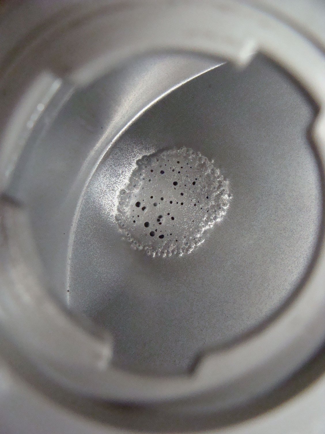

Usually one or both of the following problems:
1. The standard halogen bulbs in the housing eventually burn a hole in the top of the housing that lets water in. Causes the lamps to burn out.
2. The bulb sockets are famous for being corroded causes the bulbs to fail.
Recommend inspecting the top of the corner housing for the burnt hole and also inspecting the drl sockets and replace if needed. Also put LED's in they will not burn the hole in the new housing Here is link to one of the sites supporting vendors that sells aftermarket replacement corner lights and bulbs.
https://sharplightinnovations.com/sh...-lights&page=2
Plenty of info via search on this topic
Completely agree with all of this.
I had a burnt out bulb.
Discovered one or both turn signal housings had a hole. A past PO tried covering it with duct tape, but that didn't hold up (due to bulb heat).
Replacement bulb still didn't really work.
Found that bulb socket was a bit burned as well, so I cleaned it out, adjusted contacts, and applied dielectric grease.
Ordered new turn signal housings.
Ordered "type 2" switchback LED bulbs from eBay for $19.
Installed new bulbs and housings and really enjoy the appearance! (and functionality)
