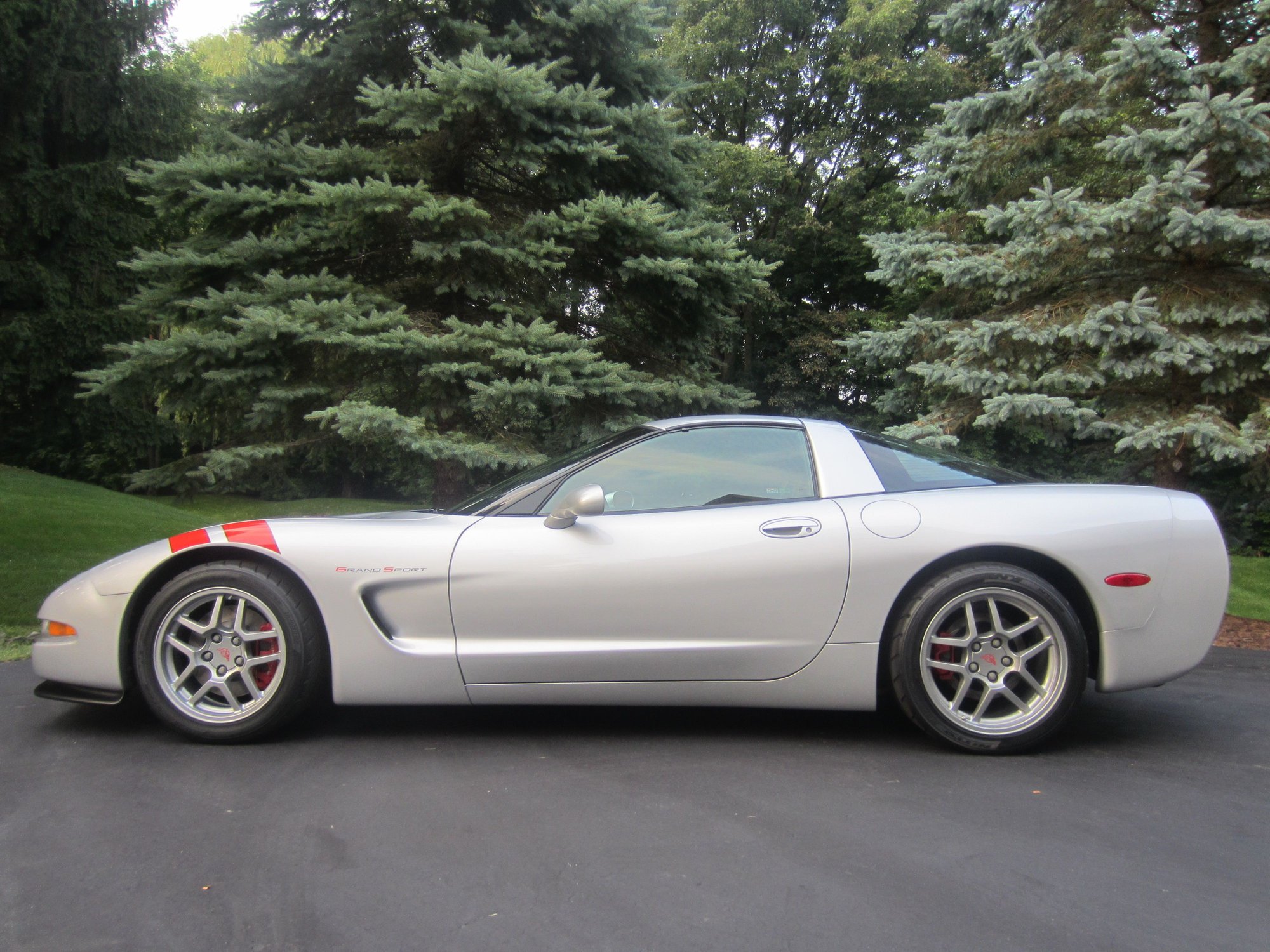

I have the 275/295 set up on OEM C5 Z-06 wheels...

I don’t find that the front looks big at all. Are you lowered at all? I’m thinking to lower mine on the stock bolts.

I never understood the rap against the 275s being "too tall" but everybody has their own opinions.
My car is lowered on stock bolts.

The nitto nt05 275 runs a little short and 295 a little tall so as a combo it works out pretty well. I've seen a 275/295 continental setup and the fronts looked too tall/fat.

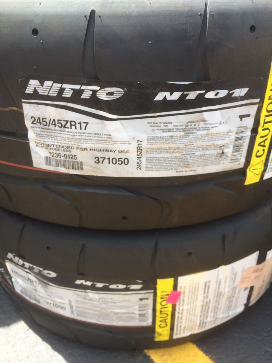

They're both WAY overkill, the nt01 is a road course competition tire. You will ruin them with heat cycles with your use more than mileage, theyre only meant to get hot a small number of times before the compound degrades. The nt05 is similar, but less aggressive. It's also geared a little more towards straight line performance. What​​​What you neglect about both is temperature operating ranges. These are tires for when it's 60F or higher, MAYBE 50F. Being in Canada, that likely limits their use.

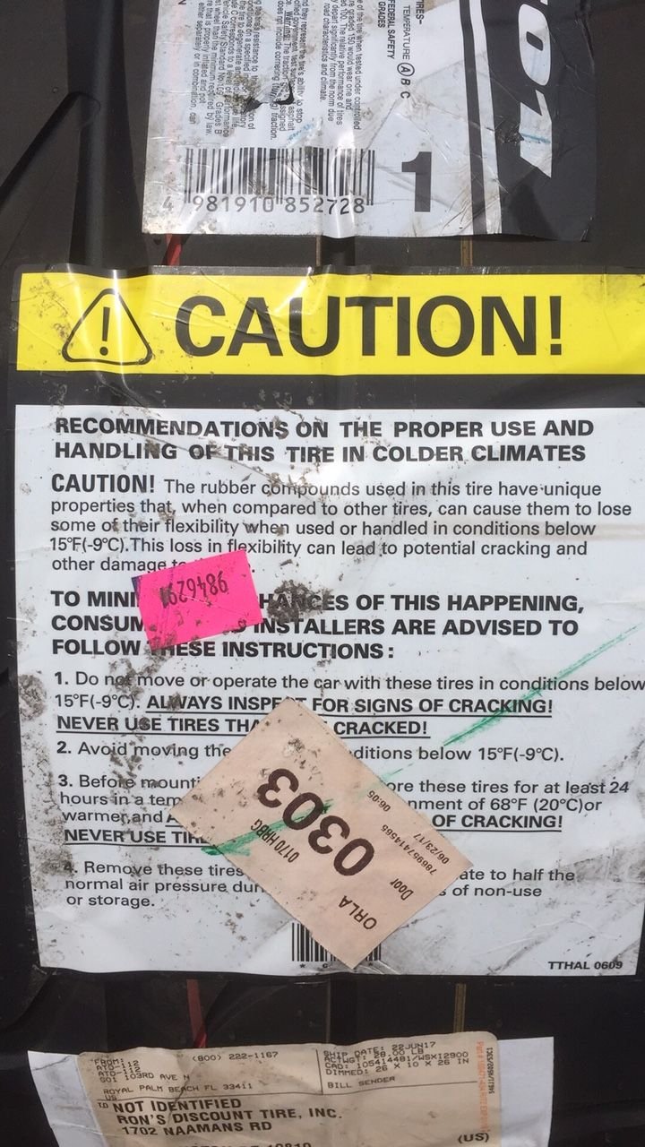

The NT-01 is a race tire. You can't let it get cold. I have a set on my wagon wheels. I mount them and drive them to the track and back (maybe 200miles r/t - only if its dry). I know that driving them there and back is a "sacrifice" but that's the deal I have going at the moment. They are a HUGE improvement over my Potenza RE-760's on the track. Currently they are covered up with a sheet in my parents basement - which doesn't get below 60 or so...

Honestly I don't think you get NT-01s hot enough in normal driving to even give them a heat cycle, I ran them spring to fall on my 911tt
But it saw quite of of track time, few times a month. Found them to always be good to the cords. That said especially when they start getting down in tread, rain is really scary on the freeway if you get caught out. Love the NT-01s but if your not tracking the car I would just run the 05s they'll last much longer

I installed a new set of 275 and 335 NT05's, on my last ZR-1. They worked great as long as it was 60deg or above. Any moisture or temps below 50deg, they were pretty slippery.

I too have the NT05s and can share four years of driving experience. These are warm weather performance tires. Below 45 degress the traction is marginal. At 50-60 you need to let them build up heat before they'll become predictable. I've accumulated 5000 miles of summer driving in a variety of conditions. These are not a wet/rain tire. Their ability to hydroplane at posted speed limits is assured. And unless your into smoky burnouts and brodies, you'll be surprised with both the mileage and grip. As for road noise, never noticed a difference.
