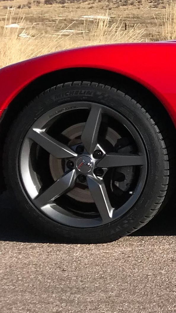

It’s time for better brakes on my ‘99 base coupe. I recently switched to these Stingray wheels; I think they’re from a 2014 model. I have a lot more room now for bigger brakes. Does anyone know what size I could go with? Do the wheels dictate what brakes I can go with or does the upper and lower control arms on the car play a bigger role? Could I go with 2004 ZO6 brakes for example? Thanks for the info!

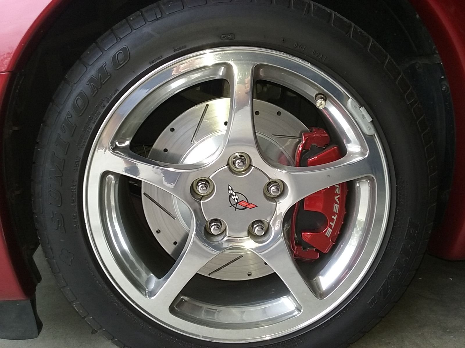

Do you track the car or are you just looking for a cosmetic upgrade? I'd personally just look at a sub $200 rotor/pad kit (forget the name, but cheap set of drilled/slotted rotors that are pretty popular, maybe someone else will chime in) if you don't track the car. I opted for the Powerstop Street Warrior kit for around $275 when I did mine. Does the job just fine on a supercharged car, as I'm sure the cheap ones would do too. I've considered a C6 Z06 upgrade, but $1,000-1,500 for added rotational mass, wheel fitment issues/consideration, and slightly better braking that I wouldn't need/use 90% of the time? Meh.

That's the brand I couldn't bring to mind at the time haha, Brakemotive. They're a solid $100 less than the Powerstops and the rotors honestly look identical (zinc coating and all). I've read the pads leave a little to be desired, so I'm not completely upset about the extra $100 spent on the Powerstops haha. That's what I tell myself anyway. A G2 caliper paint kit can be had for around $40 as well if looking for a good quality paint kit. But powdercoating will probably look better for some extra coin.
The stock brakes are perfectly adequate to lock up those Sumitomos before anything lol. Those tires were on my car when I bought it and they were borderline dangerous with stock power
