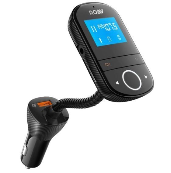

This is what I use. Tune it to a dead FM station, connect to your device, and charge it while you drive. $30.

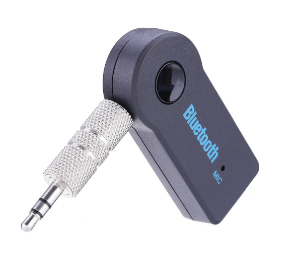

I installed a device like this in my 2003 C5 a few months ago. It gives me an AUX port which I put in my armrest console. I went an extra step and plugged a bluetooth device into the Aux port and paired it with my iPhone. It's great. I also replaced my lighter with a dual USB port. The combination means I can listen to tunes from my iPhone and charge the phone at the same time.
Aux Port in armrest (I don't have a picture of the Bluetooth dongle, but you can get them pretty cheap and they're small):
USB Port next to ashtray (I had to enlarge the lighter 'hole' a little):
The reason I put the USB port up front, instead of in the armrest compartment is that the lighter socket up front was broken, so it had to be replaced anyway. If that hadn't been the case, I would have put the USB port in the armrest. (It's always good to have a lighter socket to plug in your tire inflator!!)
So, while it takes 2 steps, (adding USB where the lighter used to be, and adding an AUX port with bluetooth device) it may solve your problem.

If you want to see the Bluetooth adapter I used, here's a picture (less than $10.00 and 2" long. An easy fit in the armrest compartment):
