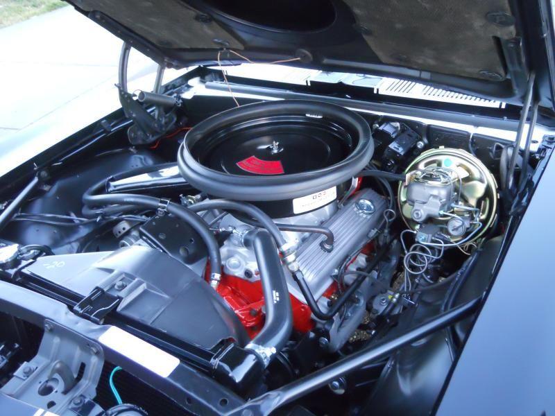

As the owner of a restored ‘69 Z28 Camaro I can tell you there are different levels of “numbers matching” criteria. For a little background in the late ‘60s and ‘70s GM applied a vehicle’s vin on several components from engines and transmissions and even to body panels. The purpose of this was not to confirm or validate a component as being original to the vehicle for originality or value but to aid law enforcement in the identification and recovery of stolen cars and their major components after a theft. This was during a time when “chop shops” were more prevalent and factory high performance components were in demand.
When these and more vehicles of all years attained “collectible” status the numbers matching terminology entered the scene.
Now to address how a basic numbers matched vehicle is identified. Talking only to major component matches as you know engine blocks all received a casting number. Of note, different blocks of the same size/cu in were manufactured in different configurations mainly 2 bolt mains and 4 bolt mains. Each had their own casting number. They also contained a cast in build date. GM would then stamp a partial vin to the rough casting so that it could not be restamped without obvious grinding to remove the original vin. When theses engine blocks were assembled the machines pad on the front of the block was stamped with it’s build date, assembly plant code and model code I.e. DZ signified a 302 cu in Z/28 only engine. This is where a lot of restampings took place. If you didn’t know where the vin was stamped in the casting you would not know if the info on the pad was valid. The pad was and is not the definitive place to verify the engine is “matching”.
Now we move on to the cowl tag located on the driver’s side firewall. This tag displays more information about the build of the car. The info we are interested in is the tag identifies the build date of vehicle. So now we have all the pieces to the puzzle. For the engine block only to certify it was delivered with the vehicle when new it must have the appropriate casting number, the rough casting stamped vin must match the vehicles vin tag and cowl tag, the casting date and date code on the front pad must predate the build date of the vehicle by no more than month or so at most and the model code (DZ) must match the vehicle model. This is everything required to certify JUST the engine block is numbers matching to the vehicle. The same mostly goes for the other major components of the driveline, trans and differential. There is usually a partial vin on the transmission but not the differential. Cylinder heads will have a part number specific to the type of engine installed on as well as a build date. Almost all of the other engine accessories/components will have the same. Even down to spark plug wires and fan belts. Wheels will have a model code and date code as well. Other than vin stamped parts and components there is no way to tell if a correctly part numbered and date coded item came on the vehicle when it rolled off the line and to purists and restorers it doesn’t degrade from the value or collectibility.
So you see throwing out the “Numbers Matching” card evokes a different meaning to different people. As for the C5 I’m not 100% sure but I doubt you’ll find a vin or date code anywhere but on the chassis. When and if these ever become true collectibles someone or some group will develop a criteria to establish and verify originality.
I’ve restored several Camaros to the standards described above and can tell you it’s an intensive, exhausting and expensive endeavor. At the time it was what I loved doing and was very gratifying when completed but those times are past for me and remain good memories. As for our C5s at present all I want to do is use mine for what it was intended and the only numbers I’m concerned with are the ones on my speedometer.
