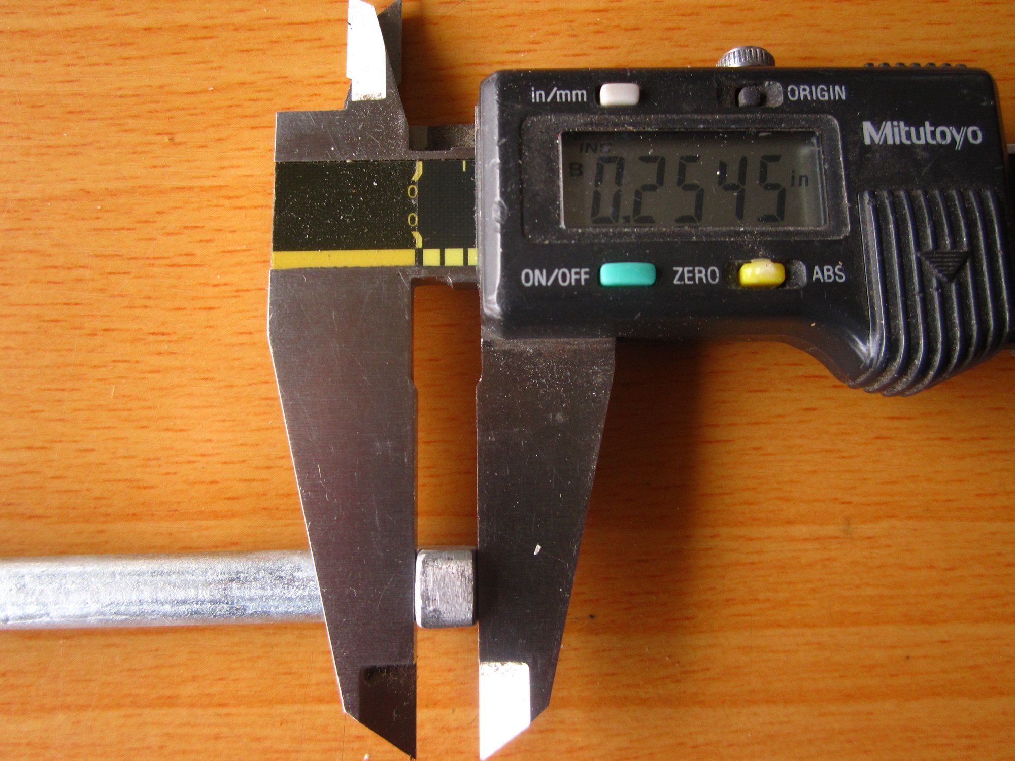

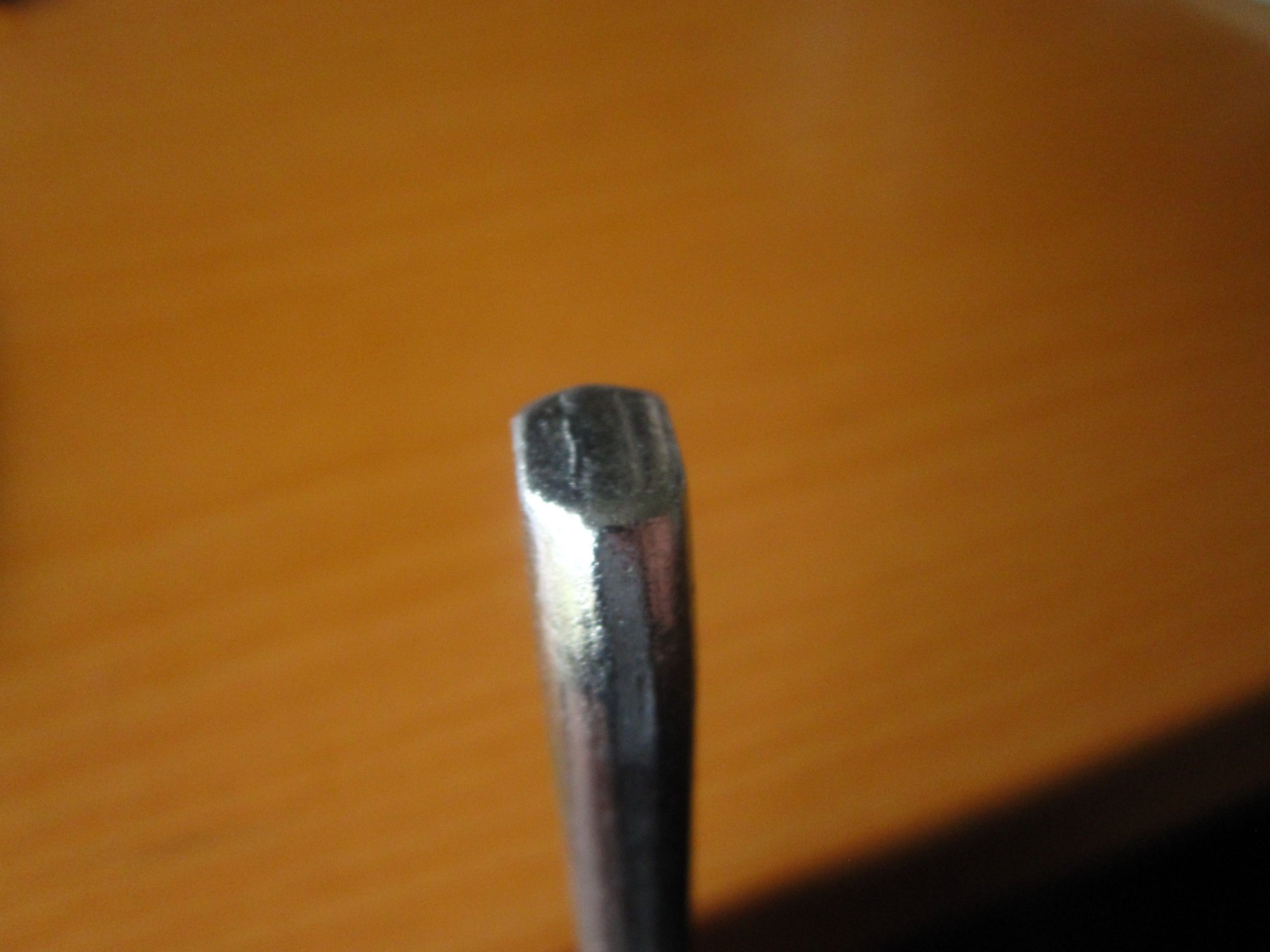

The forged steel GM steering wheel pulling rod ends were too thick and didn't fit between the wheel and yellow clockspring assembly. Here's a supplied rod end, both sides of the foot have the center ridge:
Here's the same rod after it was ground flat on both sides:
These were ground down to fit this car which turned out to be 1/4" thick, it might not require that much or any for other cars.

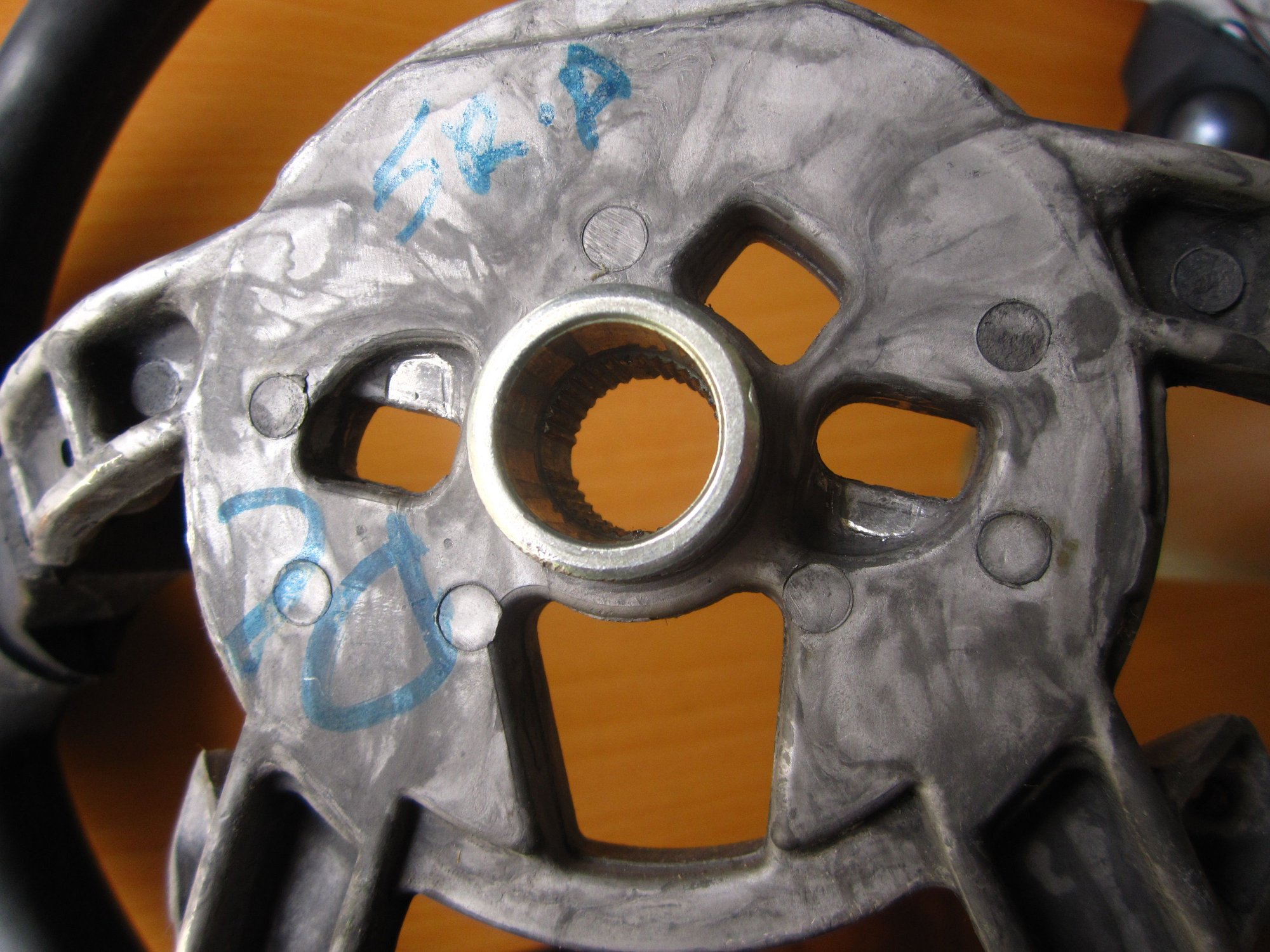

For removal, with the steering wheel in the normal straight ahead position, the left side rod foot is pointed down and the right side rod foot is pointed up. The pockets on the back of the wheel can't be seen until the wheel is removed. Here's what the back of the wheel looks like and the resulting shiny rod marks:

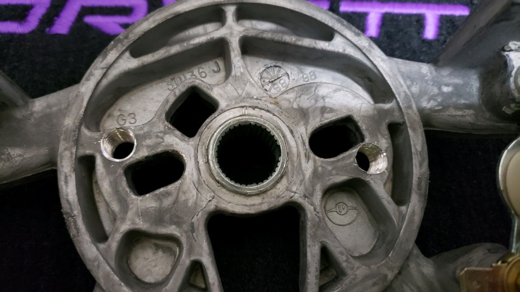

2015 C5 of the Year Winner
I think my body guy said he went to 5/16" drill and not sure on the tap size. Maybe 24??? Anyway, you can see where he drilled the holes and tapped them. Not sure either how he didn't drill into anything under the wheel but hope he used tape or something to create a stop for the drill when it went thru. I do know I had to clean up the shavings that went on the floor. I haven't had any issues with any part of the steering wheel or associated parts in the column yet so I'm going to assume he got most of it out while he drilled. He did a great job with it. Where he drilled it the wheel had the most meat to it.
