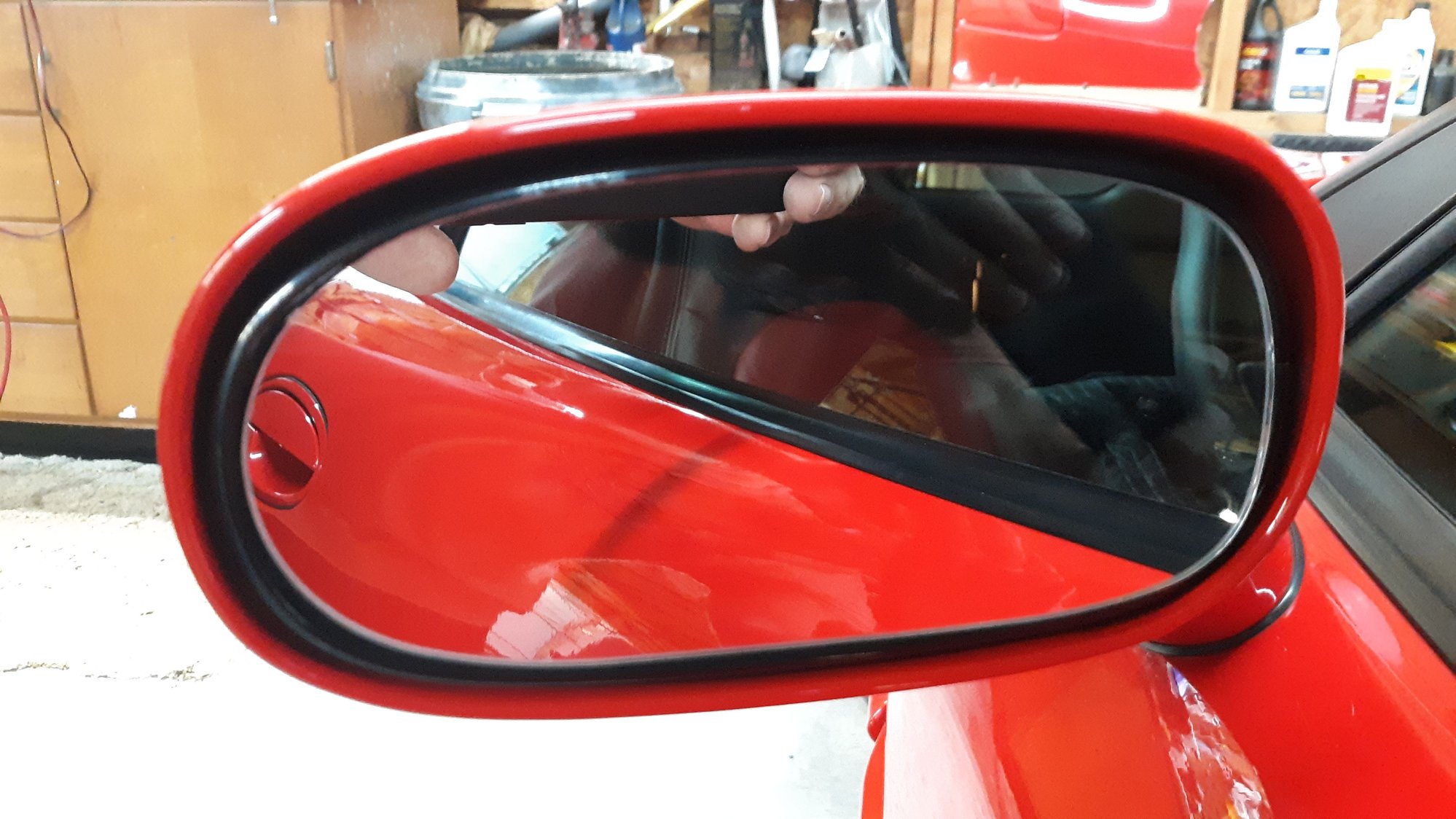

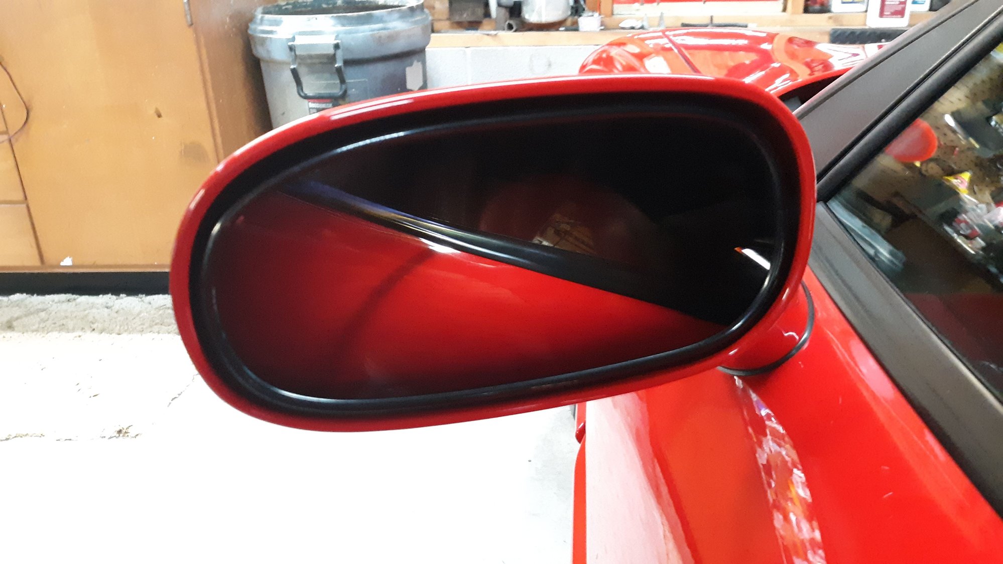

Guys I ordered one of the mirrors that sticks over the existing mirror. The one I ordered had entire sticky backing, peel and place. Some I saw had 3 or 4 pads that I think would make the mirror stick out farther than I wanted due to thickness of pads. EBAY for around 14 bucks. If you didn't know it you would never notice it, I am pleased with it. Didn't want to rip the mirror out and have to clean up the mess and still may not be acceptable. Here are couple picks before and after.
Before, really dark around edges.
After, took 30 seconds to install.

Yep one of those was the first thing I ever did to my car - the driver's mirror was USELESS from the autodim failure.

bjones7131 - your fix looks really good.
