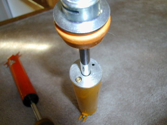

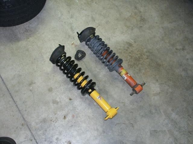

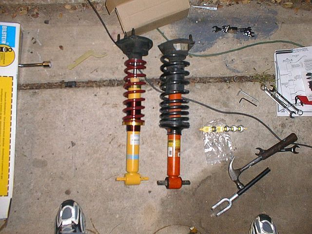

Have you considered Koni Yellow's? I ran them on my 1st GTO-GT, spectacular! At setting 9/10 all around.....And, previously on a 98 TA (check my photos). They were awesome!
Not to mention the ability to dial back the dampening, for different applications....
My TA Comparison
Another, although looks like threaded collars
These are actual Corvette Application
