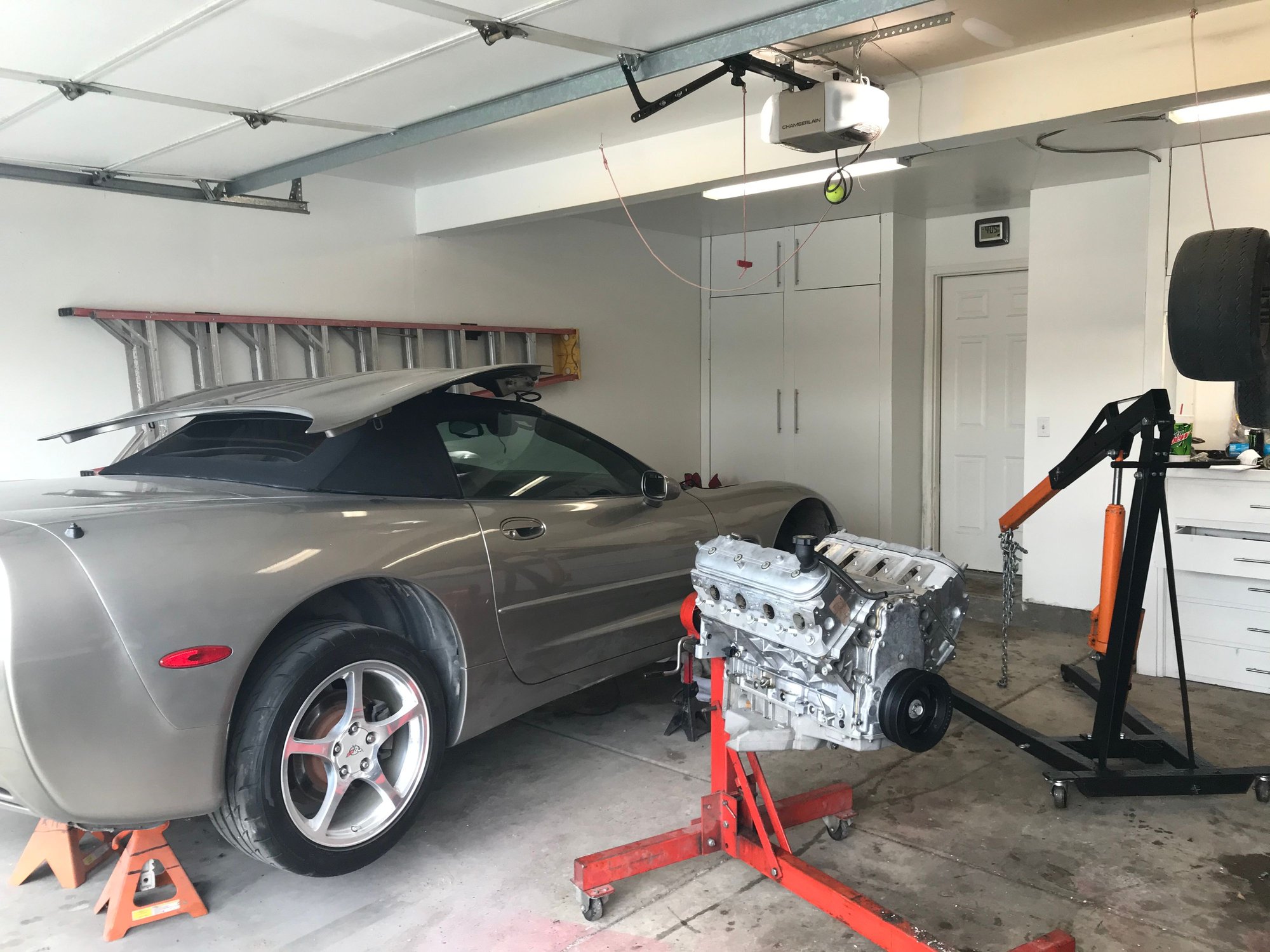

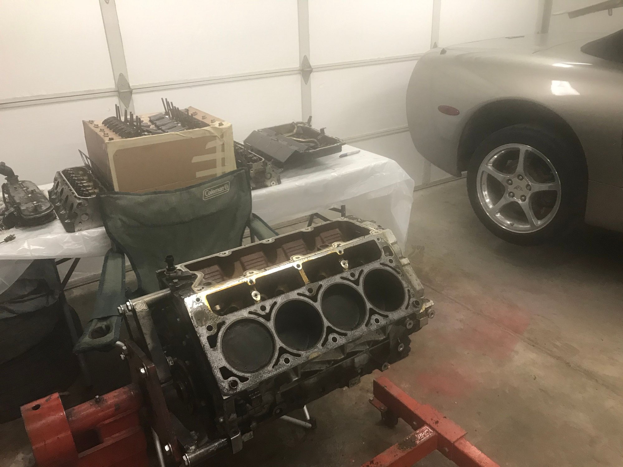

I thought I'd post a progress update. All parts have been received. I went with AC Delco for everything, except the intake manifold gaskets and the head bolts (FEL-PRO for both). The harmonic balancer is being difficult--it's killed 2 pullers so far. I'm about to order a pulley puller that's specifically for the LS1. Hopefully it holds up.
Next step: parts washer. I'll try to post another picture once it's clean.
Sorry for the poor image quality. I apparently had grease on my phone.

The engine is all clean!

And wow what cleaner did you use? Did you also use those rubber bristle attachments?

Thanks! I'm fortunate enough to have a relative at the local Chevrolet dealership, and he cleaned it for me. He used a hot pressure washer with a strong cleaning chemical, followed by the solvent tank, and then he put everything except the block in the parts washer for 20 or 30 minutes. It took a few hours, but I think it was worth it.
Now, I just hope I put everything back together correctly.
