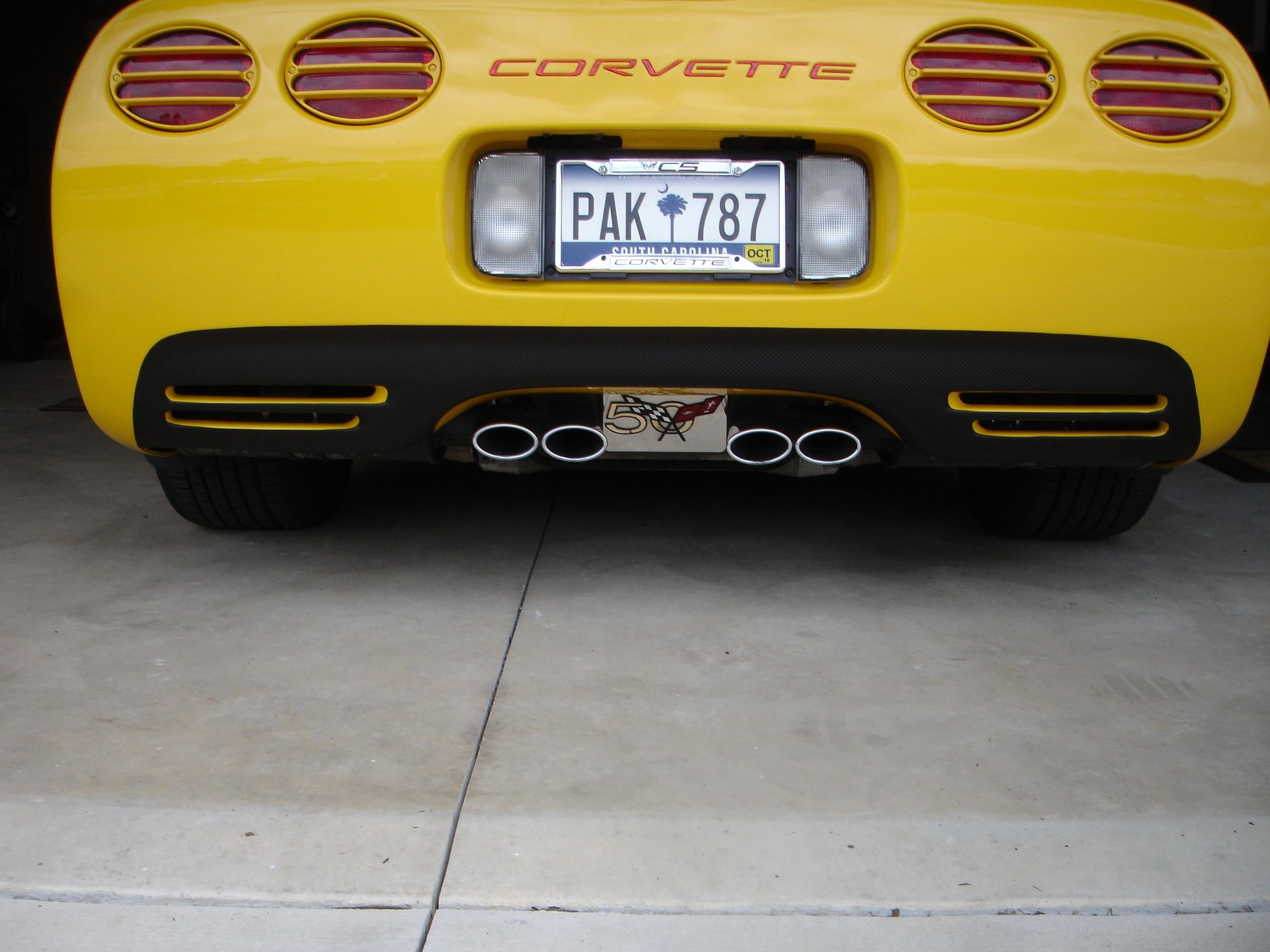

I couldn't find one, but I was able to wrap mine in a carbon fiber look wrap.

Wrapping mine was a PITA, but it's lasted 3yrs. now, and still looks like the day it was wrapped.

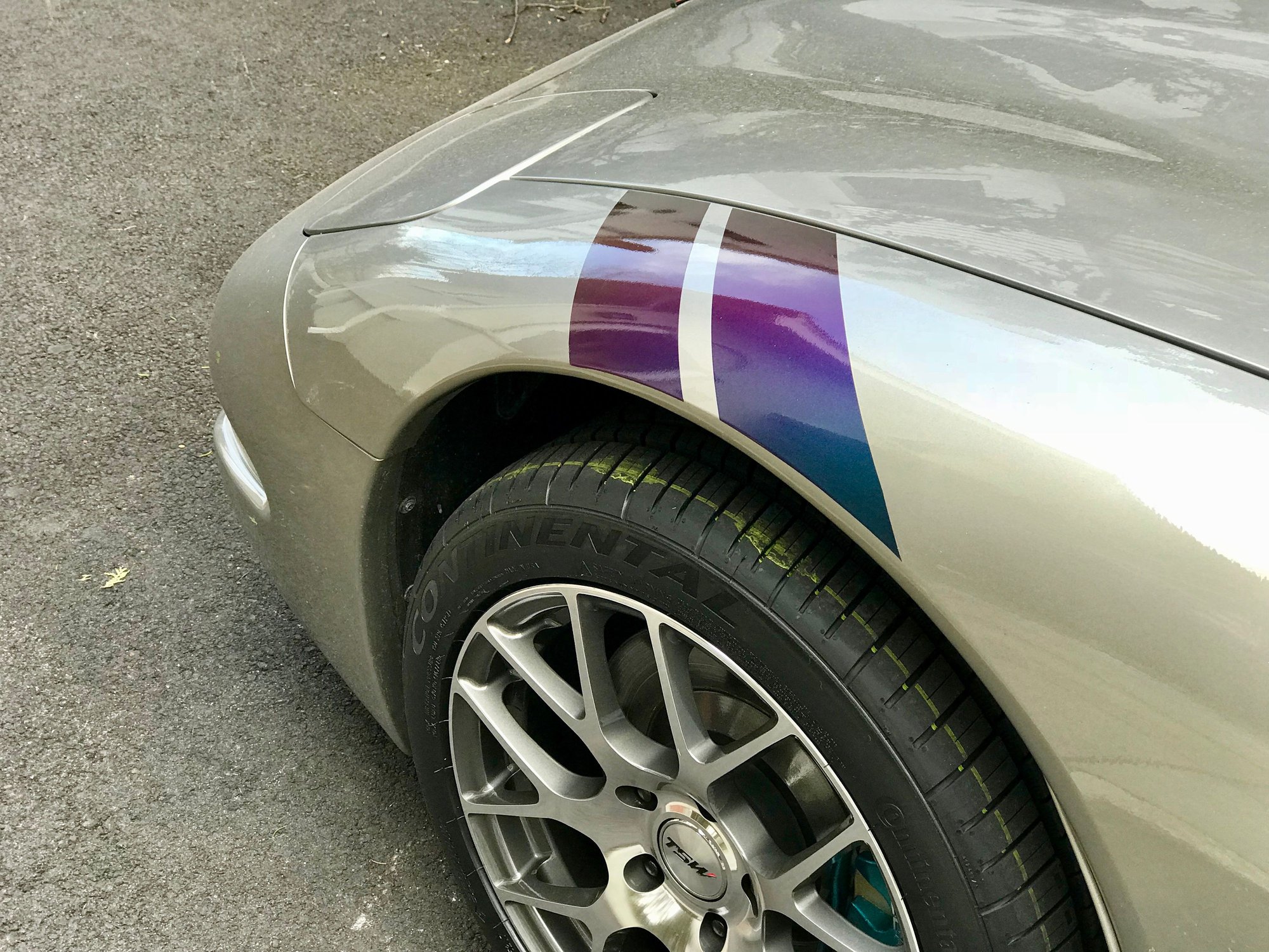

Have heard good things about the knifeless tape. Sure beats using a sharp instrument near the paint.
No question, but it’s not foolproof. If it’s not very secure against the surface and/or if the vinyl is not applied properly over it, the line will not be ‘knife-like’ crisp. That’s why I leave my hood stripes to vettestripes.
There’s also 2 types, ‘regular’ and fine/precision. The regular is fairly easy to use, but the fine is thinner, breaks easier and is harder to get started when making the cuts.When I did my second set of GS stripes, I did the ‘width’ cutting on my workbench, but since I didn’t want the stripe to fold under the fender, I used the knifeless to follow the body contour , and it came out great.
