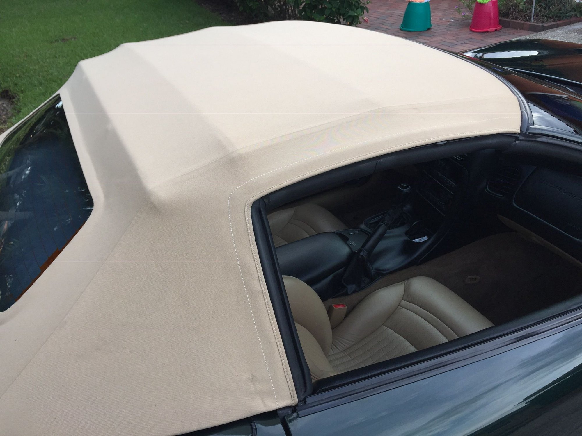

Used Griot’s Garage Convertible Top Cleaner with a horsehair brush. After, sprayed with Griot’s Garage Fabric Protector. The product did an excellent job getting plenty of dirt out and the horsehair brush is soft enough to build up a good lather and not be abrasive. Some spots may remain - but you can lather again and let it sit for a few minutes. You’re likely not going to get every piece of the fabric top spotless but yes, much cleaner. Dry the brush is the sun, it’s horse hair and trust me, not something you want airing out in your garage. Ever smell a wet dog? But definitely invest the $9 in the brush. Top two pics are after a good wash.

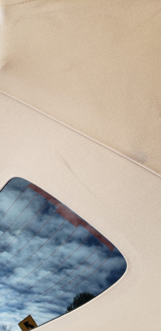

Those dark lines on the fabric top are almost impossible to get out, as they are a combination of friction and contact with metal parts. It's essentially "dyed" or etched into the fabric.
