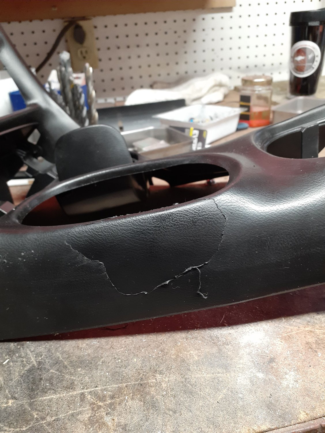

My fairly new console is already peeling. Is there an easy way to remove the coating and just leave it as black plastic. It actually looks like it would be a better match as well.

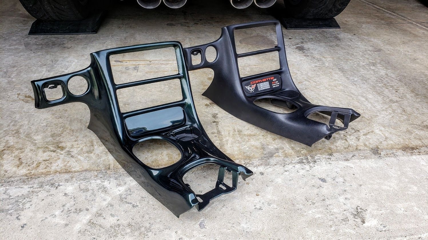

Sorry to say there's no "easy" way, but it looks like you could essentially peel most of that off. Then you could try hitting it with some dish soap and a soft-scrub sponge (like what you use for teflon pans). Then rub it down with 91% isopropyl alcohol to get any residue off.
If you want to repaint that console, you have to prep it with a Scotch Brite style scuff pad and apply some adhesion promoter for plastics (Bulldog or Duplicolor are two brands you can find at Pep Boys) before any paint is applied.
I've done this project on my own console with good results,
My Dark Bowling Green console on the left that I painted, original textured version for comparison. Preparation is everything when it comes to applying paint to plastics.
Take your time and know that it might not be easy, but it will be worth it!
​​​Hope this helps!

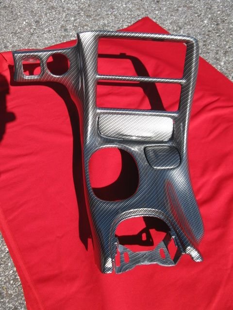

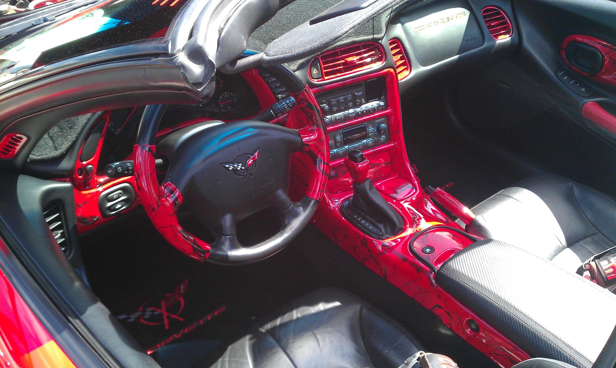

How about a custom hydrocarbon one?

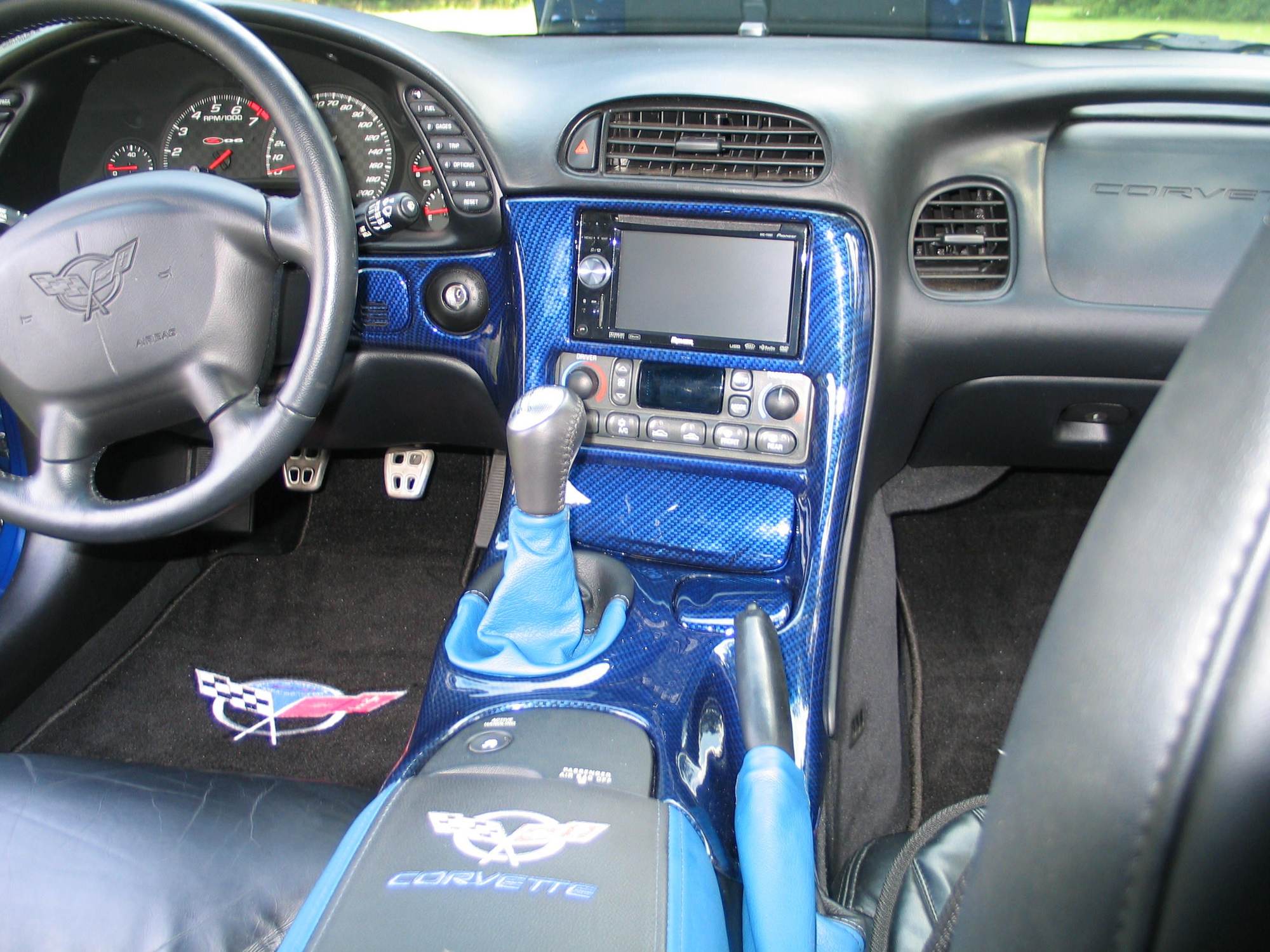

Get a Vettenuts one and go double DIN
Absolutely love most of those American Hydrocarbon ones but a couple are just too much

If he sends me the peeling one I can save him a lot of $$$.

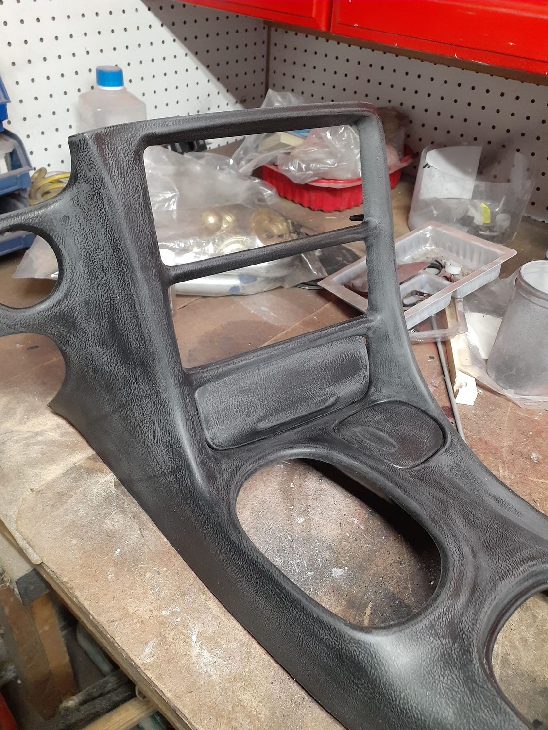

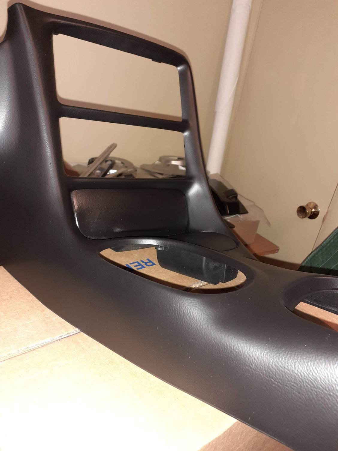

I think I solved the problem so thanks to being quarantined I saved a few bucks.
Took a while but I finally got all that film off.
Newly finished, sheen is pretty close match to existing vinyl too. I used a high quality flat black paint.
