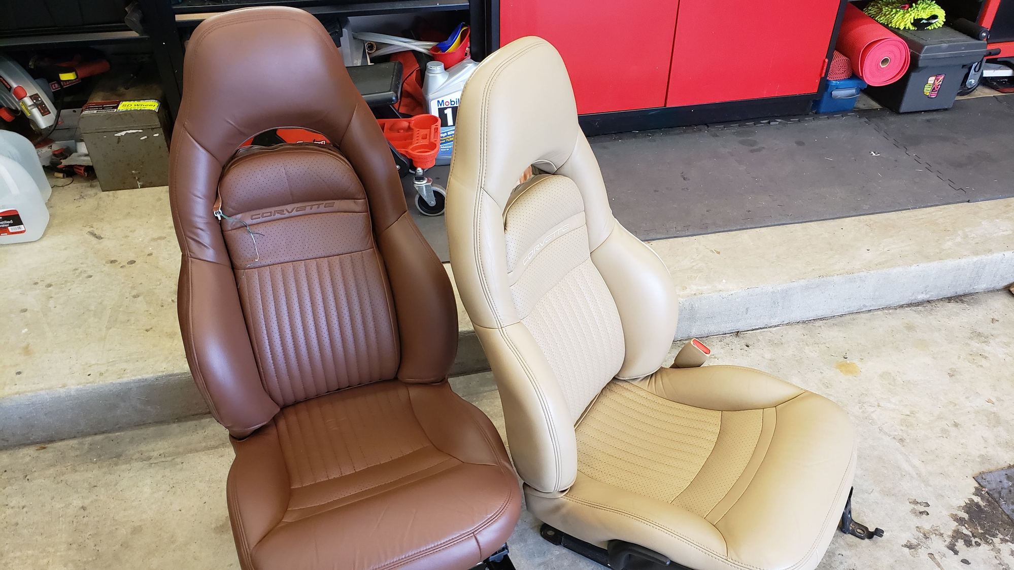

Friends, I have posted several times about my interest in changing the color of my factory-original Oak seats.
The prevailing solution is, of course, to re-cover them with new leather (or synthetic leather, your choice). My budget just hasn't allowed for such an expense, and the seats themselves are still in reasonably good shape for being 20yrs old!
Another concern for me was the danger of wasting money on a set of seat covers in a color that looked "good" online, but might be hideous in person! I don't hate light oak that much to live with it for awhile, and that's what I have done for the last year.
I discovered some leather headrest accent covers on Redlinegoods.com and bought a set with some matching door pulls and a console cover, all in their saddle brown color. I thought that perhaps I could add an accent with the saddle and live with the oak-
Hmm.. not the same "saddle" color I was picturing, more of a milk chocolate. Seems to clash with the oak more than toning it down
While searching the CF forums archives for "color your interior", I found some members mentioning SEM and ColorBond as an alternative for refreshing older seats, especially C3 Vettes and some 50th AE Vettes with the unique dark oak and shale combo.
SEM has a very specific color pallette for their "Classic Coat" dye, unless you go get some custom-mixed. In this new era of home confinement, that was not going to happen!
Colorbond had not been explored by many, but it was mentioned by all who used it that it was a sturdy product, holding up to regular use and wear.
Hmm.. I had to research some more to see what this ColorBond stuff was all about!
I actually found several BMW sportscar forum posts and a Honda S100 forum (I think that was the right forum!) showing mini-tutorials and long-term reviews of the "Leather Vinyl & Plastic" Refinisher (or LVP Refinisher). If folks were not only successfully color matching their BMW interiors, but recommending the product after many months of use (average time was seven months to a year); well, I bet I could try this stuff! If I'm going to ditch the seat covers eventually, what do I have to lose?
And quite frankly, I really liked the BMW Cinnamon color, as it seems to resemble to a degree the C7 Corvette Kalahari interior that they offered with the 2014 Lime Rock Green Corvettes! (You may not agree that the two colors are similar, that's okay, it's the closest thing I could find and like the color).
Well, what an added bonus- this product is available on Amazon.com for $15/can! The prep cleaner was $13. My wife agreed that this el-cheapo DIY project would be worth attempting, and at least it would keep me out of her hair for a few days!
With the Boss's approval, I placed my order!! 3 cans of LVP Refinisher in BMW X5 Cinnamon and one 4 oz bottle of Prep Clean.
Now, I pre-cleaned and treated the 20 year old leather seats with Leatherique Rejuvenator and then Prestine Clean. This is not a step that is required by ColorBond, and in fact, I contacted Malcom at Colorbond to be sure that it wouldn't hinder the success of the LVP spray adhering to the leather. He said, "no problem, as long as there's no silicones in that formula". There aren't, in fact they remove any silicone that may have been applied in the past! Again, the Leatherique was my own decision. I had treated the seats to this one-two punch of restoration back in September with very good results, and it really softened up the rather brittle seating surfaces.
So the BIG day of arrival was this past Friday! I have to be honest, I was feeling a wee bit squeamish at the idea of removing my seats and subjecting them to a spray bath of color, but I read the BMW threads once more for confidence, and went at those seats with intense focus!

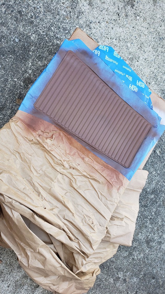

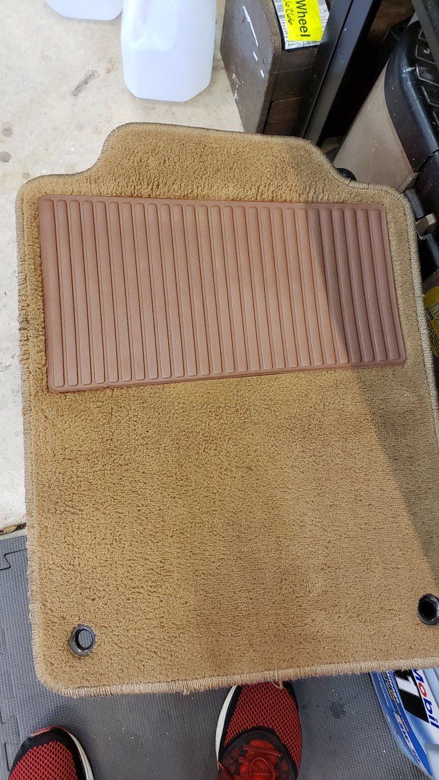

Performed the same prep and three coats for these pieces
And here they are installed within an hour of painting them
Where is that driver's seat?!
This stuff is really holding up to my handling it, pulling it, and actually even putting my fingernails to it!
I decided it might be fun to see how long it would last under my heel; so I sprayed the heel pad of the OEM floor mat-
Again same prep spray with a scotchbrite pad and three coats; I purposefully did not use plastic adhesion promoter on this, just to see what would happen for extended use
You might see a slight line under the heel pad; that's a bit of overspray from the hasty masking job. I was able to remove that while it was "wet" with some of my P&S "Carpet Bomber" carpet cleaner

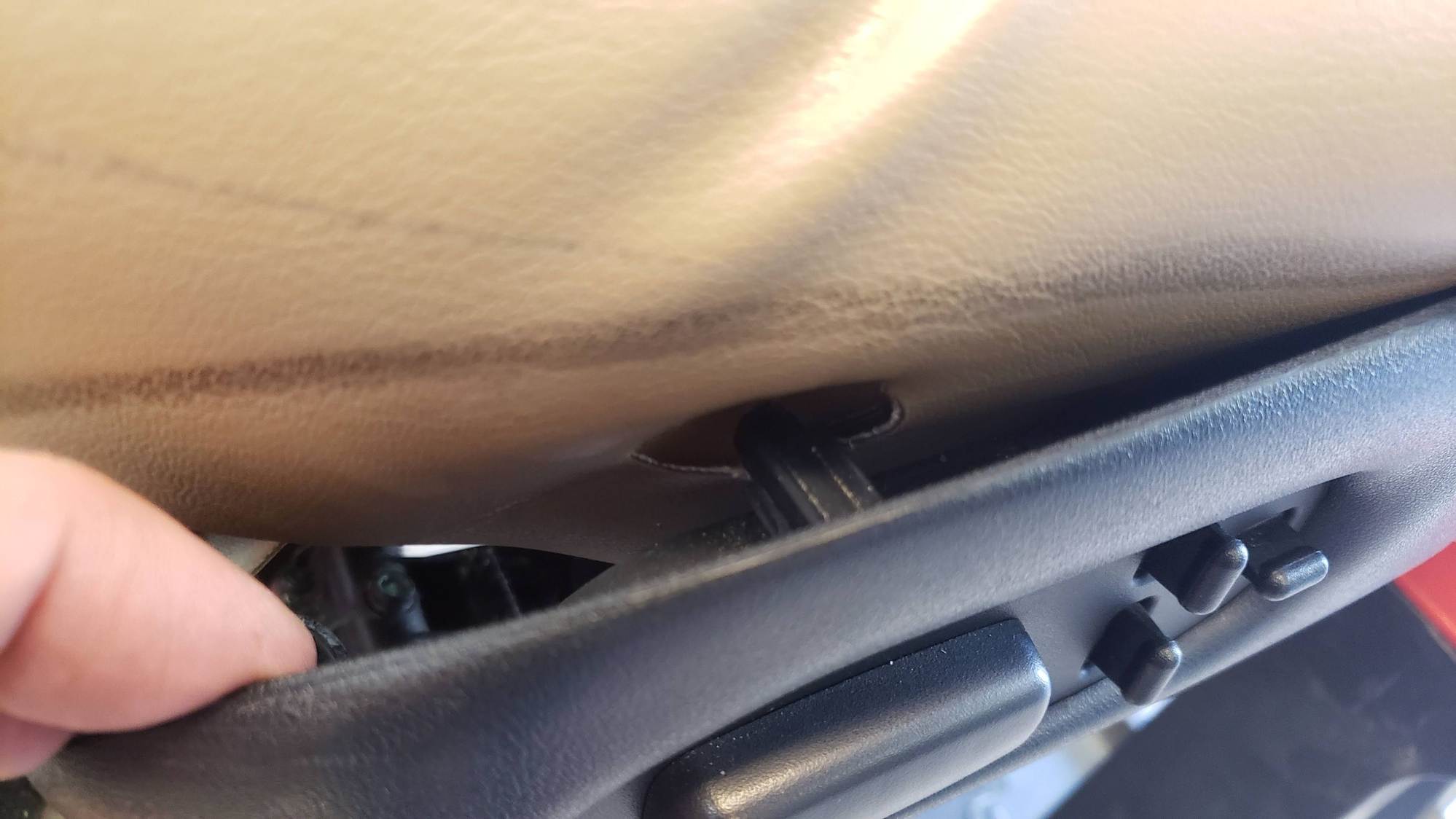

As I mentioned, I was doing some serious tugging and wrenching on the newly painted (I really consider it "coated") surfaces to get the zipper to work, and nowhere did the new finish show any stress marks, flaking, or smearing. This stuff is leaving me scratching my head at how durable the dried product is.

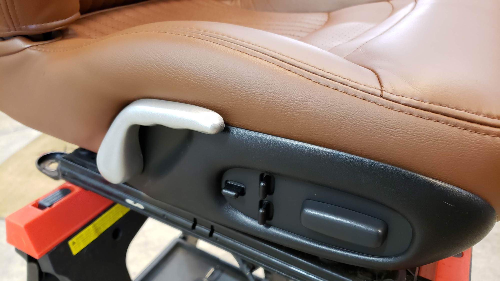

The recliner handle looks better in clear coated silver!
