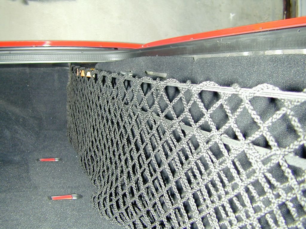

You need 4 nut anchors. 2 are lower outside edge near the outer floor covers in the rear. Then, straight above them there are the others. If they are there you should see them easily. If not, you need those to mount it properly as GM does. I hope this makes sense.

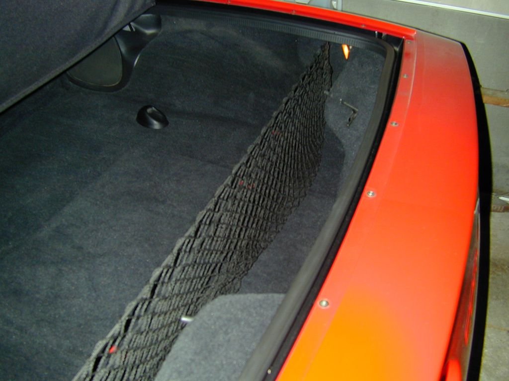

Against the back wall of the trunk. There are 4 hooks.

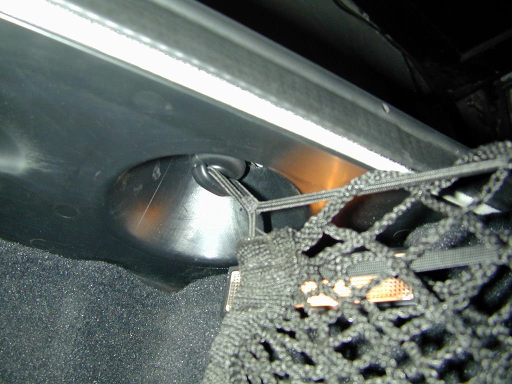

That is not where mine are. Mine are up under the top of the fender. You have to stick your head way in and look up to find them. I had the car for a year before I found them

I have a convertible. May be in a different location for a coupe.

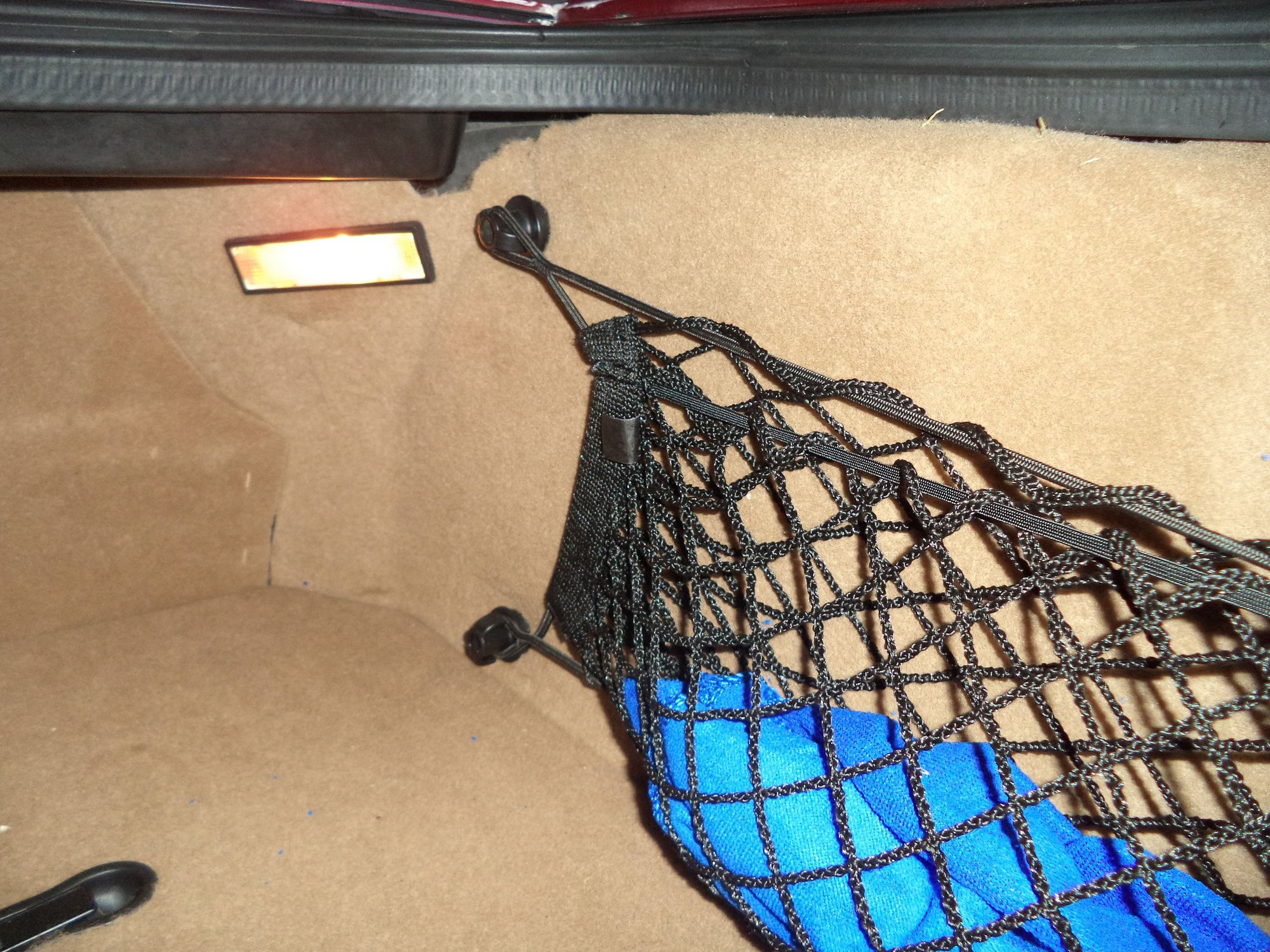

factory location

Holy crap, how's a guy supposed to have found that!! hahahah Thank you so much!

Thank You, Thank you, Thank you Evil Twin. I would have never found the top ones even if I had the top plastic hooks. Anyone know where to buy the plastic hooks? Vette Nuts maybe:

Vette Nuts has them for $3 each. Just pick female in drop down.
