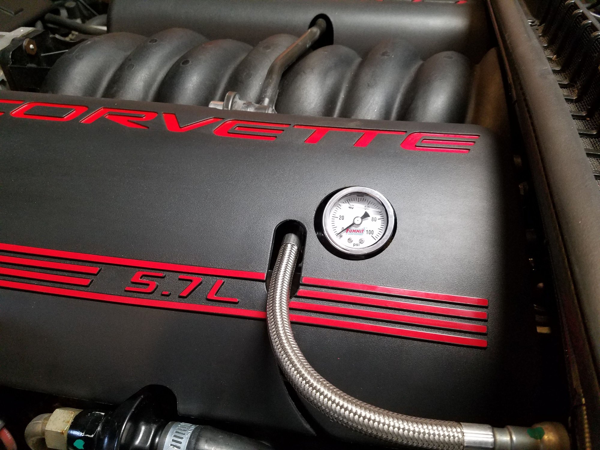

Did mine a couple of years ago and put in a relocation kit. I used this one - expensive but high quality and the gauge through the fuel rail cover is way cool: https://www.dpecorvettes.com/oil-pre...elocation.html

Exactly what I did too....
