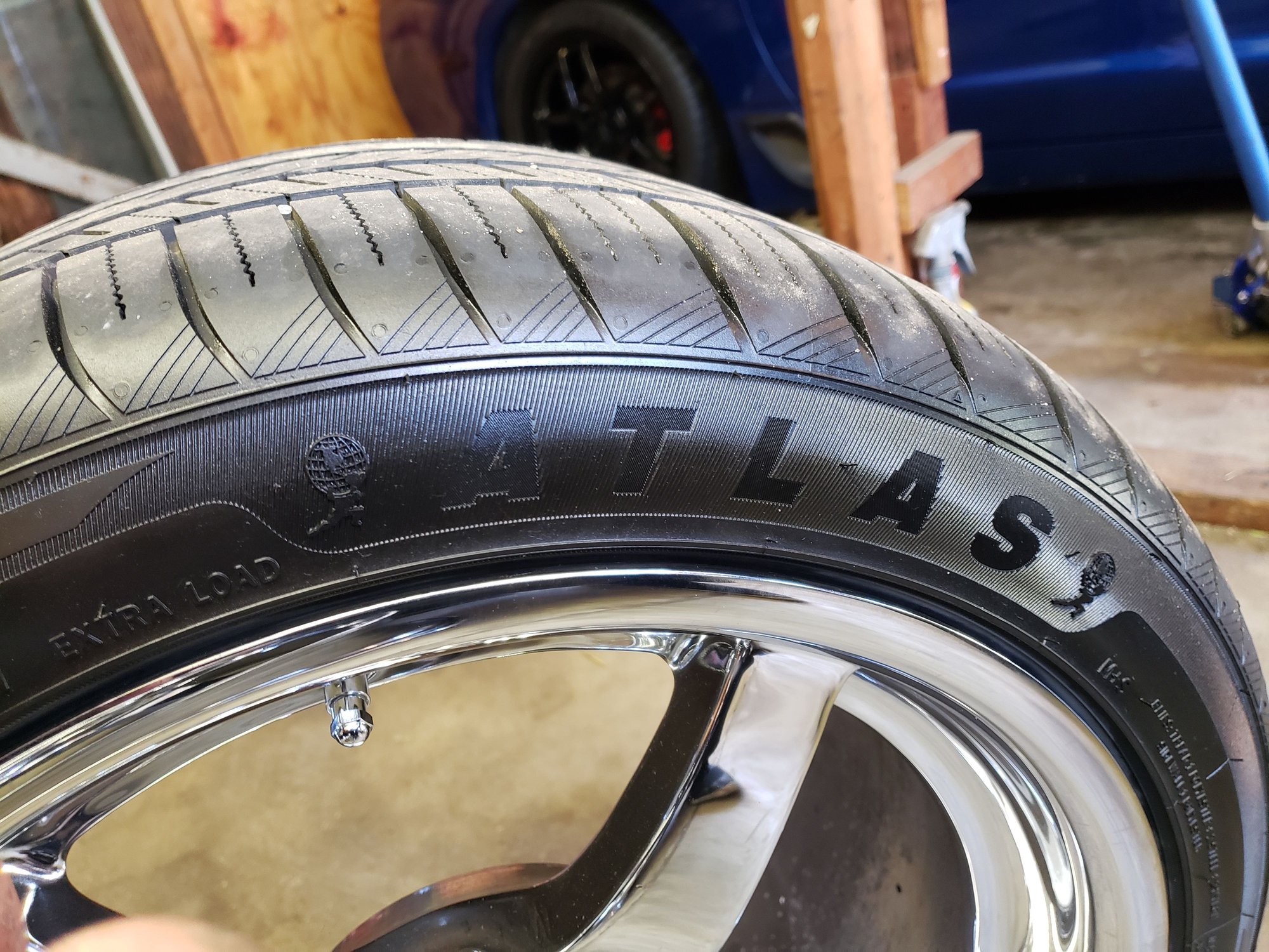

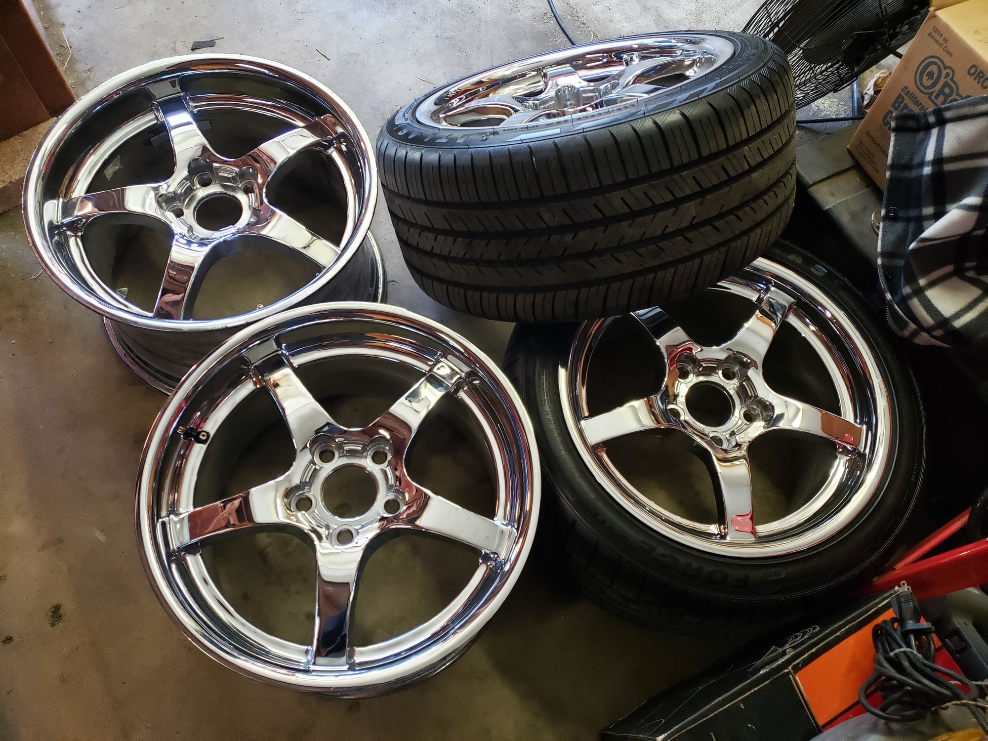

Here we go again... l apparently have some very odd ball tire sizes on my 03 Z06. when l purchased this Z a few weeks back, it had brand new wheel/tire package on it consisting of chrome deep dish aftermarket wheels, not sure the brand but this is them right here
https://www.ebay.com/itm/Chrome-C5-D...E/123140190784. And l gues look quite good if you are into chrome,

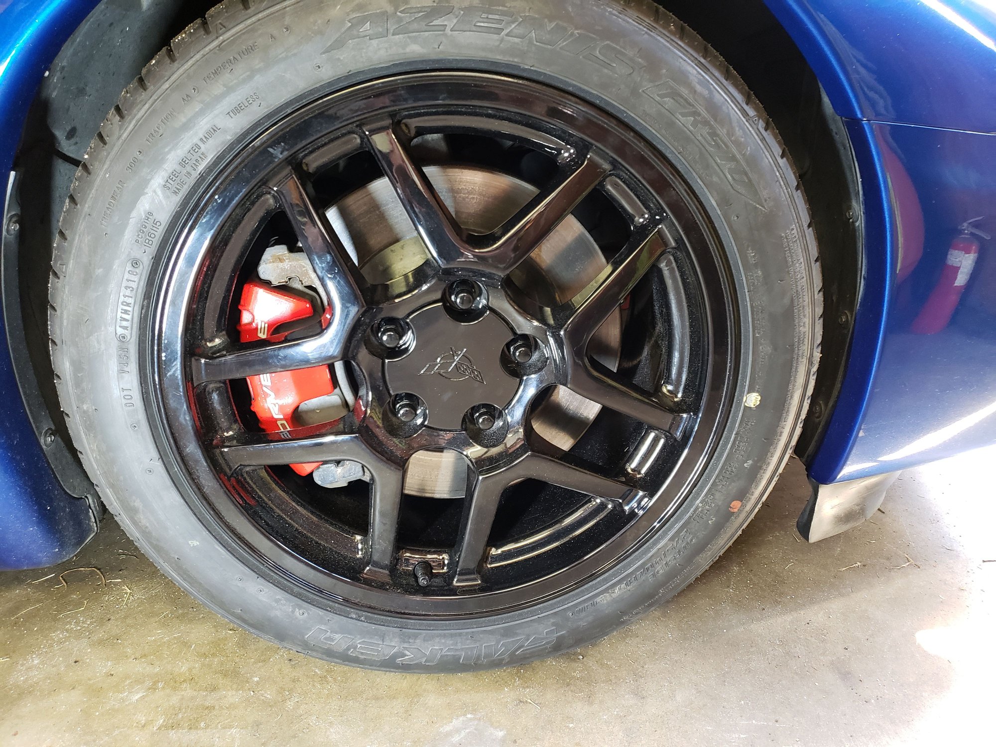

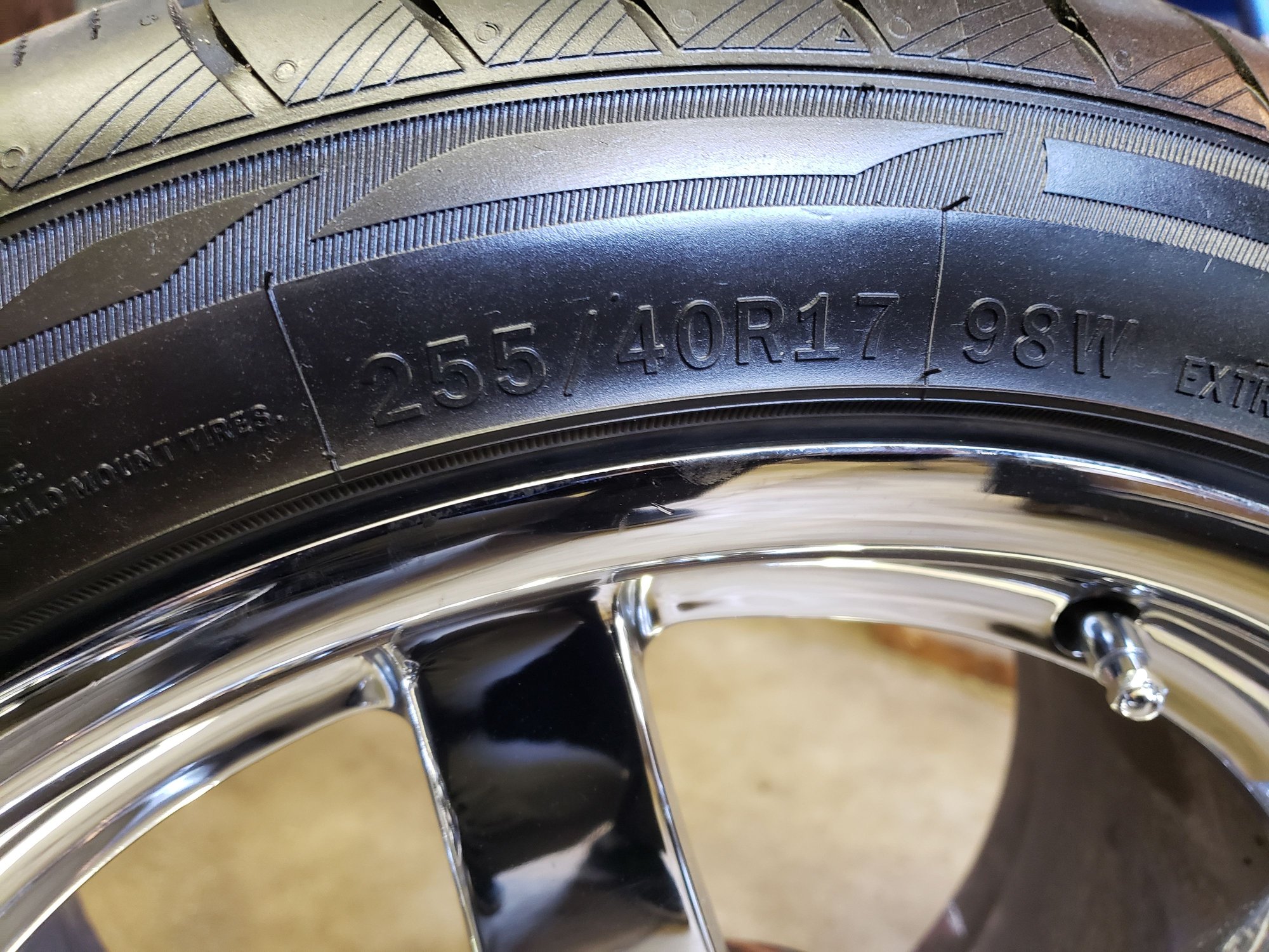

which l am not. The tire size is 305/30/18 on the rear and 255/40/17 in the front. This set up didnt look too bad (other than the fact the prior owner had this car WAAAAY to low. l was fortunate enough to get the full set of factory Speedlines with this car which l had powder coated black. l transferred the rear 305's to the 18's and l bought some wider tires for the

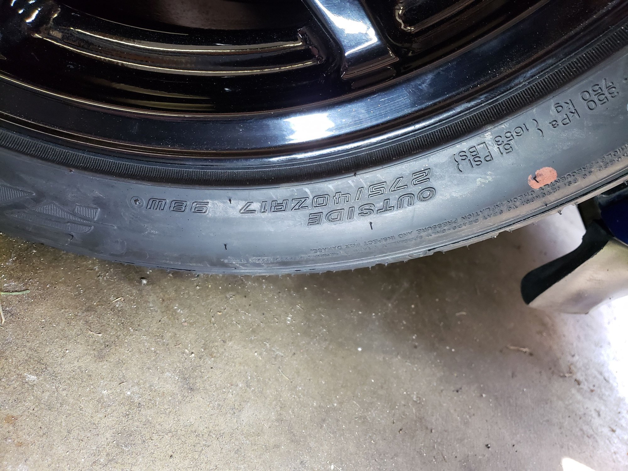

front as l didnt want that skinny of a tire up front with a 305 in the rear. So l bought a set of Falcon 275/40/17 and had them mounted. And there was my mistake. l had no idea the

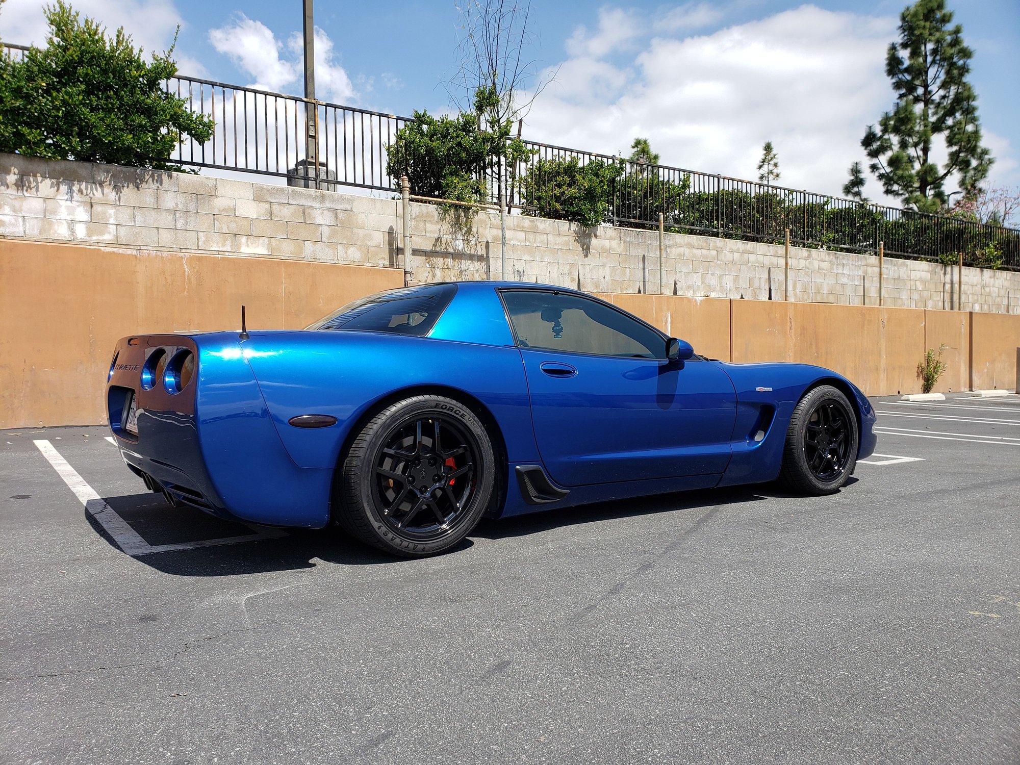

height difference between the 255/40/17's the car came with compared to my new Falcons. The car looks so damn stupid now as the front is taller than the rear .. l have found
no good permanent solution to this as the actual tire I need for this 275/35/17 which doesnt exist. l actually found a NOS set of Bridgestone Expedia S01 shipped to my door for $275.

front Speedlines as l will now have a full set of 4 ( l am able to purchase a full set of the factory Speedlines for cheaper than just 2 rear 18's ) l have 2 of the front 17's that are powder coated black with the aforementioned 275/40/17's on them, all brand new. Would these even be worth trying to sell? Does anybody ever run 4 of these? (dumb question l know) l will
include some pics of the chrome wheels with the tires on the front and the before and after pics of the Z. Still looks better on black even though its sitting higher in the front

I think it would be a helluva a lot easier and cheaper to just put the 255s on the front which is the size many run when they don't like the look of a 275 on the front.

Good point Mr Black and I myself have thought about doing this as well. The reason I didn't is I don't want such a small tire on front (255) vs the massive (305) tire out back. This will surely encourage push when entering a corner hard at speed

What brand are those 305/30/18's, R Jay? Tirerack and Discount Tire do not show anyone making that particular size. A 275/40/17 is 25.7" tall and a 305/30/18 (if such a size exists) would be approximately 25" tall or so.
Running a taller tire on the front can cause AH/TC issues.

They are some off brand called Atlas and the model is Force. That's what was on the car when I got it. I did a little research and I guess they are pretty popular with the drift crowd. Maybe cuz they are cheap? Not sure but I kept them because they are brand new

Hmmm I just saw the Extra Load weight rating. I personally wouldn't want that on a C5. That is generally what is used on SUVs
Not saying this to bust your ***** but worrying about the handling characteristics of having a 255 up front with those weird china tires on that back seems kinda bass ackwards?
