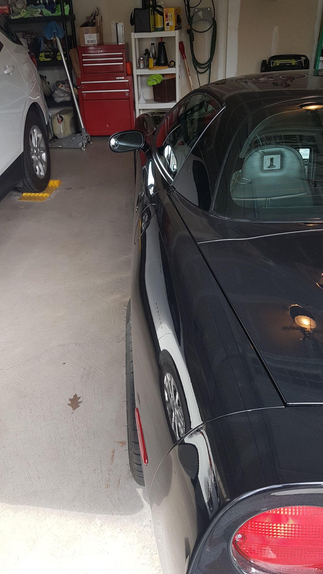

here's how mine looks for reference. the poke is a bit much for me to be honest. the front fit is nice and flush, really it's just the rears that arent ideal. I think some like the somewhat old-school muscle look to it. I hope to address the setup it when it comes time to change tires but for now, it's acceptable and not offensive. sorry for the photobomb, but this should give you some reference.

Looks great. I like that setup. So no additional modifications need to be done. Is those factory size tires that come on that wheel from factory

Normal offset on a 9.5" width front wheel, in a C5 fitment, is around +50 to +56. Definitely not a flush fit.

correction noted. while it is certainly better than the rear it does still have a slight poke at the front.
