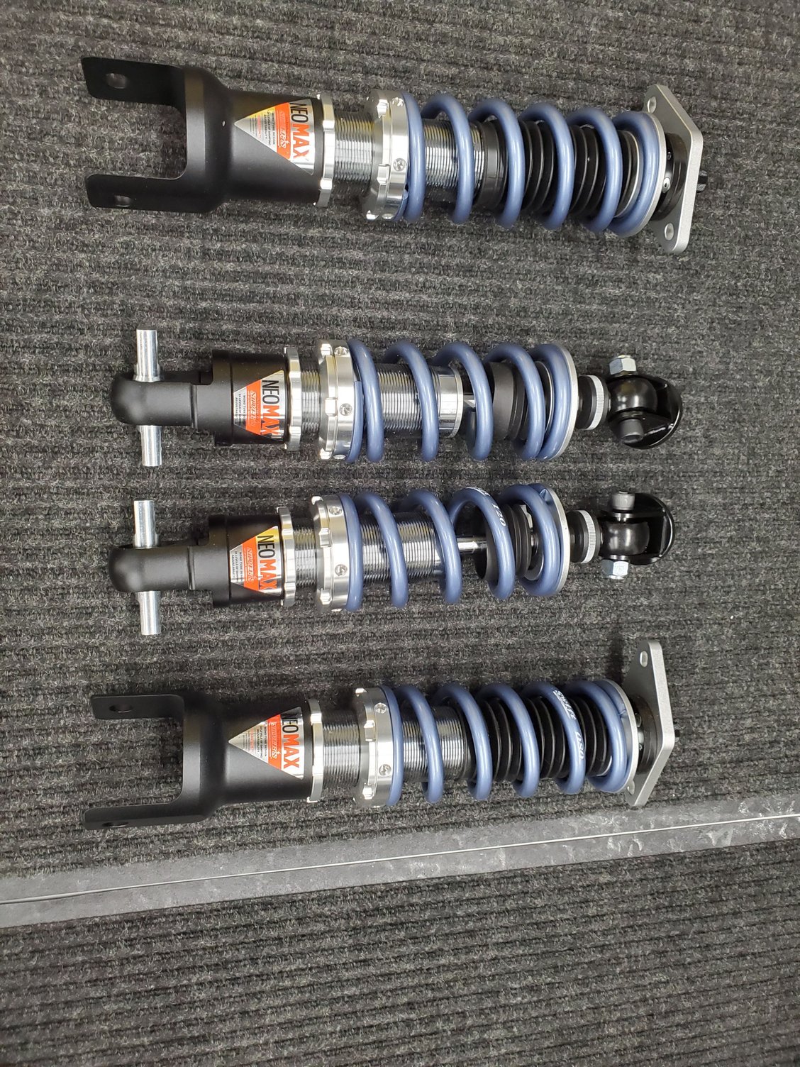

First thing I wanted to do is get the car to set right. After looking at several other cars I choose to go with Silvers coilovers. With upgraded swift springs. 562lb in front and 652 in the rear.

I. House the Silvers coilovers because I can adjust ride height without loosing preload on the springs. A really nice featuring.

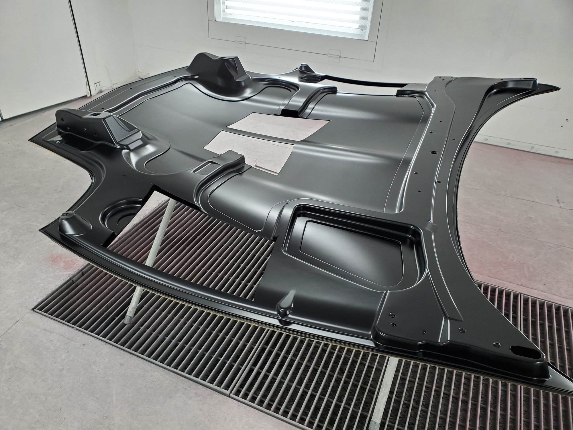

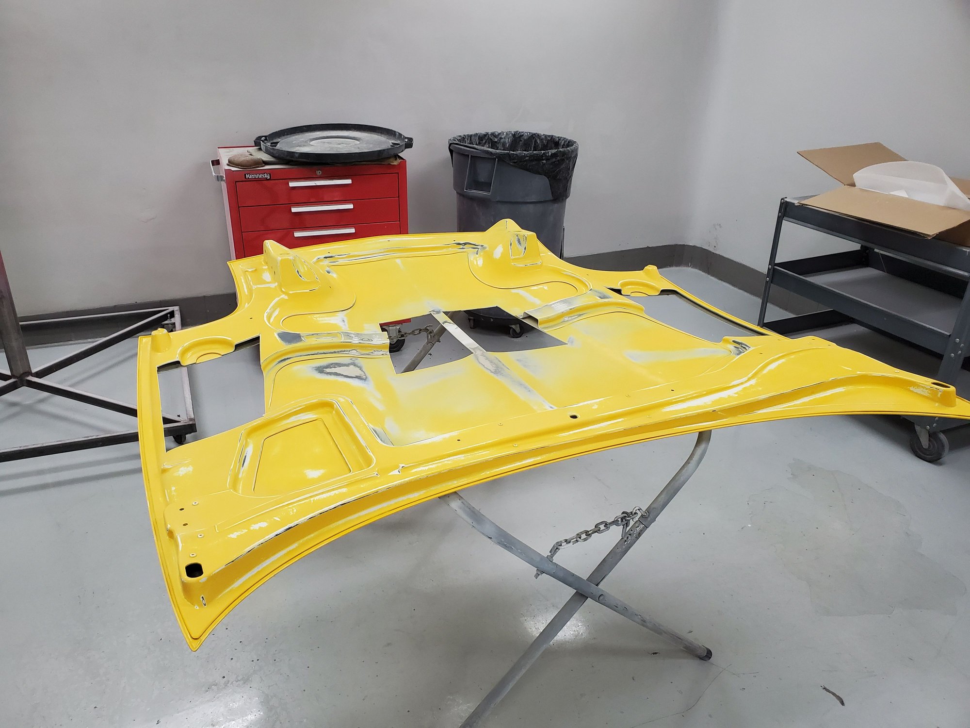

Well no surprise the factory just painted enough so the hood pad would cover the rest. So that needed to be corrected since I won't be using a hood pad.
Old May 25, 2020 | 06:35 PM
Tbair64's Avatar
Tbair64
Joined: Nov 2017
Posts: 443
Likes: 140
Top side is no different. Looks pretty good but not exactly straight as I needs to be. So guide coat was added and blocked straight with 320.

bottom side cleaned up and sealed. Ready for paint.

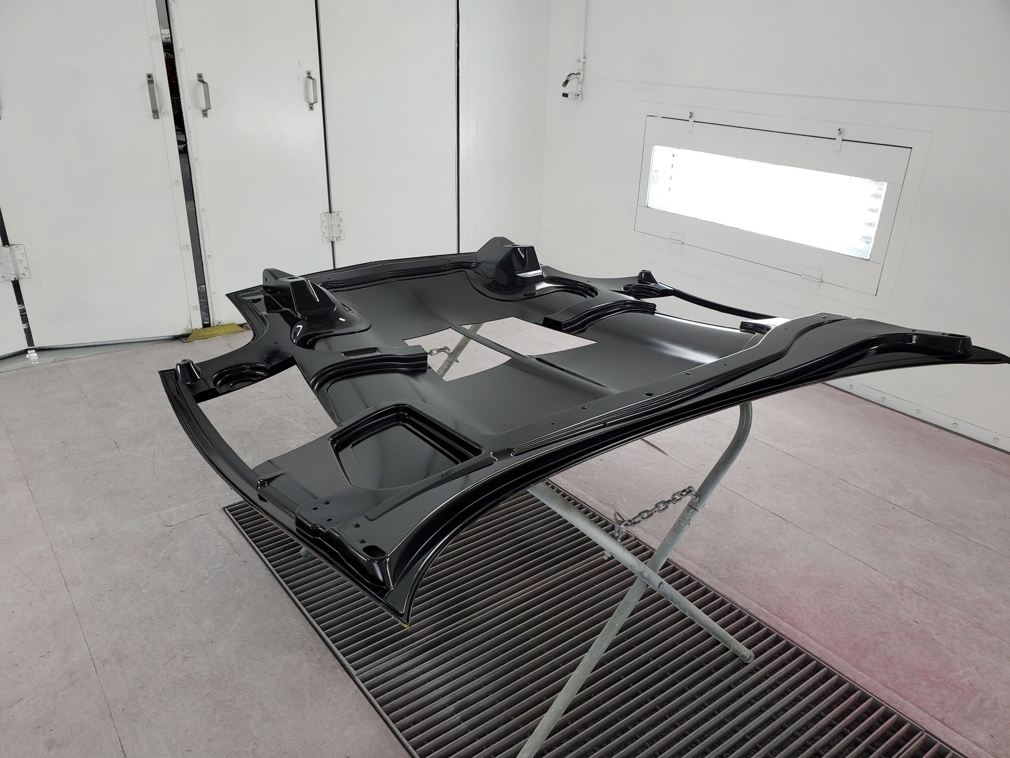

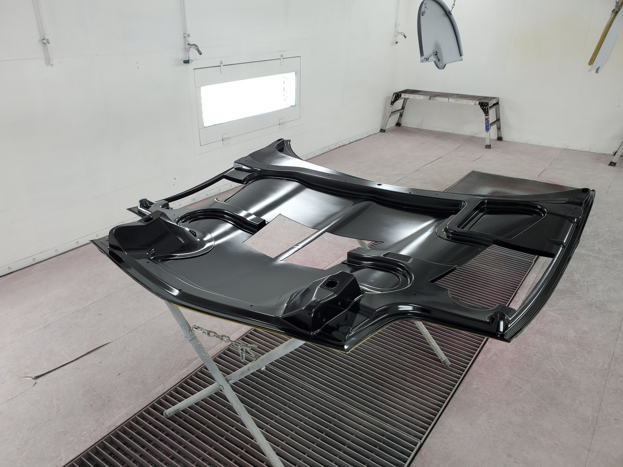

Clear is not completely flashed yet in this picture. But I wanted it to match the rest of the engine compartment. I use black with gold pearl added and a eggshell clear. Like this better than just satin black.

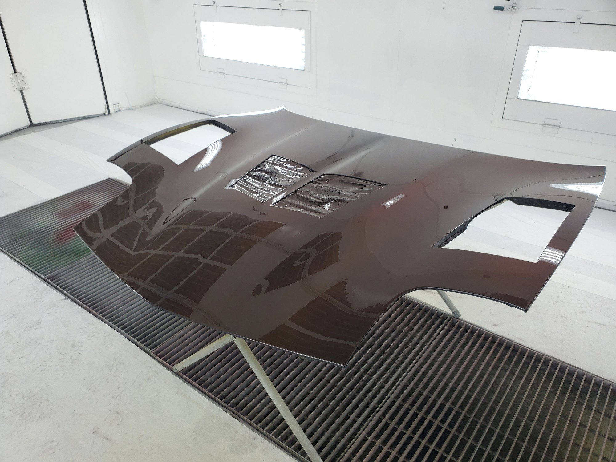

Here is how im going to pull the yellow to black to bronze all together. House if kolor black gold pearl. This will go on the top side of the hood and halo. More to come as i progress.

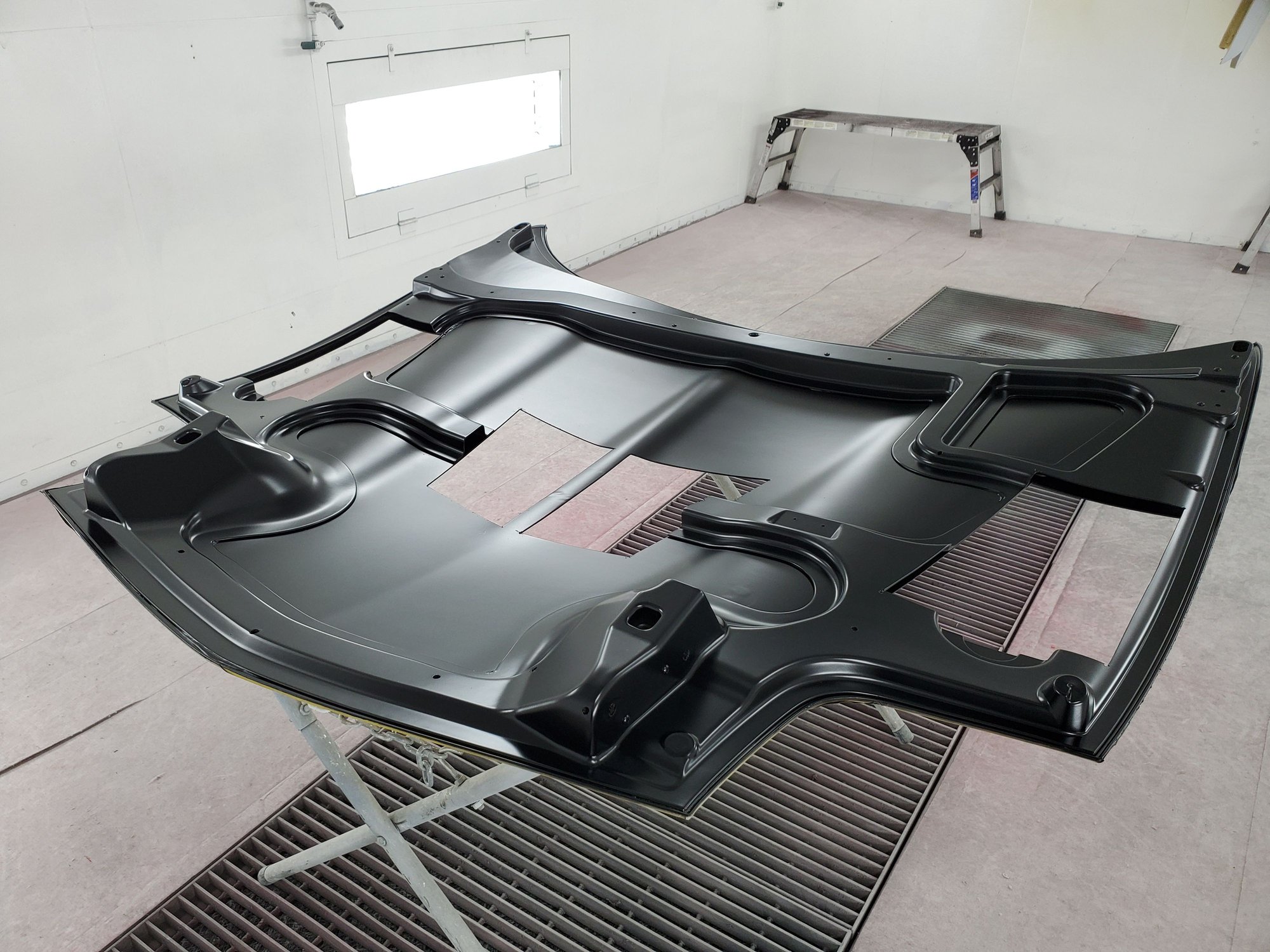

Bottom side has dried to a nice eggshell finish. considering some heat shield inbetween the hood bracing

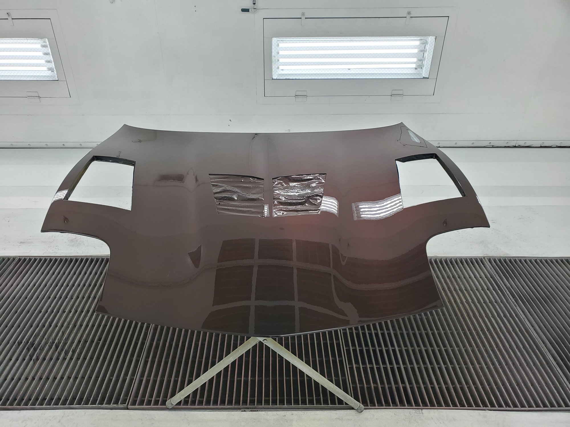

moving right along. Hood is painted. That color really changes from black to bronze as the light hits it. Can't wait to get the coilovers on the car. Just wiaring on the wherls to show up.
