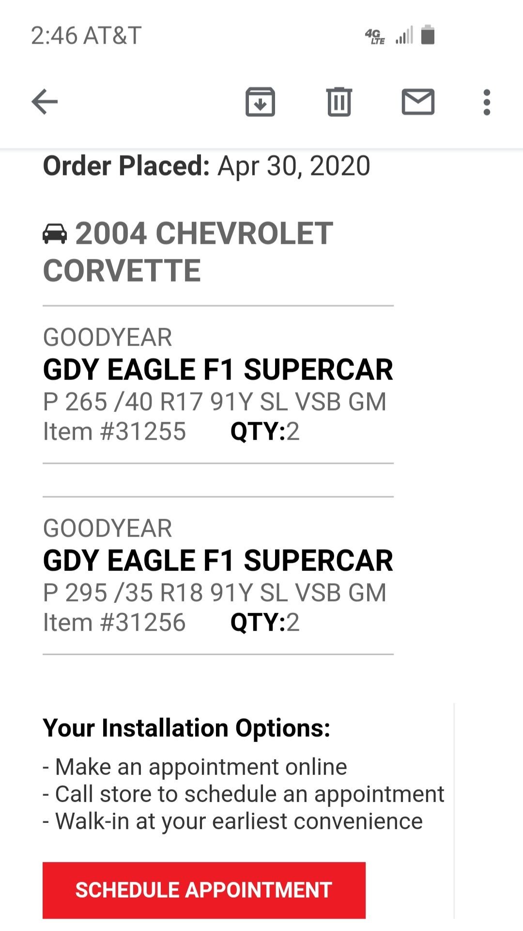

So I read a post on CF last week that Discount Tire has factory sizes available for C5 Z F1s, something that has been hard to come by for some time. I ordered a set last week and received notification today that they've come in. I'll apologize for being a skeptic - why were these out of production for so long? - but now that they're here I'd like to know how to read the date code. Curious how "new" they are! I'll report back and thanks for the insight.

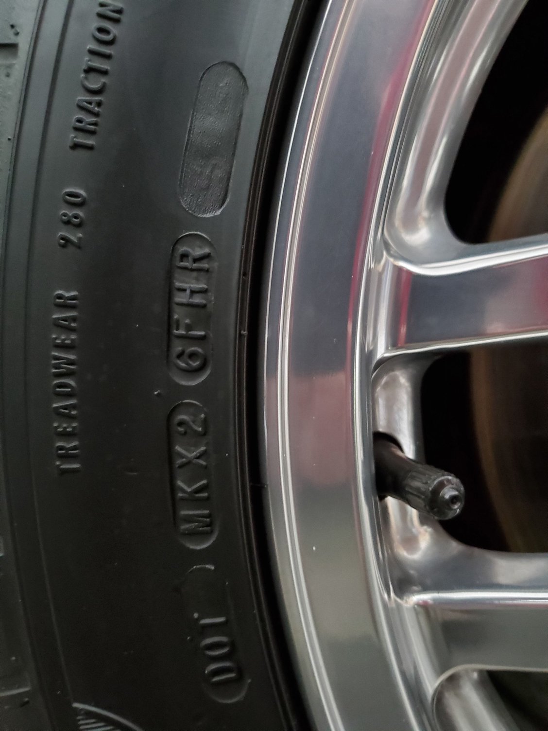

Thanks for the quick reply. I checked the dates on my current tires on the Z, GSD3s, one has the date code missing? I show two tires for comparison.

Its on the other side of the tire. Date codes are on one side or the other

the one tire is the 36th week of 2007

Almost looks like the date code was ground off on that tire that does not have a date code.

Thank you for your support. It looks like you have located the DOT's, however one being from 2007 and the other indeed looks like it has been removed is of concern. We would like to look into this further, PM headed your way.
@DEFCON5
Although its rather unregulated, we will not sell a new tire that is over 4 years old, with the intentions that at 6 years old the petroleum oils inside the rudder has deteriorated enough it would be recommend to be replaced regardless of wear. Which is why 2007 is a bit concerning.
Wow, you guys are on it at Discount Tire. Hold up though...those pictures are from my CURRENT tires, a set of GY GSD3s that I put on the Z16 in 2007. My question on CF was to understand how to know the manufacturing date on the NEW GYF1s (which have been unavailable for years) that I'm having installed tomorrow. I'll keep everyone posted. Again, good customer service there Discount Tire!

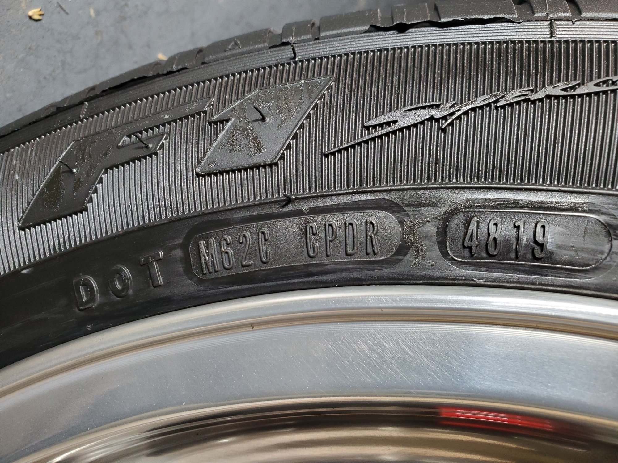

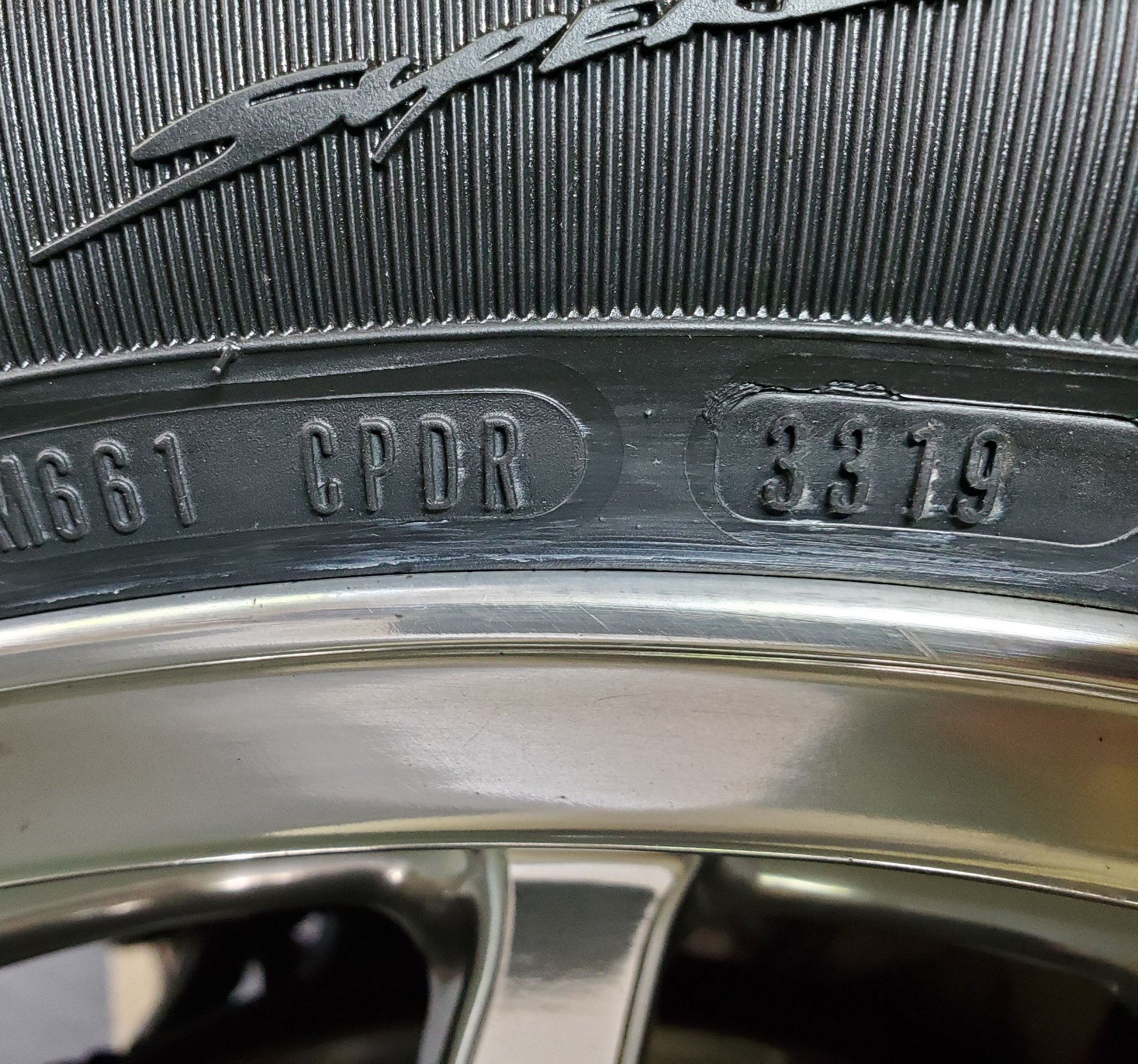

All good with new shoes for Z06/Z16 #165. The tires were made in 2019, fronts mid August and rears late November. Discount Tire took great care of me too. Now to put some miles on these new shoes!
