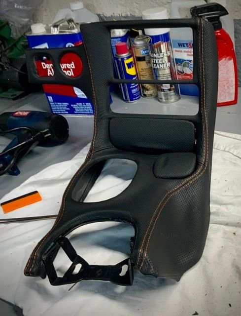

Tusc, as you can see I ordered perforated leather to go with the rest of my trim. It was very pliable, forgiving and stretchable. the stitching is quite nice. My pic below will show what I’m about to describe. My initial instinct was to do the concave (Ashtray) area first and work my way out from there. I consulted with the vendor and they said there were a number of approaches. Because I did not want any of the orange stitching to be obstructed by my shift boot or cupholder door, I started from the left, moved right and then tried to deal with the concave. That resulted in some misalignment and bunching in the concave area. I had to pull some of what I had done, but should have been more disciplined like I’ve seen Cechaflo do with his very gradual gluing procedures. I thought I had it licked, and had the left side where I wanted and found bunching again. As I was applying the area around the keyhole and air sensor I got worried that I would not have enough material to wrap around. Turns out that was not the case, but it ended up skewing the stitching more to the left than I anticipated. At that point, I ended up cutting the concave area at the left side of the right seam. That solved that problem, but then, as I slowly attached the leather to the thin cross pieces, I didn’t pull it enough to have the right stitches line up as I wanted, but some of the previous sections were over a day of glue curing and I didn’t want to rip the leather. Barge glue holds that well. The other reason I didn’t stretch the center section was because I wanted enough flex for the 8 inside corners, which I’ve dealt with 8 times previously. I knew what was coming. It was then that I watched Cechaflo’s knee panel install and those corners all went well.
Hope I didn’t write too much and I HATE “admitting’ that the final result was not as good as I hoped, but I would gladly use this product again. The mistakes were mine, and if I did it again, I would go with MUCH smaller glue sections, and I would do the concave section first. The product itself was the nicest leather I’ve ever worked with.

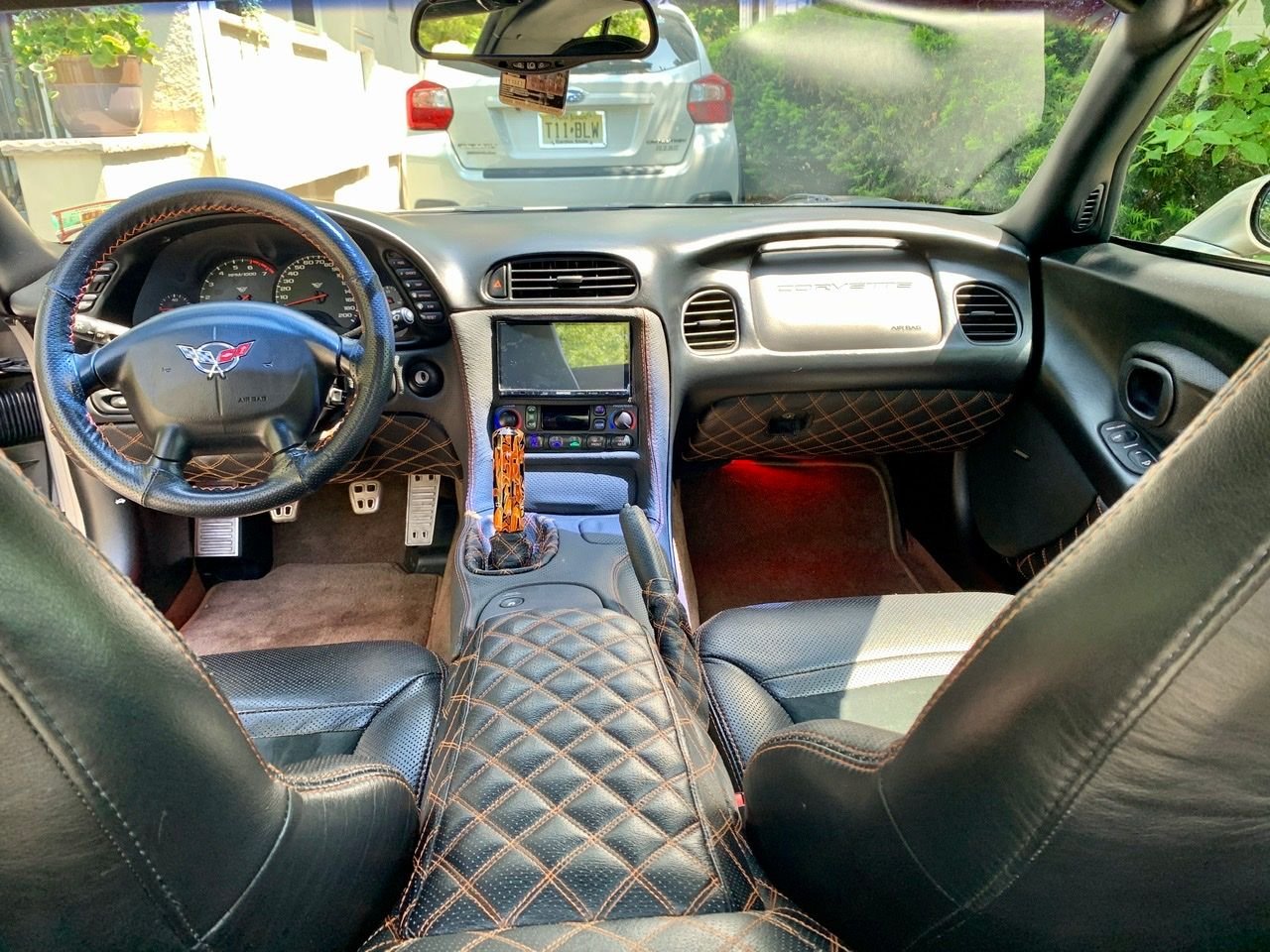

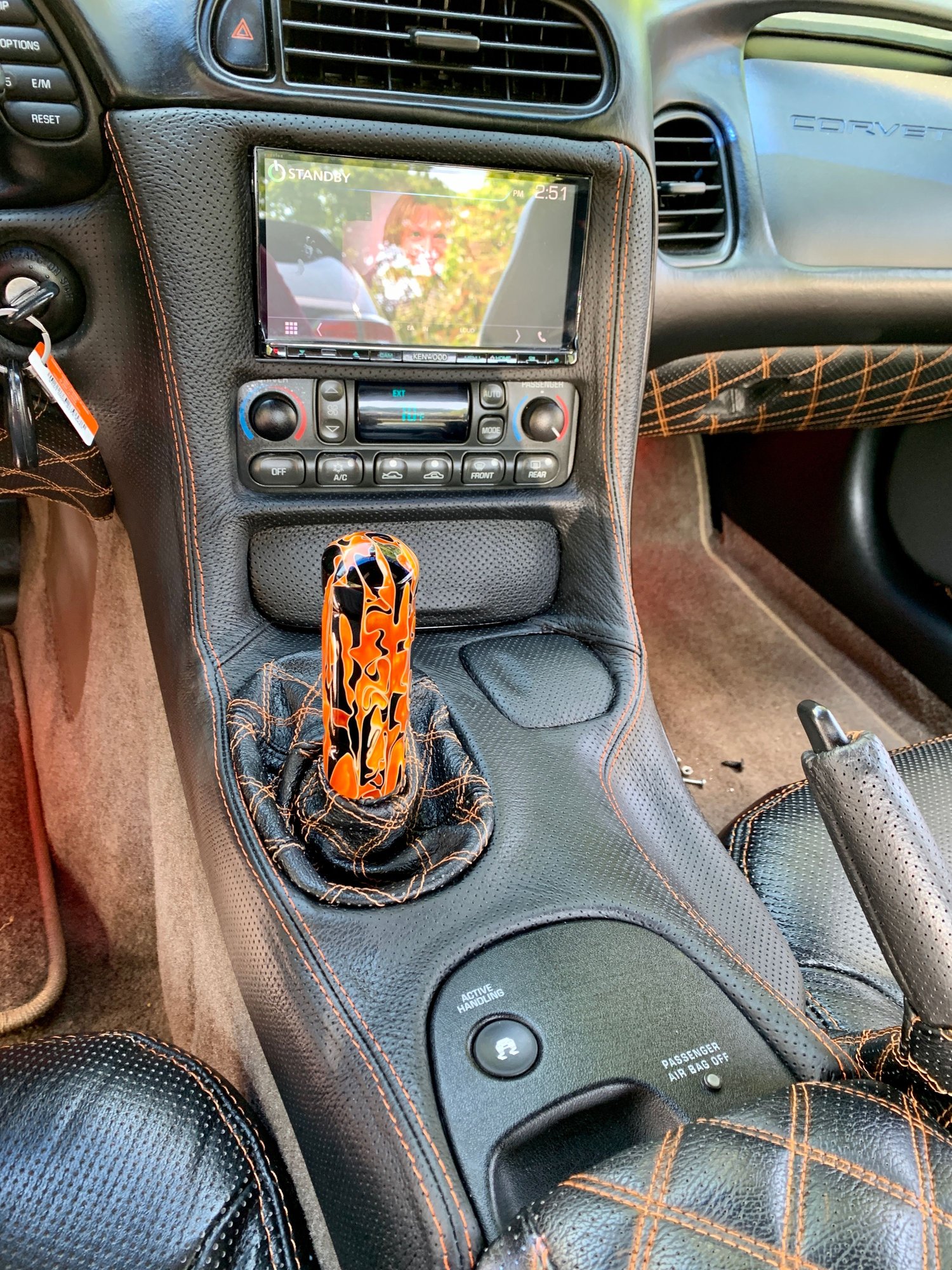

Finally finished, made adjustments to allow the radio tilt feature to work.
