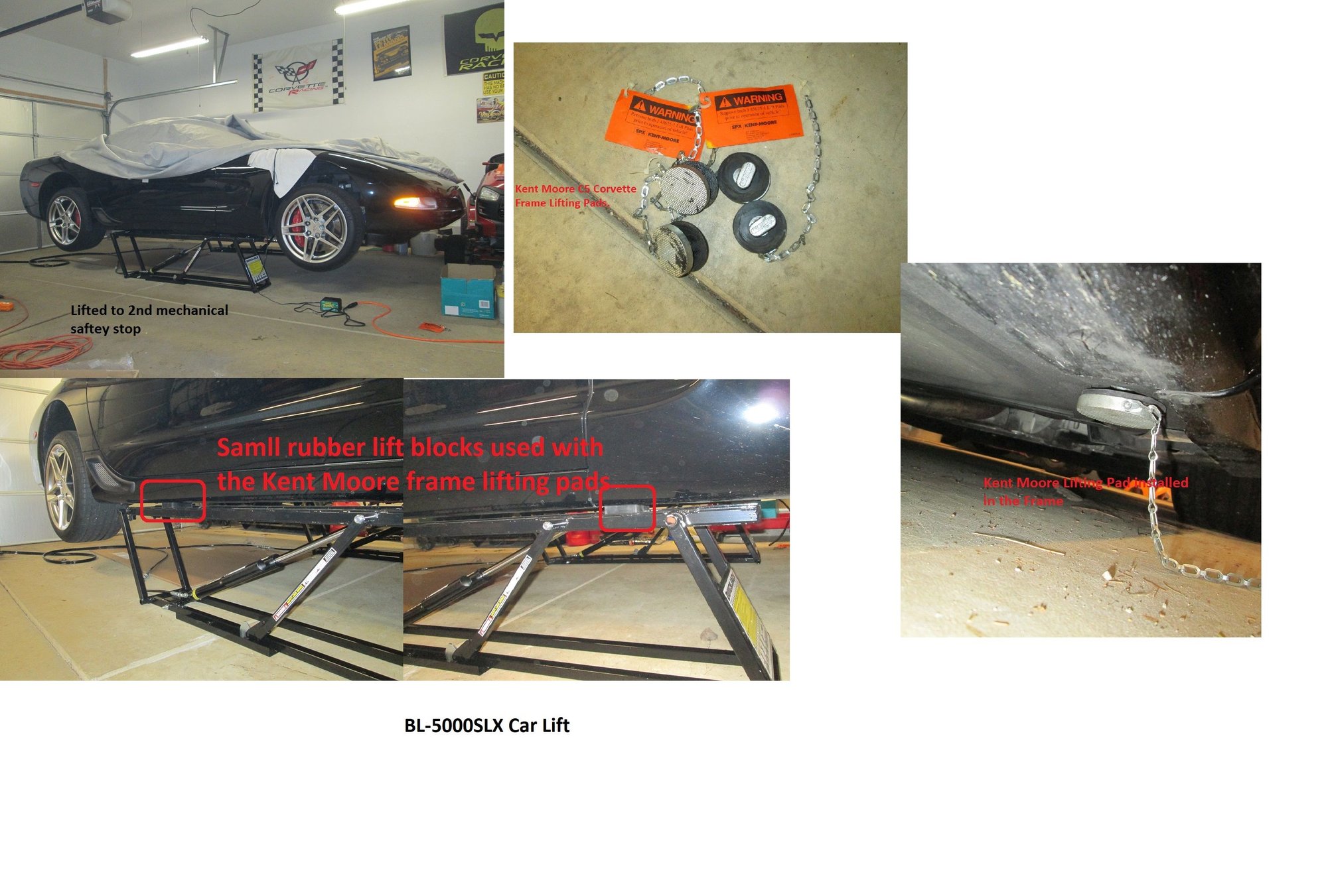

I have 18 inch wheels on all four corners and with the kent moore lifting pads, I use the 2 inch rubber blocks.
