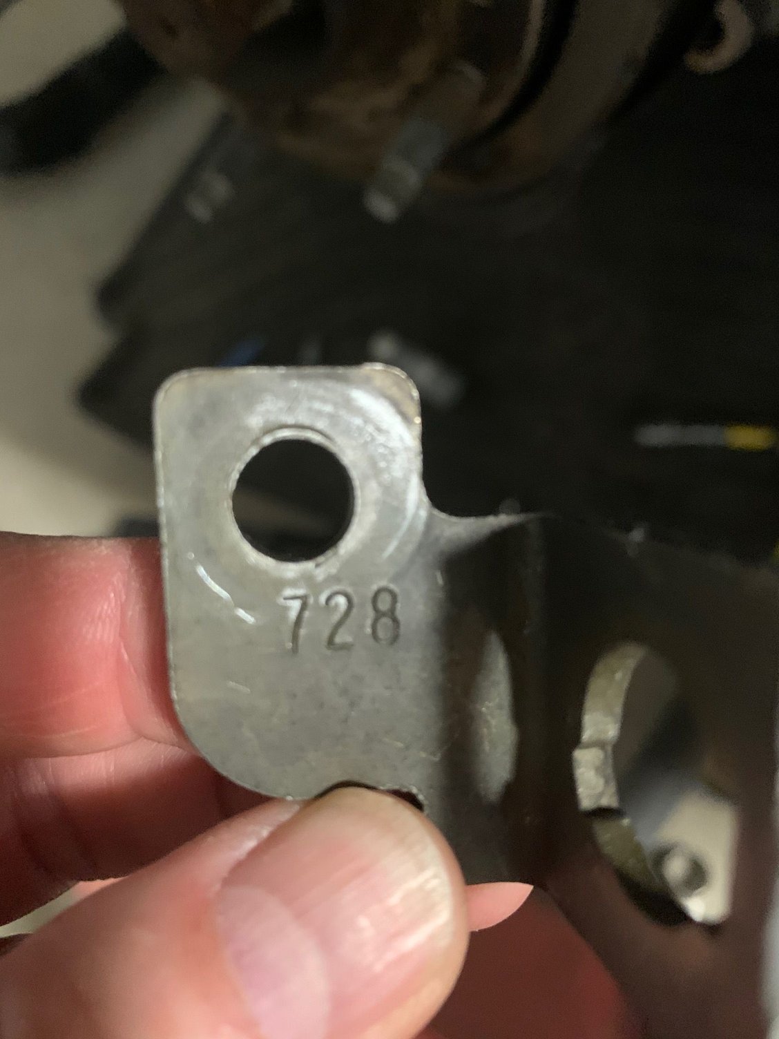

I am putting in Doug Rippie stainless steel brake lines and the stainless pistons in my 2002 C5 base model. I took all the lines off and the brackets that hold them to the frame. I failed to mark which brackets go on which corner. Now when installing I am confused which brake line bracket to use on each corner. Two are stamped "396". Two are stamped "728". These are factory brake line brackets. Can anyone tell me what goes on each corner?

After much trial and error I am pretty sure the “728” brackets go in front corners. The “396” brackets go in the rear corners.

Glad you were able to sort it out.
I never paid attention to their being two different brackets. I did find a small photo of an aftermarket vendor's brake system and they showed the same bracket number for front and rear so that did not help.
As you probably discovered, if there was much of a difference between the two brackets it would almost certainly show up when you test fitted each style bracket to one of the corners.
