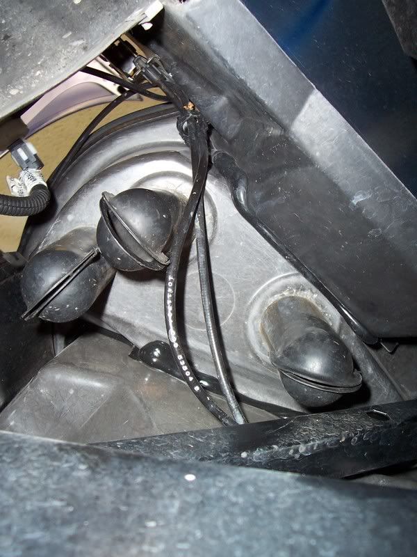

Here are the udders on the driver's side:

Laurent, thanks, is that looking from the top down or from the bottom of the car up? Dave

That is looking from bottom-up.
