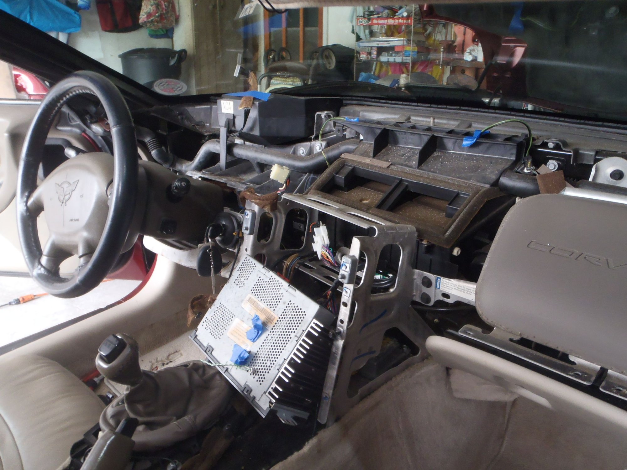

My Anniversary Edition convertible was neglected before I bought it, and lots of little things needed attention. I waited a year before fixing the HUD. Here's a picture of what I had to go through to fix the broken hinge pin that RW03Vette spoke of.
(Glad your solution was so easy!
