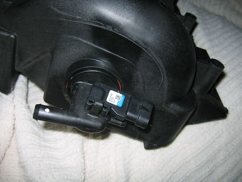

Here is a picture of the rear of the manifold with the piece that is broken.
One vacuum line goes to the brake booster and the other supplies the HVAC vacuum supply.
All depends on whats broke and where it is broken as whether I would try and repair it.
