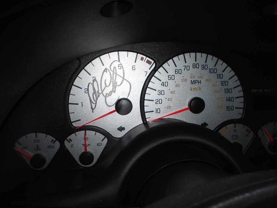

The Dale Earnhardt car will be worth some serious coin.
Pics from my past.
FYI he only signed less than 30 of the tachs. That wasn’t the plan. He died before all were signed.
