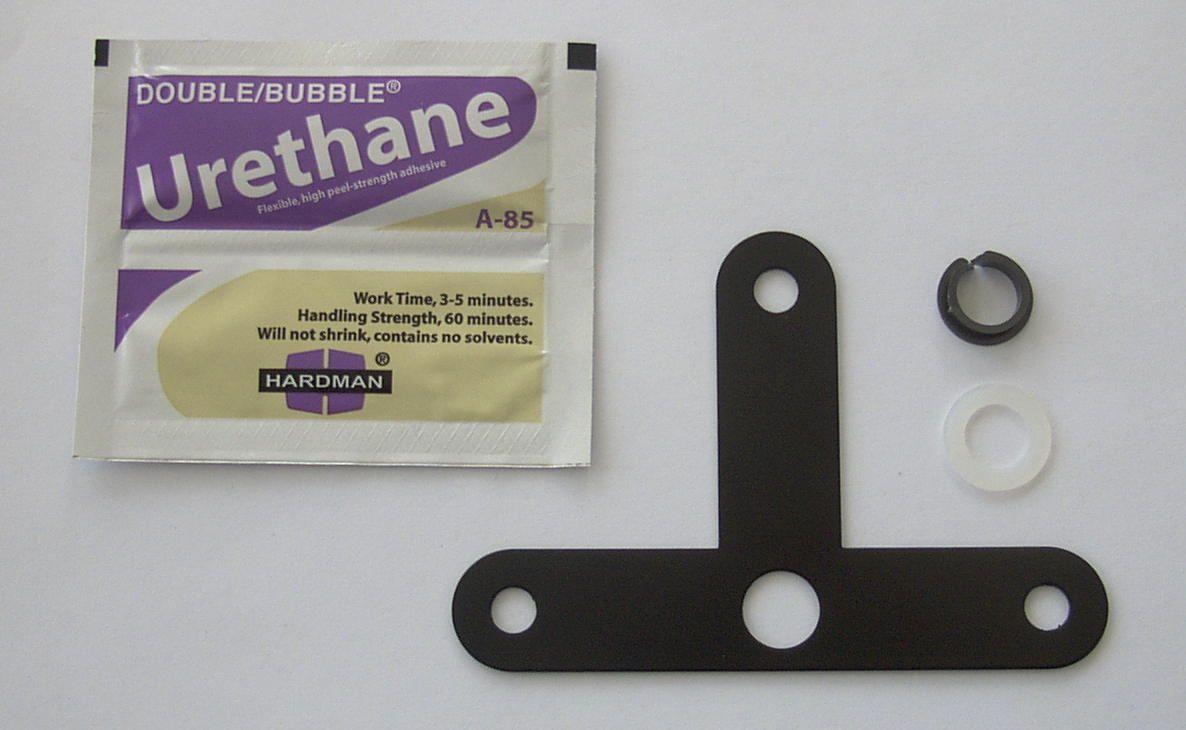

Definitely not all repair kits are the same, and that needs to be taken into account to minimize frustration
You can get plastic, aluminum or brass replacement gears. Gears can be solid or shaped like the OEM to accept the rubber damper that interfaces with the output shaft. Some kits just include a gear and a pouch of glue, while others go well beyond that to assure a successful repair.
​​​​​​​Plastic and rubber degrade with age and heat. Some people just rotate the motor's gearbox output shaft 180° to use the undamaged section of the plastic gear, but it's important to understand that YMMV... don't expect another 20 years
Considering the way the headlight doors work (hard stops both ways, opening and closing), I like better the gear design that keeps the internal rubber damper. A good kit should include a new one.
​​​​​​​Another important component is the steel T-brace with plastic bushing. It is designed to take away the forces (especially when hitting hard the travel ends) from the gearbox plastic cover. Without it, the glue will likely fail.
IMO, Rodney Dickman's kits are the most complete and well thought out sets available.

If yours is a 97 to early 2000, then your motors should have an aluminum gearbox with a removable cover held in place by 3 little screws, therefore you basically could get away with anything.
On the other hand, if you have a late 2000 to 04 with a plastic gearbox and glued cover, and you didn't install a T-Brace with plastic bushing to reinforce the motor after glueing back the cover, then is not a matter of "if" but "when", the glue will fail.
As mentioned above, this is fundamental. It is designed to take away the forces from the gearbox plastic cover, especially each time the motor reaches its travel ends (which are hit very hard).
It can be separately bought, including glue, for $7. Take a look a this for more details.
