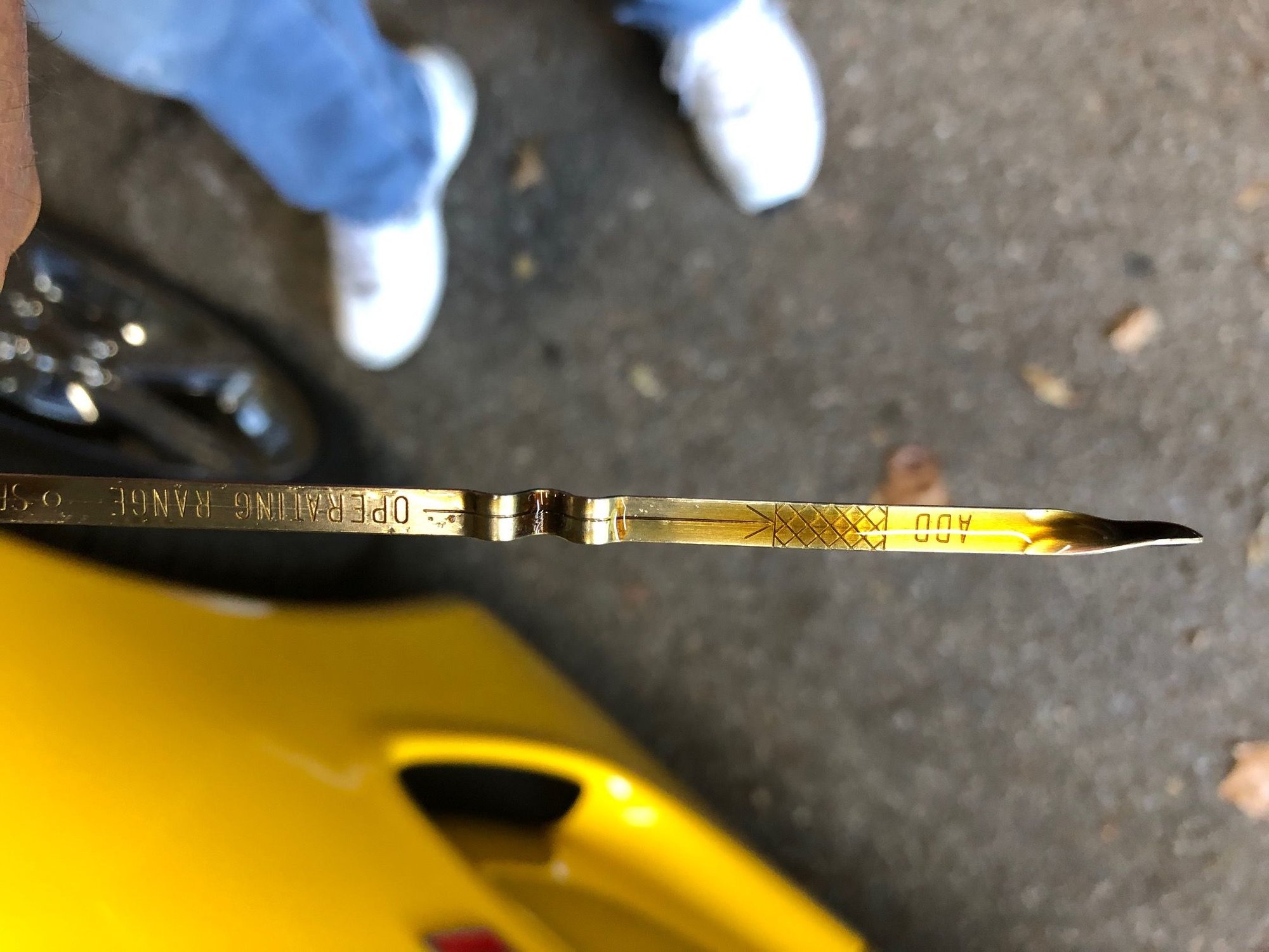

I changed oil last in my 2000 Corvette Thursday before leaving for OH Friday morning. I raised the back up so I would completely drain the old oil out.There were over 5 quarts of old oil drained out. I put 6 quarts of oil (including filter change) back in. Checked the level and it seemed okay. Got back after 1000+ mile trip. Cleaned up the car last night and rechecked the oil. It appears to be over full. I hate to drain any out because that would mean less than 6 quarts. I also read that with a filter change it should actually be 6.5 quarts. Any one else have this issue? And yes, those are New Balance tennis shoes.

When I changed my oil last month I put 7 quarts of oil in and a new filter (filled with oil). I ended up with 1/2 quart over fill and that is where I usually keep my oil level. Since I usually autocross and HPDE, as well as running on the street, I check my oil every time before I start the car. However, when I drain the oil, I leave it draining a good 1/2 or more after I remove the plug.

Every time I get an oil change, I end up with it above the full line and on the "S" bumps whether I check it cold / hot / etc. My knee-jerk reaction is "you're a GM dealership and/or a Corvette specialty shop, how are you getting this wrong" but then I take a step back and read about the 6 vs 7 quart debate, the dipstick change, etc. I realize that 7 quarts is where it would be set for competitve driving, so I try to not think about it too much, although it's me, so that's what I do. I think you're fine.

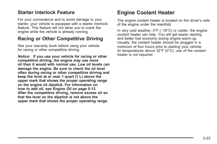

I see many posts about running 7 quarts - is there some science behind this? I do occasionally track so am interested. I'm guessing that 1/2qt over doesn't get it to the level of the crank throw....
https://community.cartalk.com/t/over...enario/53642/4

It's specified in your manual to fill with an extra quart for track use.
