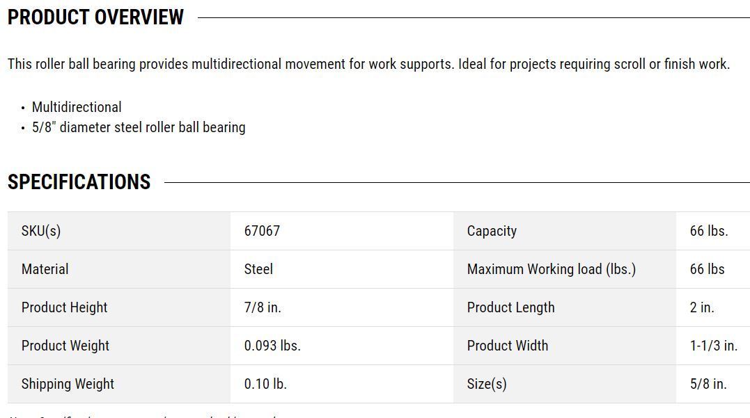

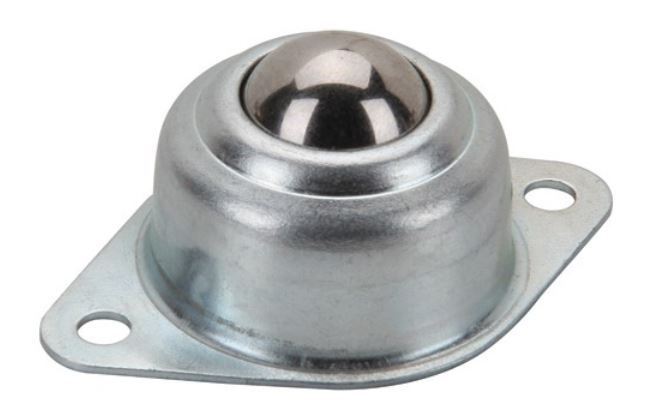

During the course of my searches earlier, I saw these low profile roller ball casters in 2 sizes from Harbor Freight. The 5/8" sell for 1.09 each. The 1" for $1.99 each. I'll have to visit my local Harbor Freight and look at these in person. These lower profile caster may make it easier to strategically mount them onto the support areas that lift off the ground when the lifts are raised. I'll just have to carefully think where and how to attach them.

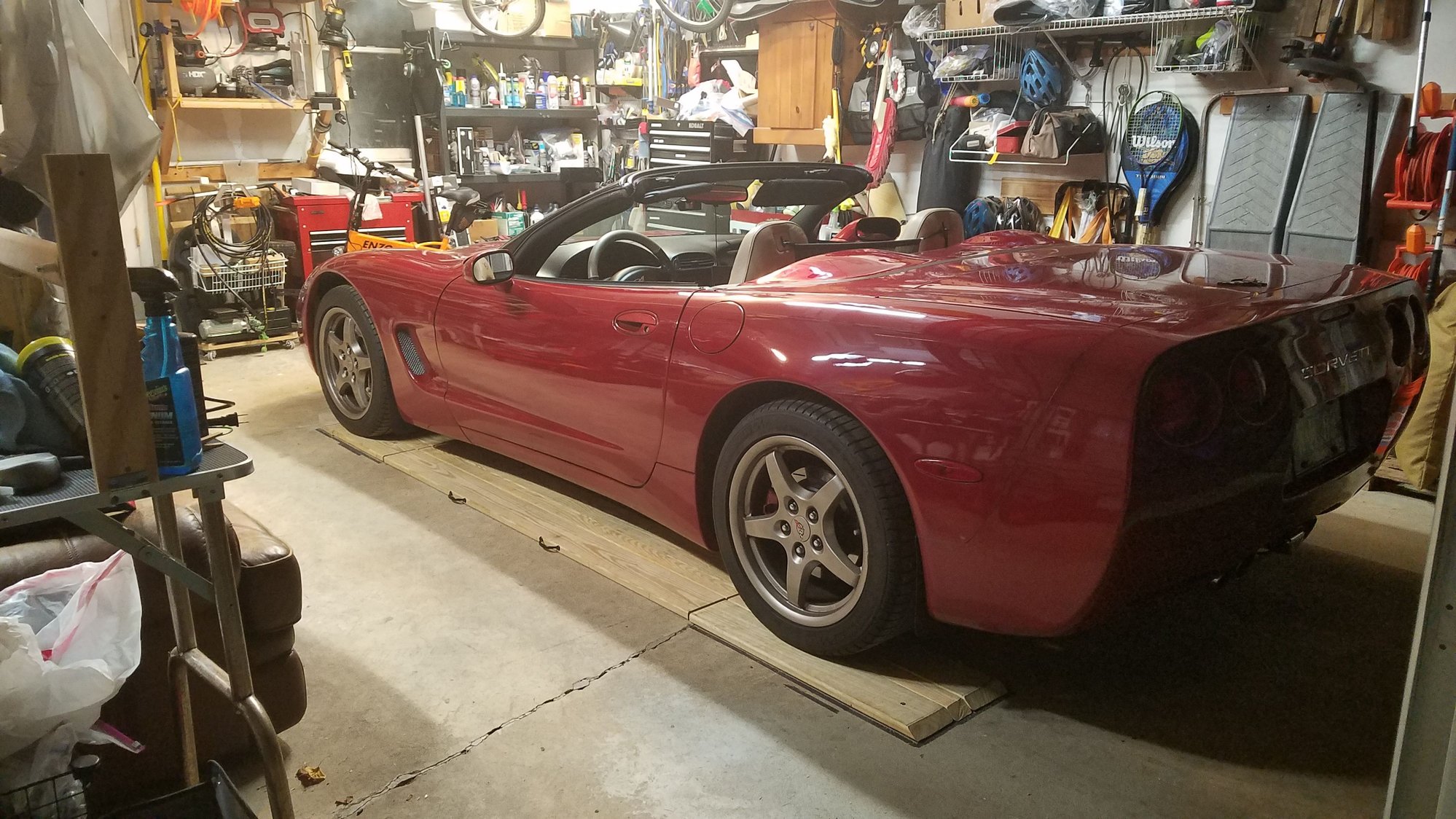

I use small 3-wheel dollies on either end of each jack to make it easy to slide in and out, but they are removed and set aside for lifting. These raised the jacks just enough when they are collapsed that the car didn't quite clear them when pulling in and out. So I put in a ramp system to increase the clearance. My car is not lowered - too many speedbumps through my neighborhood and the entrance to my driveway is okay at regular height but would be problematic if lowered.
When I want to use the jacks, I pull the center sections of the ramps out and set aside, roll the jacks out, pull the dollies out from each end and set aside, and I am ready for lifting. The ramps are just decking boards (5/4 inches, IIRC). They stay in place with stainless steel bolts through the boards and that fit into holes hammer drilled into the floor. This way I can remove the front and rear sections of the ramp system once the car is in the air if they are in the way of whatever work I am doing.
I've had this set up for a couple of years and it works well - makes it much easier to slide them in and out when I need them. My concrete garage floor is just rough enough that they were difficult to slide easily before setting up this system.
