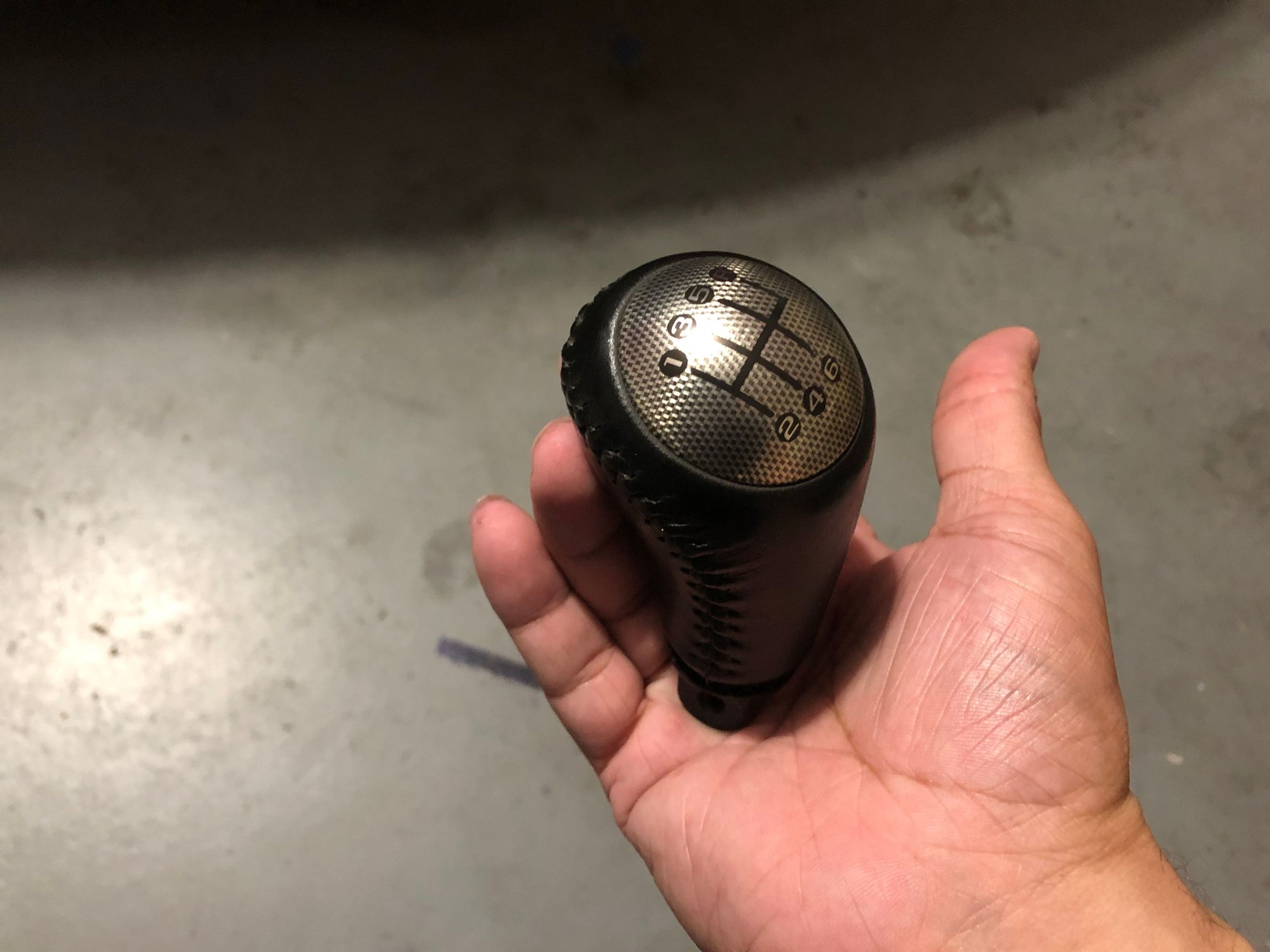

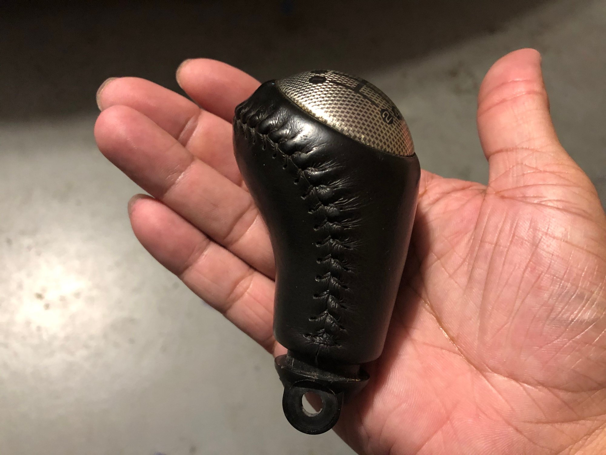

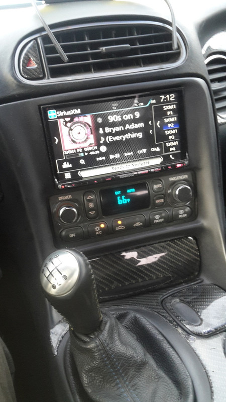

  • C6 Shifter
  • C6 Carbon Edition Blue Stitch ****
  • C6 Carbon Edition Blue Stitch Boot
I didn't modify anything on the car to do this. It doesn't fit the hole 100%, but it's very very close. My C5 plastic boot trim ring was broken, so I couldn't reuse it for the C6 boot, but it fit pretty perfect as is, despite the fact the C6 is longer and narrower than the C5.
I bought mine new from GM and the difference in the shift quality is impressive. I attribute a lot of it to the new bushings in the lower shifter box.
I'm still on the hunt for a 2009-2013 stock shift boot to match with my 60th Anniversary Edition spare ****. I cannot find one to save my life and cannot find the stupid part number for the stock boot either on GM's site because it's impossible to navigate, but that's a story for another day.
